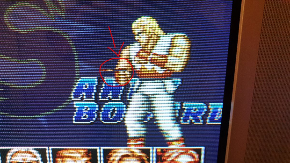

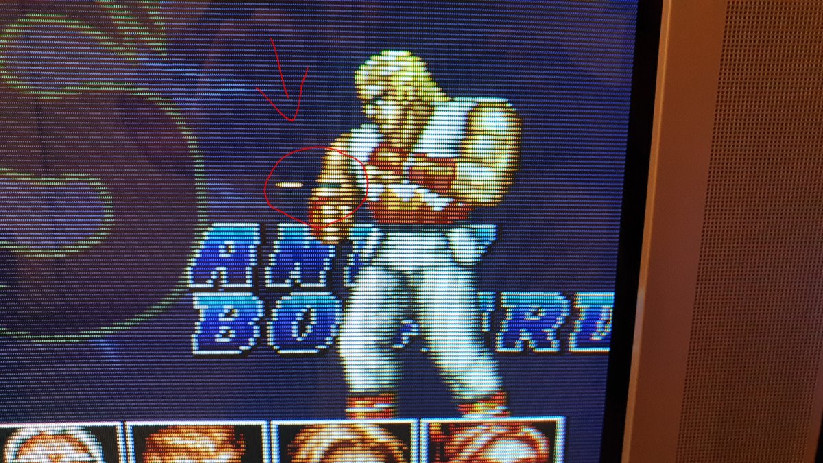

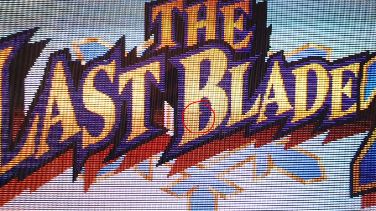

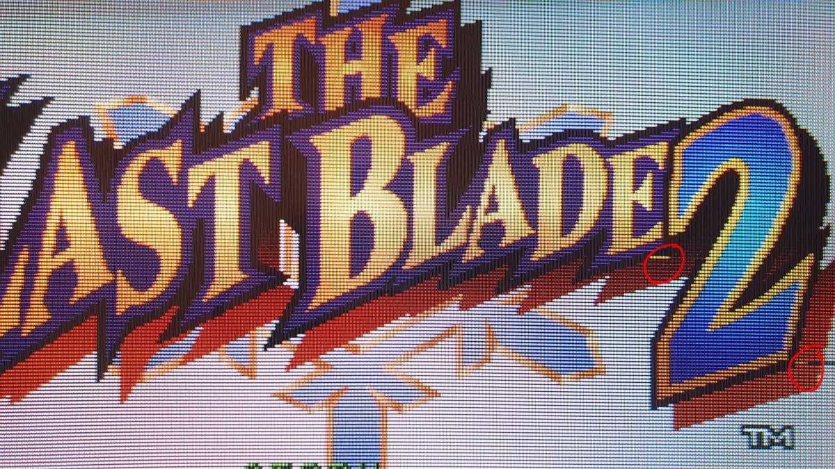

I've also noticed I have tiny horizontal lines blinking sporadically in some games.
One that is showing this consistently is Last Blade 2 on the start screen.
No issues at all when using my Fatal Fury Special original cart (the only one I have).
My setup: Jap AES with Unibios 4.0 and a 5VDC 4A Otaku's Store PSU. 16GB Sandisk Ultra Plus with Smokemonster latest rom pack. Latest firmware and menu installed.
xaviersaverio
Jan 6, 2021
9
3
France
I've performed further tests to try narrow down the issue.
Fatal Fury Special sets 1 & 2 on Multi AES display these tiny blinking horizontal lines most of the times while my original AES cart never does.
So it is now pretty obvious that the problem comes from the Multi AES and not from my setup.
Darksoft
Staff member
Immortal
Jun 12, 2015
9,229
10,793
Poland
Yes, this is clear that the problem comes from the cart. It depends on the model that you have. In most it doesn't happen at all in some it happens in some games. the trouble is in the TOP file. We'll try to release an optimized one anytime soon.
