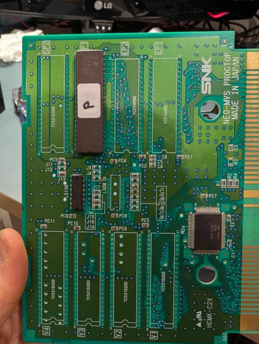

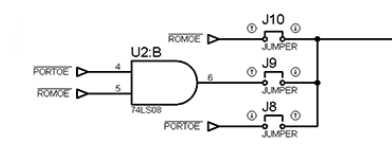

found the problem, i'm using J9 instead of j10 on progbk1. ||
i dont know how its work on m1vc but not on mv1fz since j9 is from ls08
27c160 as C & V
27c800 as P or double it and use 27c160
27c1001 as M1
and 27c1000 as S1
you can use 27c1001 also on S1 but you have to invert pin 2 and pin 24

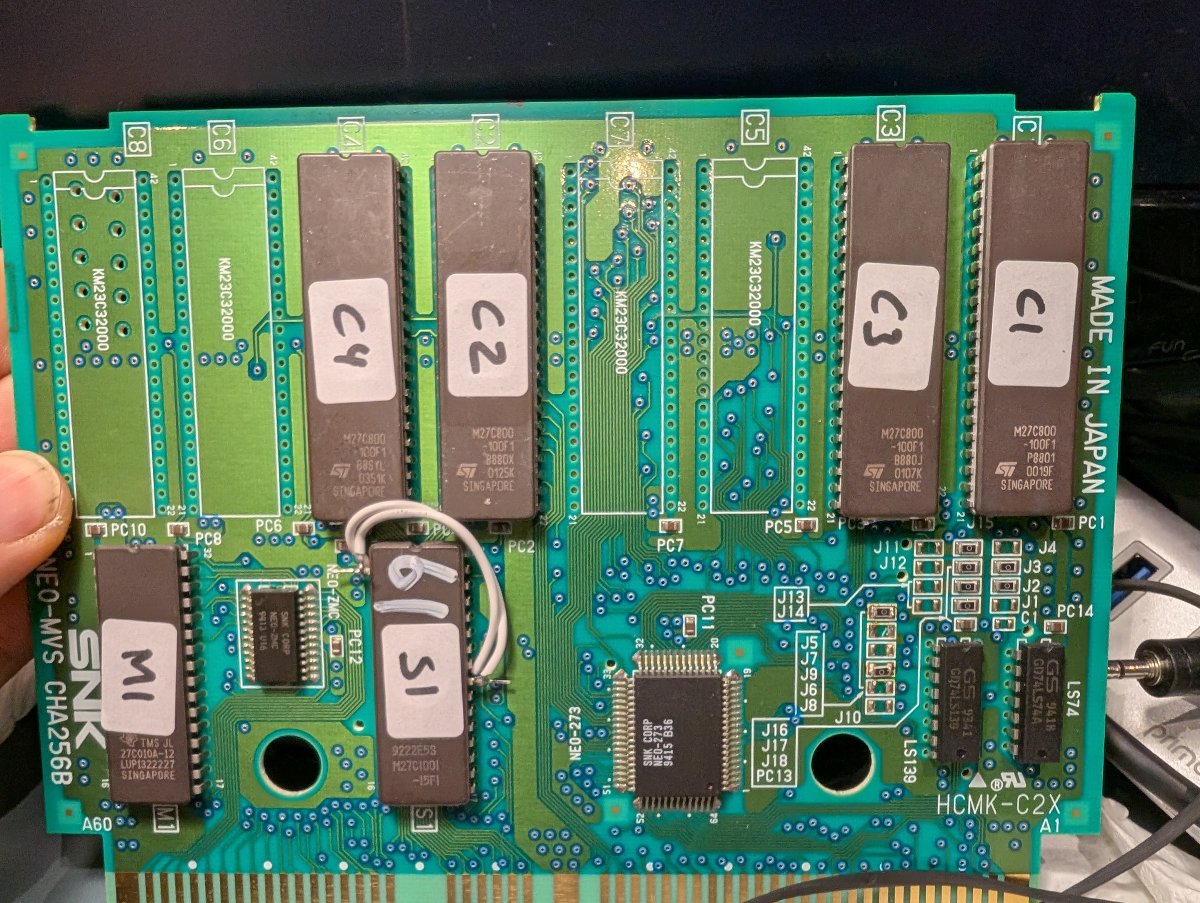

V1 pin 28 ring came off while I was removing the original ROMS. I expose the copper on the trace and patched a small piece of wire from the pin to the newly exposed trace.
I have the same thing happen to a pin on V1 on Shinobi and patched the same way. It came out better on Shinobi but it's not as bad as the image appears.
Any thoughts?

if Golden Axe just goes straight to the crosshatch -> go check your P1 eprom.
1) desolder it and try to dump to check.
2) on progtop for 2MB V rom and 2MB P1 rom is ok = J1 + J9 + J13 and J17+J16
Again, if game do not boot, check your P eprom... ( and its trace )
Are you sure that S1 pins exposed on back prob board do not short on it ? cover it !
Have you washed prog pin with alcohol?
If you get critical error during game play, check neo-273 on CHA, sometimes need to be clean also with al alcohol.

You can split the c-roms and use 4x 27c800 instead if you don't have enough 27c160s (my case).
C1 becomes C1 and C3, and C2 becomes C2 and C4.
This is what I've done since I'm still waiting for the 27c160 eproms to arrive
For prom, I' used 27c800, for m1 27c010 and for s1 27c1001 with pins 2 and 24 swap.
I've used a supersidekicks 2 board, with progtop an cha256b boards.
All eproms on the boards, except the V roms (waiting for the 27c160s). I'm assuming I won't get music but still be able to play.

Well, the solution seems now easy enough. J9 in PROGTOP is not the one, it shall be J10.
I confirm this in case it's useful to someone.
I used 27c800 por P1.
The cart is working fine (except that no music obviously because I have pending soldering the V roms)
