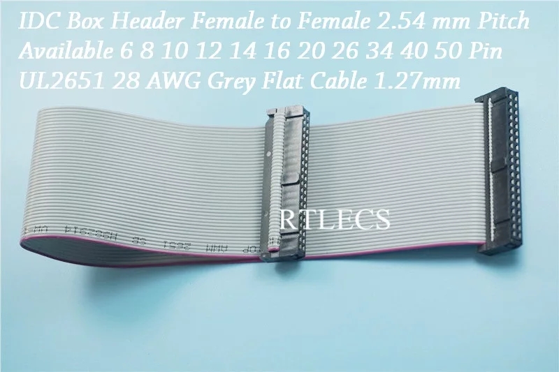

Two PCBs, one with the male jamma finger to insert into a jamma connector, the other identical but with a soldered on jamma edge connector.
Each pcb has 2 x connectors, a larger one for everything but power, a smaller 6/8 pin one for power.
Whatever we use has to have cheap and readily available pre-assembled cables (no crimping yay) with matching PCB mount connectors.
I'd happily design the PCB and share the files for people to produce their own adapters.
Use your imagination, but this is what I'm currently thinking.
50 pin IDC cable and 8 pin PCI cable.
I thought about that exact setup yesterday but my thought was the audio cable should be at least insulated and isolated.
Same for the 28 awg seems thin compared to jamma standard. What do you think ?
