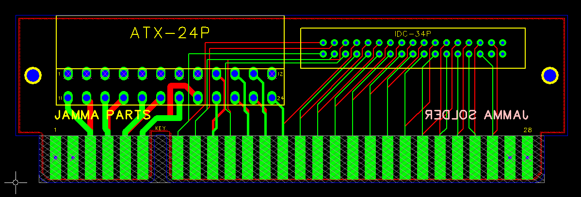

I got a start on the PCB. There will be two separate PCBs, one with a jamma finger and the other with a jamma edge connector. Both will have female 24 pin ATX and 34 pin IDC connectors which will allow them to be connected via a 24 pin ATX extension cable and 34 pin IDC ribbon cable.

Well I've finished the jamma finger board. The jamma edge board is basically the same but with a slightly different edge to accommodate soldering on a jamma edge connector and connections reversed to match.
good job, I still think ATX 24 pins is overkill, maybe you can reduce to 20 pins connector.
I would also give a chance to a smaller footprint design lwith only IDC 50 + Molex and test the results, I bet they would work the same for short range
Well using 24p ATX I had 1 pin free so I used it as extra ground point. I've used a large ground plane so no troubles there and ample pins for the other power rails with 50mil traces.
Problem with 20 pin is pre-made harnesses aren't as common and I'm happy utilising all power, video and audio over the better quality wiring an ATX cable contains.
I'm not adding anything extra like voltmeter etc, just keeping it simple and functional.
The PCB is 38mm high so quite compact and there's two 3mm holes for feet.
It should work well.
I'm not looking at profiting from this and will happily release the files for people to order their own. Compoment count is quite small, 2 x angled 24 pin ATX connectors, 2 x angled 34 pin IDC connectors, 1 x jamma edge and then the wire harnesses which can be purchased pre-assembled.

The only doubt I still have is this ATX 24pins, this bugger is pain in the ass because it puts a lot of strain on solders when things move. The cable has a lot of resistance / wieght that can press/lift the pcb on both sides.
This thing is designed to move often si it has to be durable and avoid accidental solder breaking.
I still don't believe at 100% for 30cm we need this bulky connector except for power.
The less you can have to deal with thick cable connectors the more durable the design can be.
Only tests can prove anyway.
