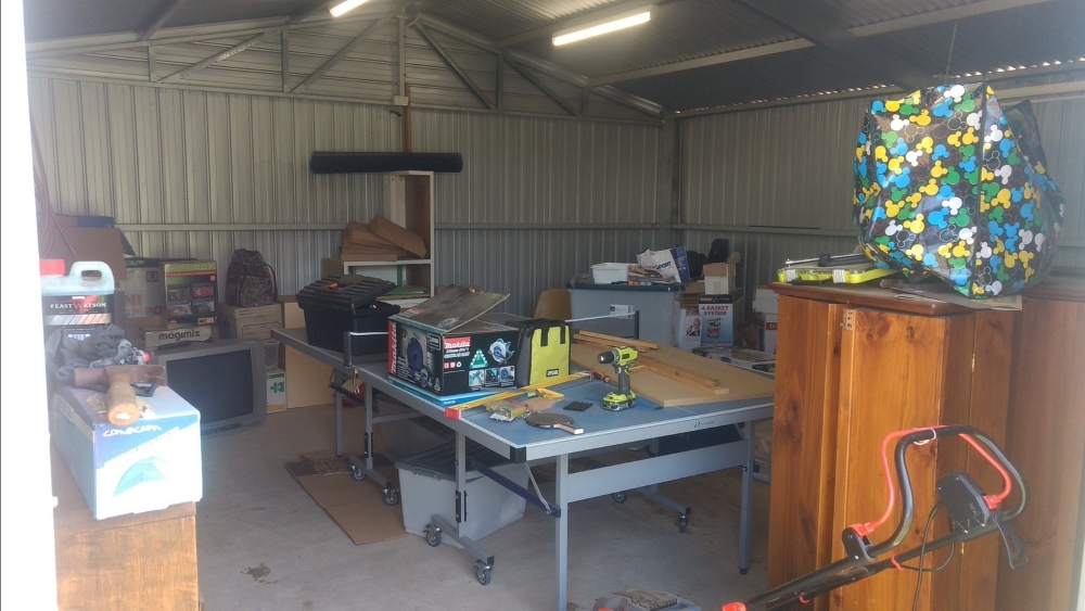

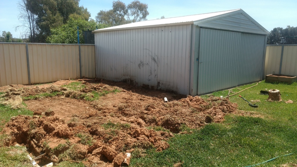

Long term project: Most of the stuff not related to games in the shed will be moving into the future shed. Concrete is going down next week on the new shed. Next year I'll be getting a builder to insulate, replace the door and get an air conditioner installed. Then it's time to move in :)
