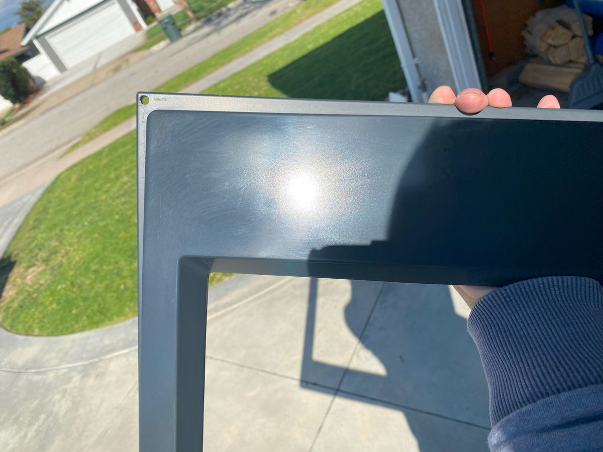

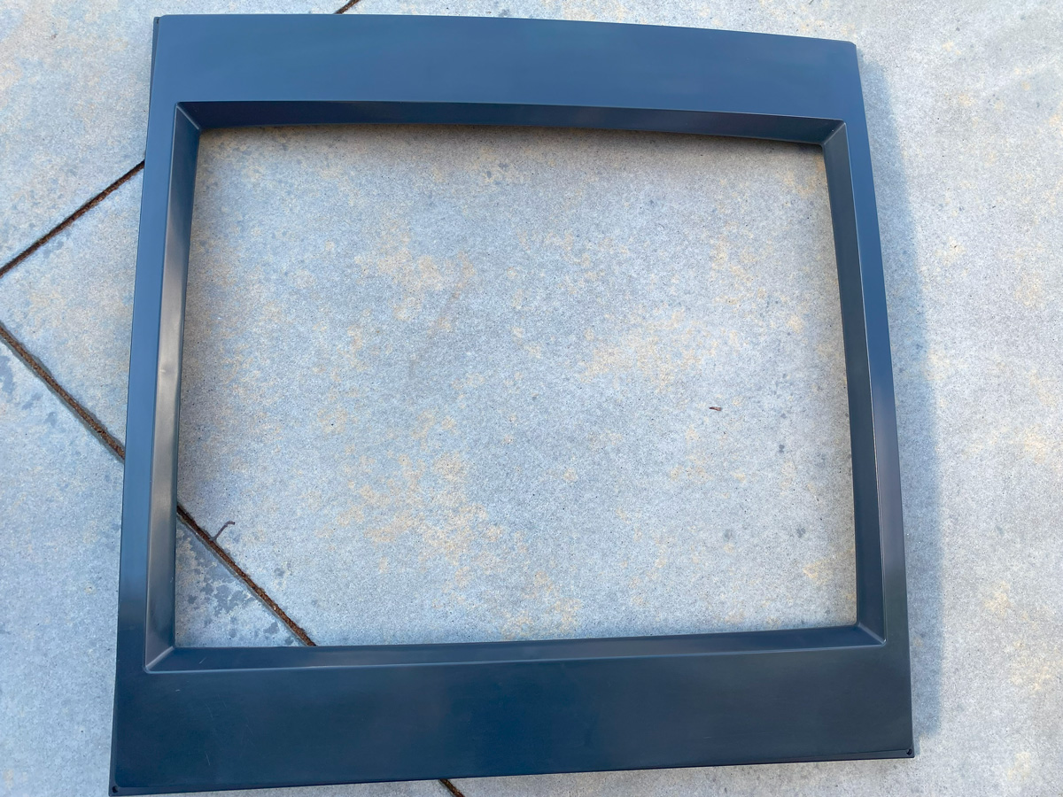

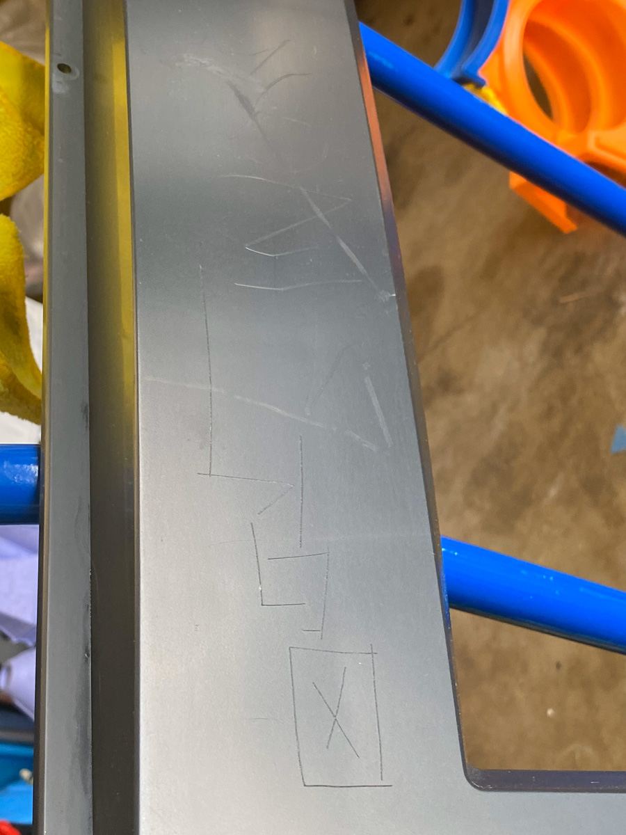

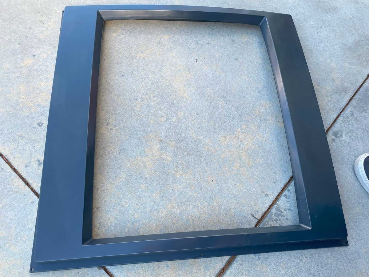

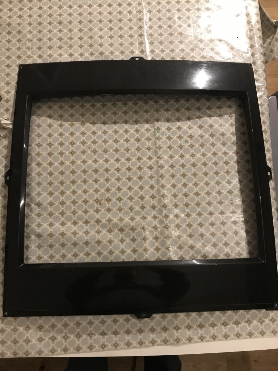

If you recall earlier in the thread, the bezel was pretty scratched up. These vandals scratch tagging this cab all up need to be dragged out onto the street and flogged.

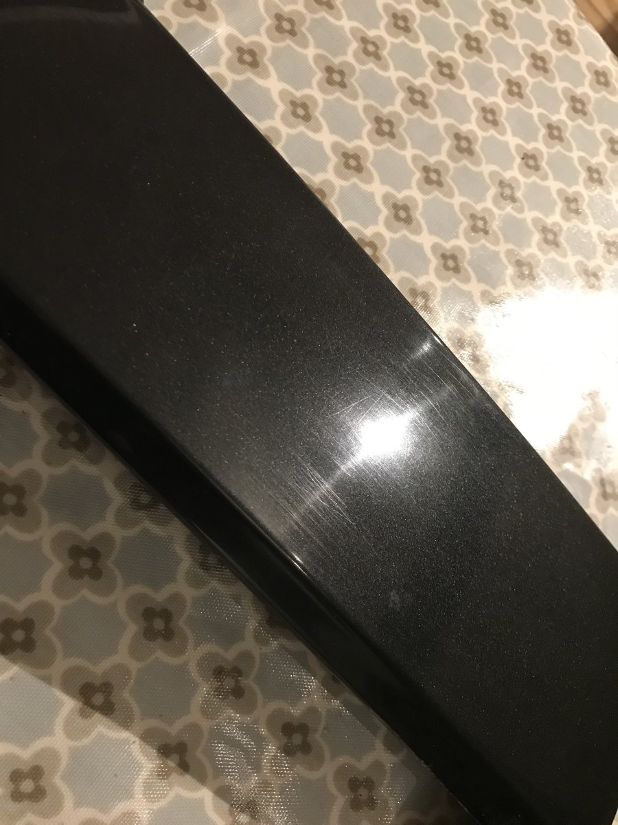

Here's an example of one of the worst areas on it:
These are pretty deep.

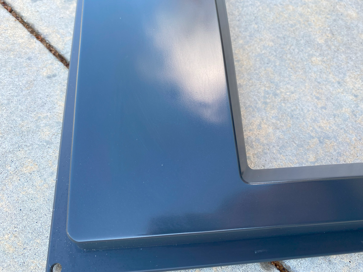

I didn't take many photos of the process, but I sanded them down with 180 grit sandpaper, that really roughed them up, then wet sanded with 400 to tame and smooth the surface. Then 4000 to further fine-tune sand it. After I was happy with the smoothness, I hit it with some car polish.
Really happy with the results!
In direct light:
It's almost like new! and I didn't have to paint it, which I was hoping to avoid due to time.

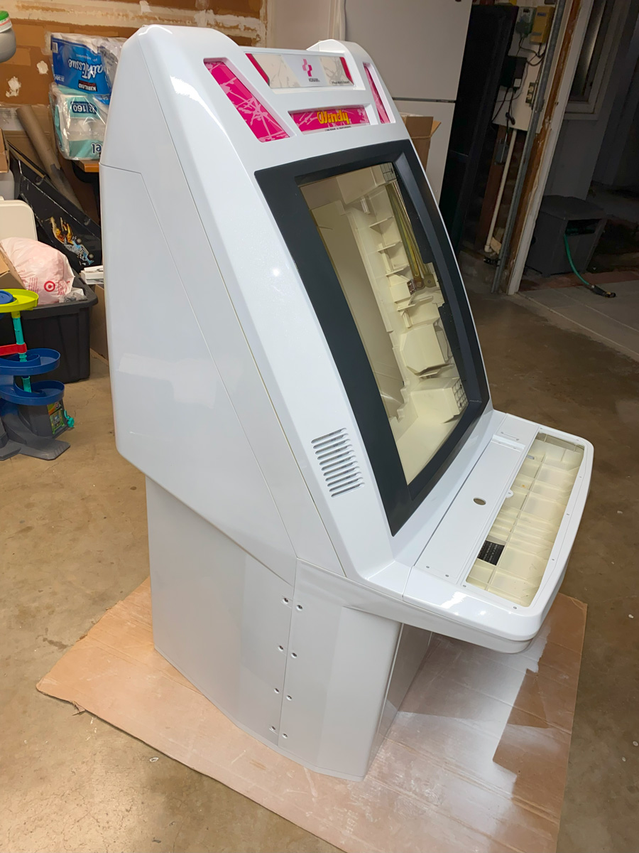

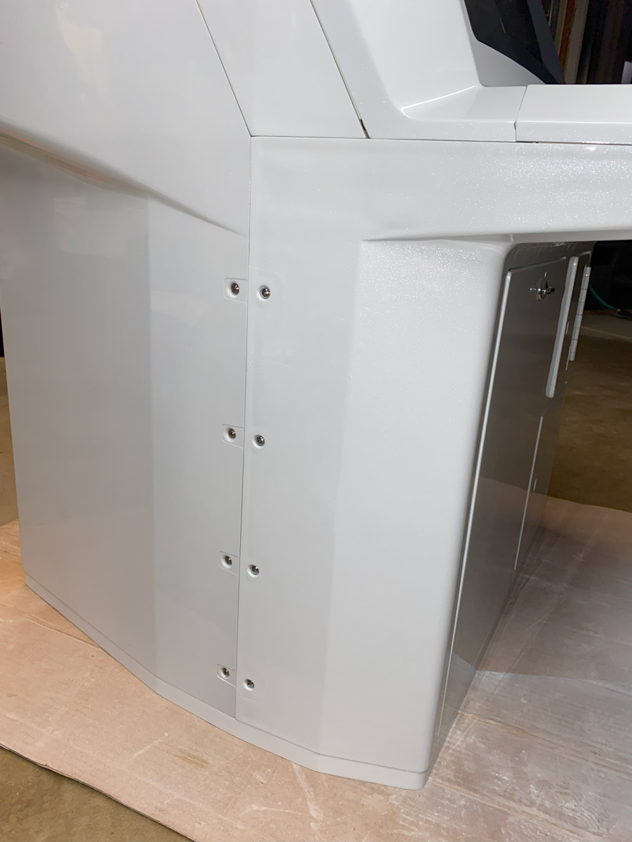

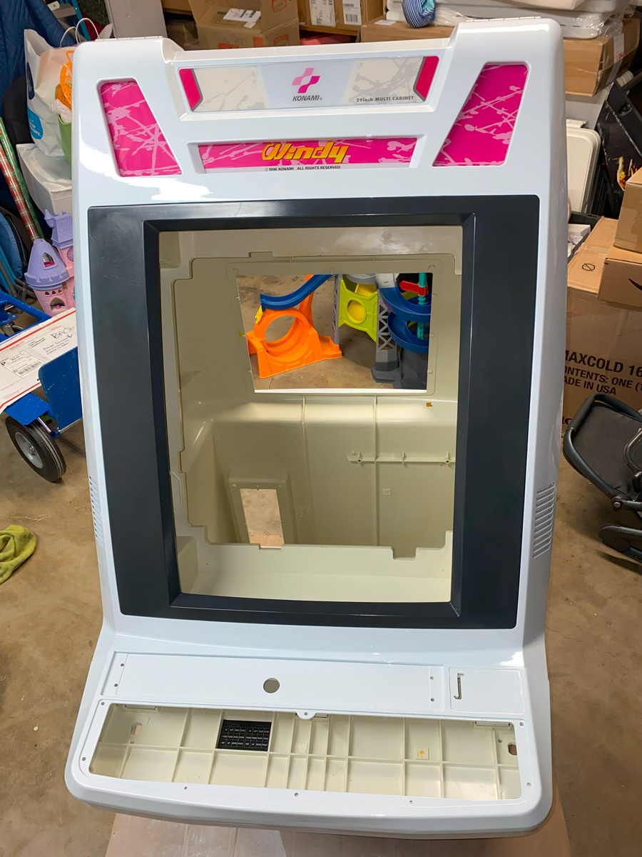

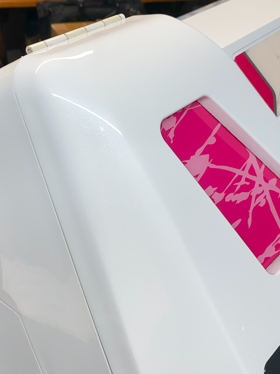

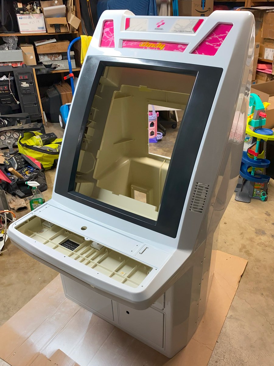

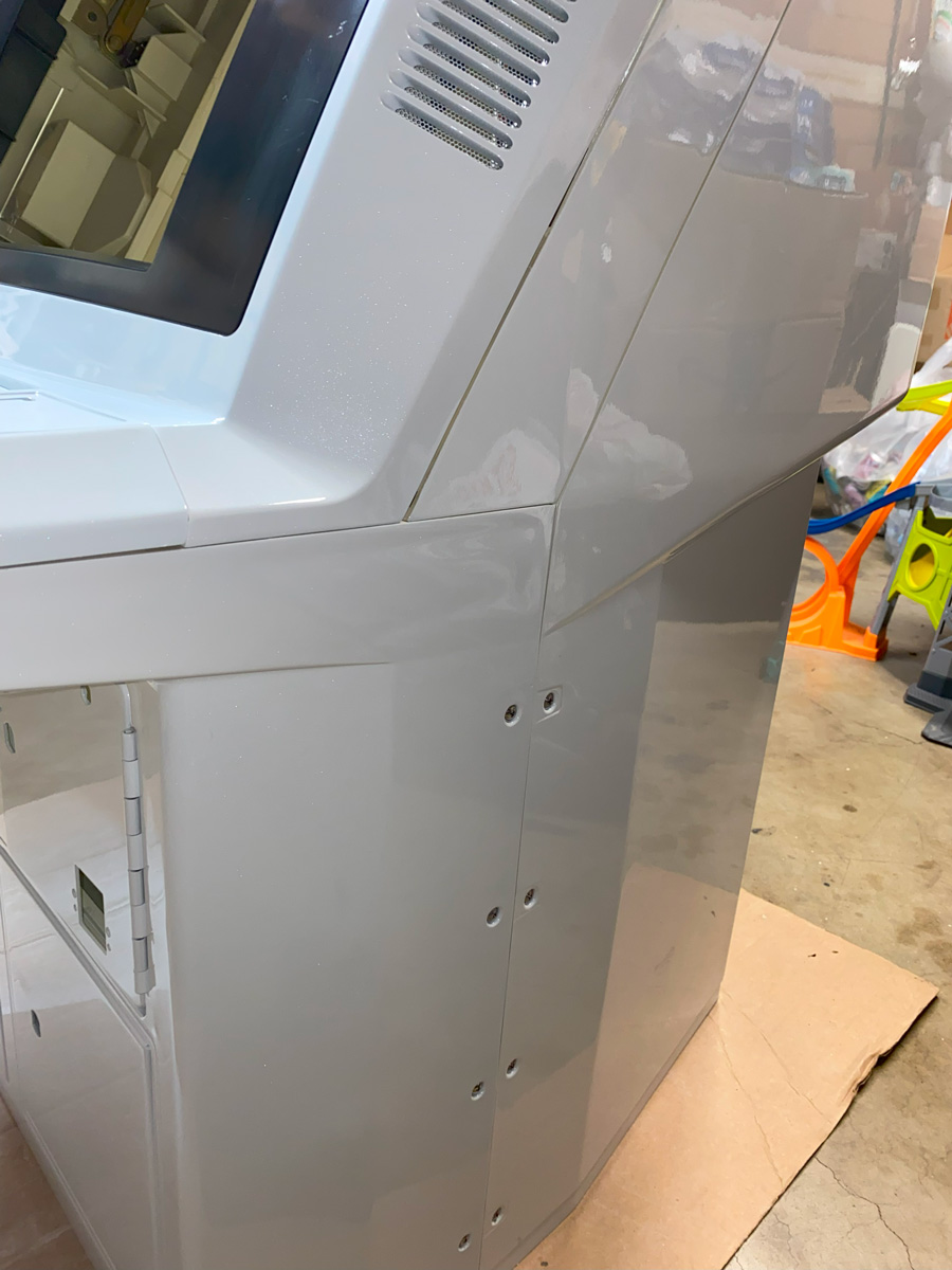

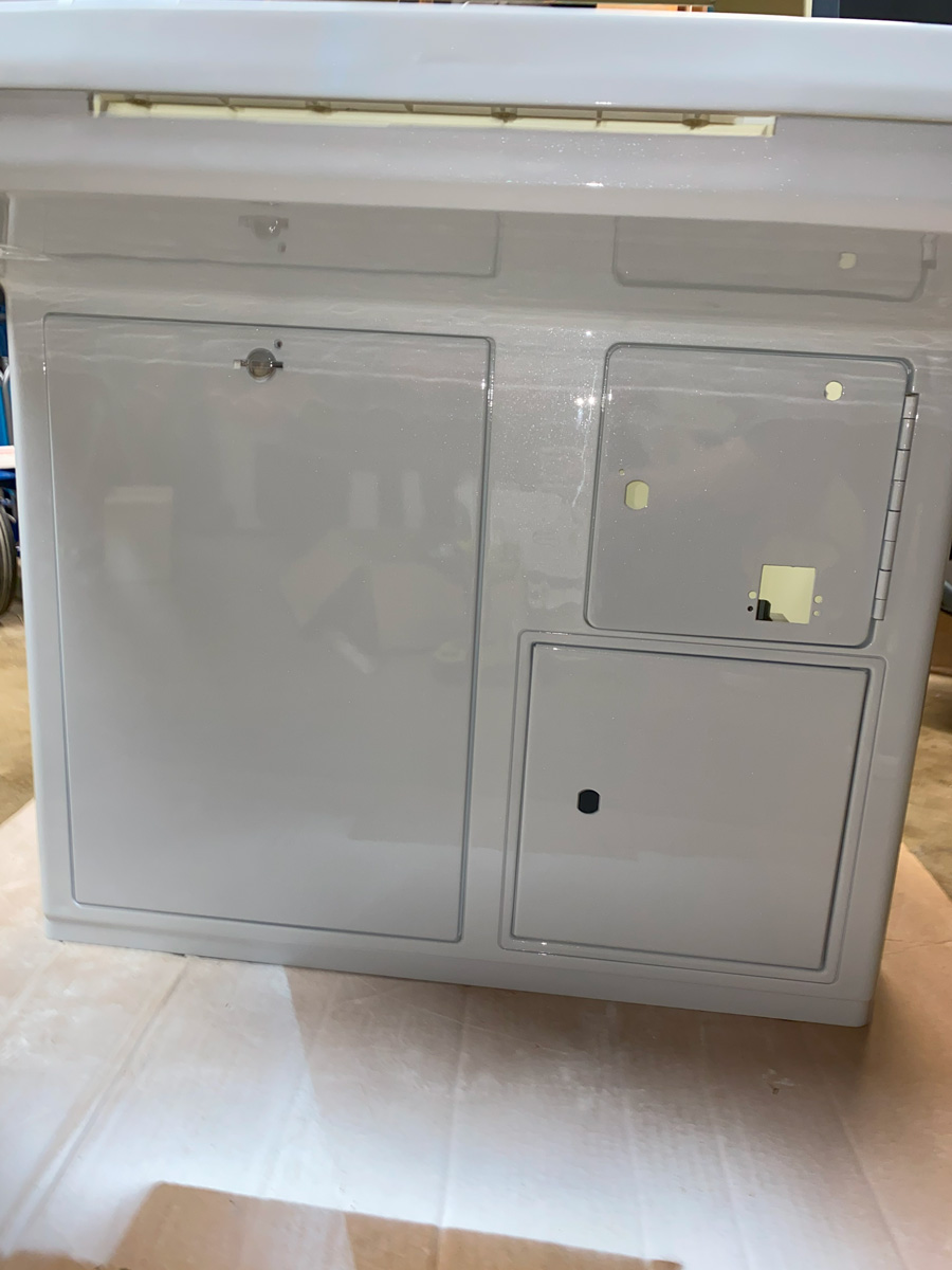

Yoooooooo! I am so happy with how this turned out!
Hard to photograph the pearl, but it has a nice sparkle.

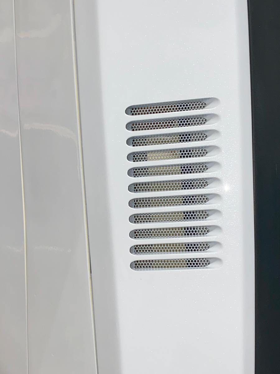

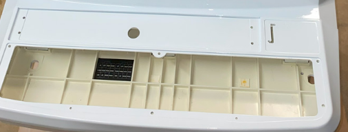

Speaker grills looking nice too.
You can't even tell there used to be scratches and 2 ugly holes drilled into the sides.
Doors are fressssssh
This is incredible. Everything is super clean. The painters said this is the same pearl white they use to paint Lexus'. :D luxurious!
This is the home stretch, I should be done with everything in about a week, maybe less. I'm hoping the repro art will arrive soon so I can apply it to the cab. But I'm glad I went with the pro painting route, this finish is something else!

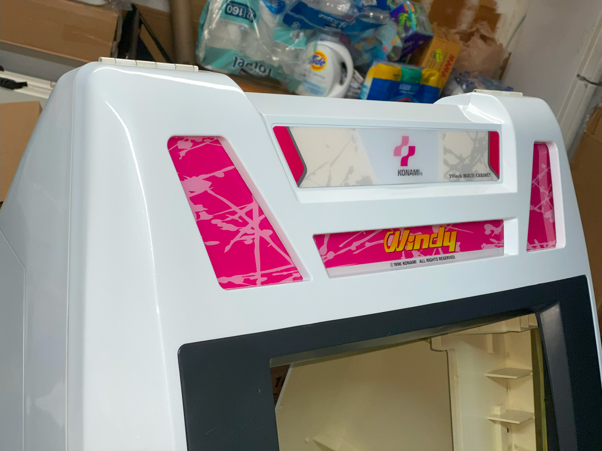

I think it's awesome, so the Konami windy was pearl white and not simply white?
Yes, the Windy and Windy II both have pearlescent White paint from the factory.
It looks great in person. I’m looking forward to seeing how the light from the monitor and marquee illuminates it when everything is put back together.

Interesting how you dealt with the bezel i'll have to keep that in mind. Mine was covered with fine scratches that were deep enough that you could feel them.
I tried a few passes with novus 1-2-3 and it looked better, but I still decided to paint it.
I spent a lot of time sanding, polishing, re-sanding, polishing. But it's in good shape for now. I could probably spend a bit more time on it to get it perfect. I might do one more session on it since there are a couple small areas that could use a bit more polishing.
