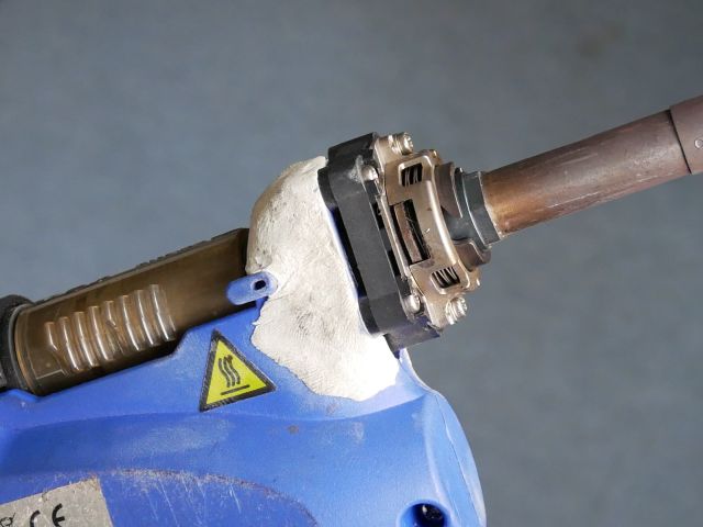

I dropped mine in 2018 and it landed on the tip. I had to epoxy the thing back together. The hexagonal plastic bit before the nozzle also shattered. Heat insulation flange, I think? Anyway, Hakko sent me a replacement for that, for free. That was pretty cool.

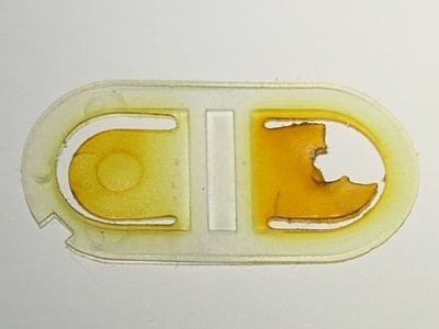

Not long ago it started making an awful sound, so I pulled it apart and found that the valve plate is completely shot.
Unlike before with the flange, it was now nice to see that spare parts are readily available and pretty decently priced too. If you're in Europe, Batterfly in Italy has almost everything available (although not necessarily in stock). A new valve plate was two euros.
