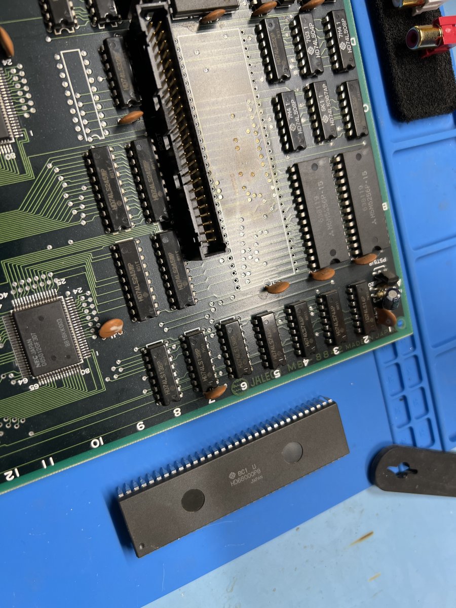

1. Spend the extra 2 mins tinning the pins with a little extra solder
2. Desolder at 360 degrees holding against the pin for 1 second and it removes all solder with ease. The 0.8mm nozzle means the full circumference of the nozzle is touching all solder and no pcb for an instant melt.
3. Don't attempt to extract the component until giving the pins a quick blast with hot air at 320 degrees @ full air to guarantee any tiny solder remnants melt and the component will glide out with zero force and no damage.

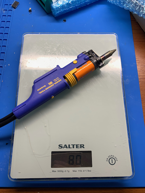

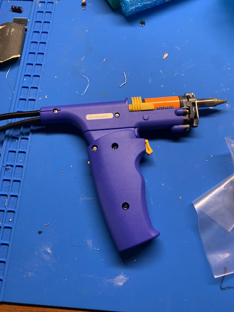

Can be used in either "pencil" or "gun" configuration - the pencil weighs about 80 grams (under 3oz). You can activate either by pulling the trigger, pressing the button on the pencil, or using the foot pedal.
The "nozzle" is actually a completely separate heating element, an entire self contained induction tip. It heats up very fast and maintains its heat perfectly even under very high loads. It can do interesting tricks like cleaning the nozzle while it is still powered but decoupled from the device.

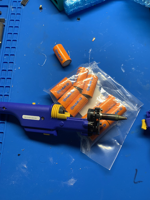

It goes into a specific cradle that will cool the tip down when not in use, power down after idle time etc. The filter tube is a disposable unit, they come in bags of ten.
