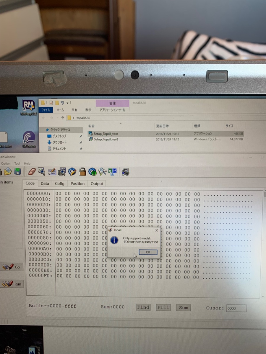

When I open the soft a message popped up: only support modal:TOP2011/2013/3000/3100.

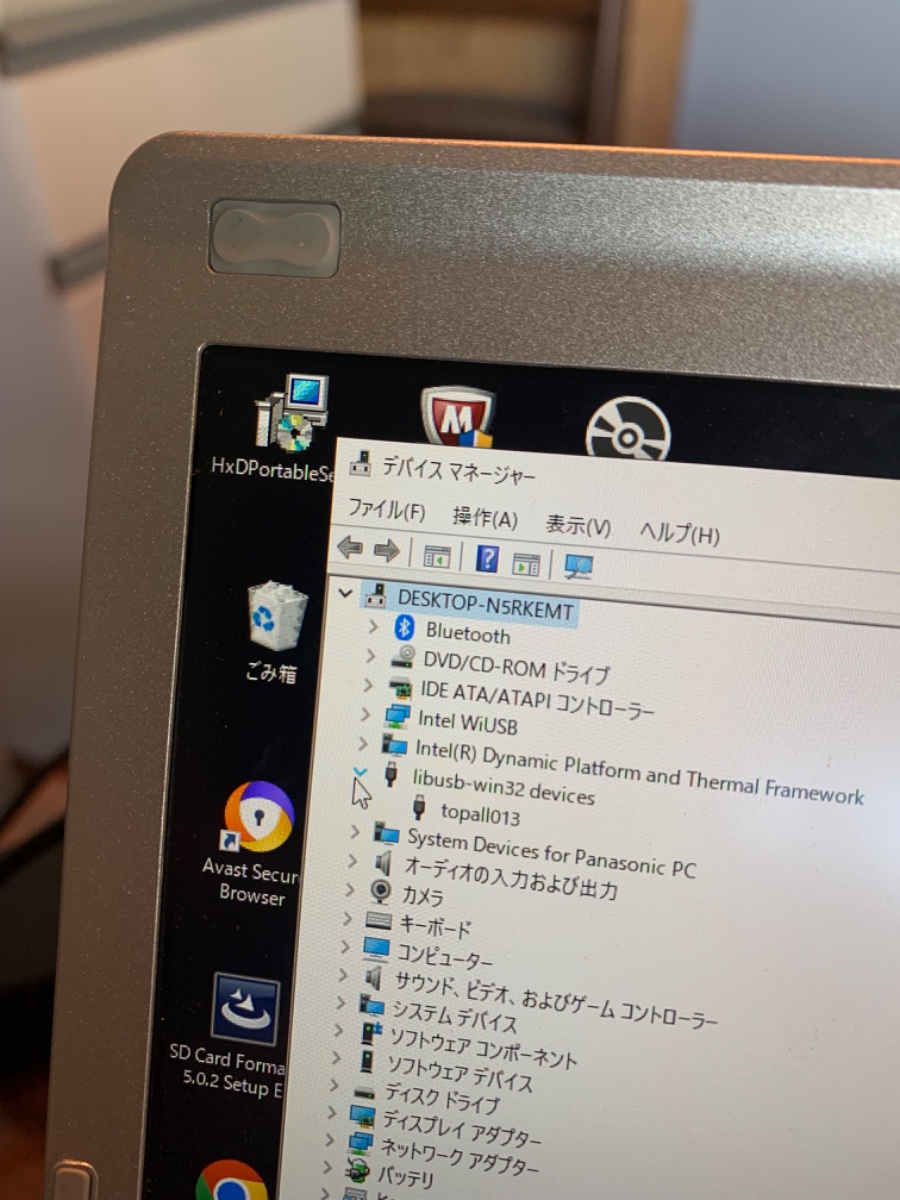

The driver installed is the following :
liusb-win32 devices
topall013
Does the driver is not appropriate ?

Do you have the same version of the driver ? Topall013 ?when I open the soft the message shown on the 2nd picture pops up and if I click on ok, the soft shutdown.

Perhaps your programmer is faulty as it’s not being detected by the software. Do you have a photo of it and what lights are illuminated?
Have you tried another USB cable or powering the device with a power brick?
If you’ve tried multiple machines and installed various versions of the software, I’d be inclined to think you have a dud and might be worth returning it for a refund / replacement.
when it is powered on, the red power led is on and when it is connected, after disable the device signature, the green led is also on. Yes i tried another usb cable too, the one I used for the proman simms programation, same result.

Looks like it’s time to send it back for a replacement.

There’s generally no problems with the Top3000. I have been using mine for ages with zero issues. Sounds like you got a faulty unit or there’s something funky going on with your operating system.
The other two programmers you mentioned are most likely made in China too.
I’d suggest sending it back as faulty for a replacement and see how you go.
