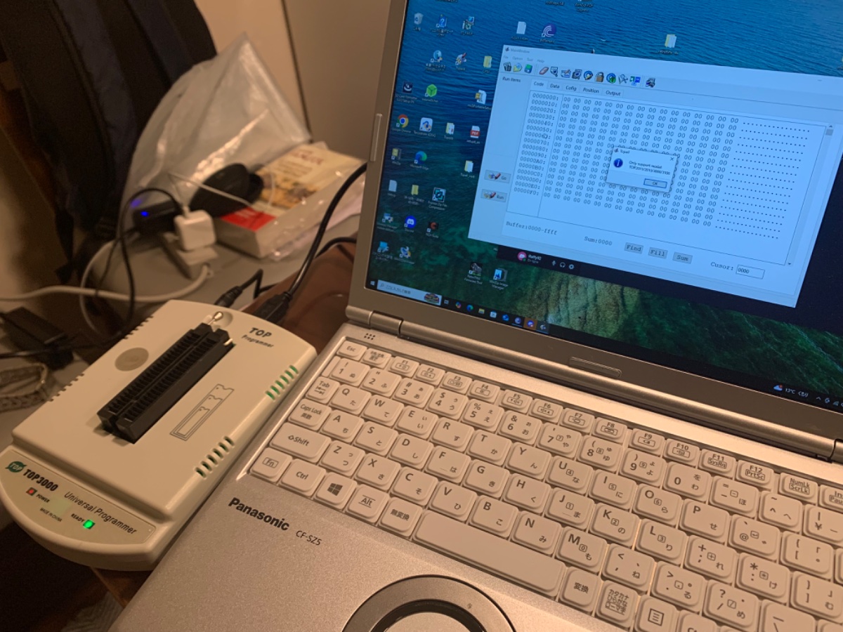

Help with Top3000 Programmer Drivers
There’s generally no problems with the Top3000. I have been using mine for ages with zero issues. Sounds like you got a faulty unit or there’s something funky going on with your operating system.
The other two programmers you mentioned are most likely made in China too.
I’d suggest sending it back as faulty for a replacement and see how you go.
thanks but i dont want to have something to do with those sellers. that it !
I am wondering why i cannot open the driver install.exe program from an upper version of the soft. it open then directly close. security problem ?
I know those 2 others programmers are made in china, that s why I didnt buy yet one of them. Probably need to disable the device signature as well.
thanks for your support
I am still trying to try to use the top3000
Send it back and get a replacement. Your programmer is probably broken or your computer isn’t compatible.
Posting about it constantly on the forum numerous times a day isn’t going to fix anything.
People are using the same software and programmer that you’ve got with zero issues.
Send it back and get a replacement. Your programmer is probably broken or your computer isn’t compatible. Posting about it constantly on the forum numerous times a day isn’t going to fix anything. People are using the same software and programmer that you’ve got with zero issues.
I dont understand the meaning of this message
