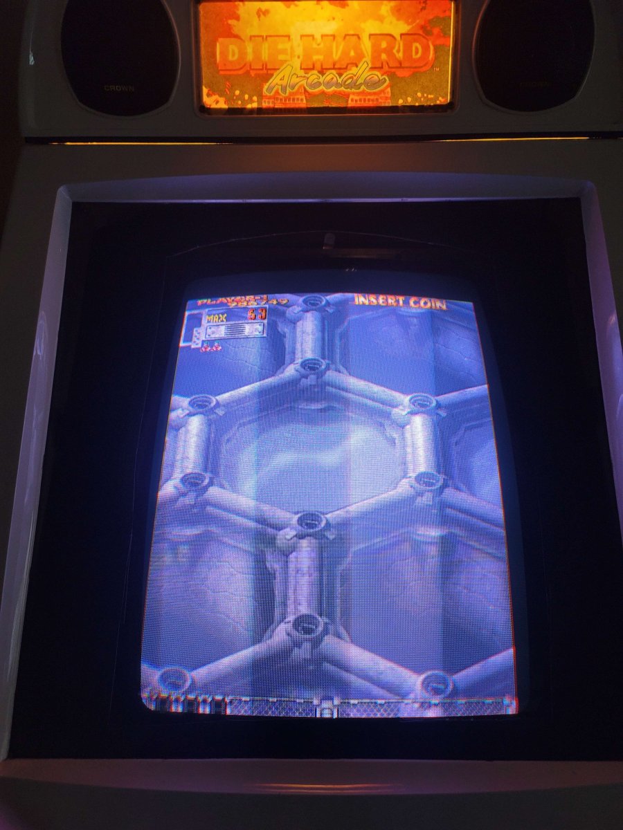

I had a free hour today, but the white label (version-a) still crashes for me at the exact same point.
There's mention of the timer on the startup, it still counts down on mine. I'm using a KovSH boot, perhaps the MCU needs some sort of command to keep alive?
Black version B still works fine past the crash point.
If nothing else helps and this works 100% confirmed on non-encrypted boards, how do i stop the MCU from doing its work and run non-encrypted mode?

Can you make a video of it so I can see exactly where it crashes and see what it does when it crashes? I've got a couple of guesses as to why, but nothing concrete without more info.
@iq_132 The freeze/crash occurs in stage 4, near the 'honeycomb' area. A picture is here:

The debug info did not show up for me the two times i tried it on the new rom. I did not see if it was time based, as i was not centered, i did take a picture but my phone is dead and charging right now. I'll see if i can make a video tomorrow.
From reading back the thread, there was no r/w to 0x50000-FF when i tried to duplicate in Mame.
I just tried this and when playing white label, the game crashes midway through the fifth level (which is the previously mentioned honeycomb area). I did take a picture of the first crash, and will update this message with it a little later. I was also able to play all the way through black label. @iq_132, Thank you for putting this together.
It is a conversion cart I put together using the original instructions posted on here before lidz and fluffy carts were available. I can record any video or see if I can reproduce it on mame if it would help narrow down the issue.
Burned this to a 27C322 tonight, also froze on White Label 5th stage. Here's a screen of where it froze, happy to provide any other details that might help. This is in a conversion cart.
