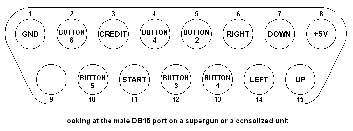

I would like to know the connection mapping of the DB15 PIN with the HAS ?
If someone can help me with a drawing to know which pin number corresponds to +5V, GND, DOWN,HIGH.... it would be nice !

Do a Google search for the Neo Geo controller port pinout.

RGB mentionned the thread were you have a chart with different Neo Geo Pinout (including the HAS)
