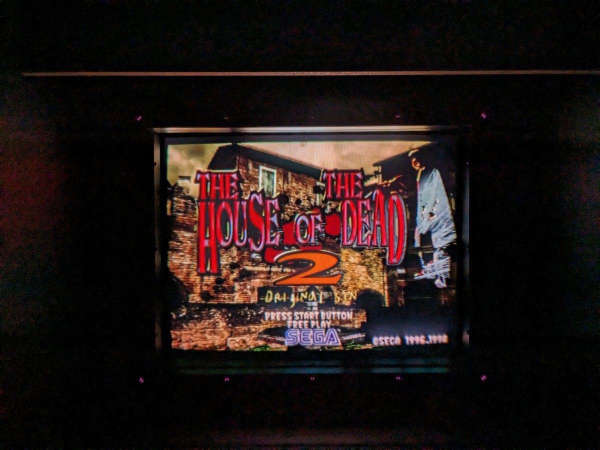

Backstory I spent too much time on x(fka Twitter) at the end of July. 'wiki of the dead' shows up in my feed and I give them a follow(hotd series fan if isn't obvious). One of their posts was a screenshot of hotd2 title screen but it was different. It had a subtitle : original sin. Wtf is this I asked myself. A Google search taught me the prototype name was hotd2:original sin and a mame dump of it existed. I learned looking through all the hotd2 mame files that the only difference in game roms(prototype or normal region versions) was the ic22 file and having to use the prototype bios(the bios bit turned out to be wrong). I renamed the ic22 and made a new hotd2 rom zip. I command line launched mame with my new rom zip file. Ran as well as to be expected (I don't keep up with Naomi emulation but it chugged. My PC can emulate PS3 games fine 🤷‍♂️). I hit up skate to burn me the prototype bios and ic22. Usps seemingly lost them for 2 weeks and they magically showed up today. Guess what?
I've got hotd2:original sin running on my cab on a stock hotd2 bios. I was too lazy to remove the game PCB and bios swap . Metal cage Naomis are a pita.
There are a few differences.
I immediately noticed the timing of the music and the announcer saying house of the dead,the flame animation being different and minor mutant texture differences.i only casually played through the first level. I know the game ends at the coliseum.

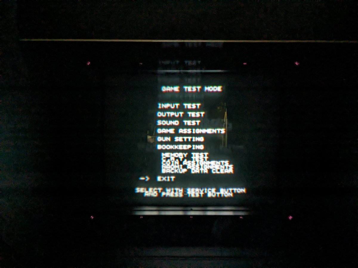

The test menu is different
The sub menus have smaller font/different resolution

@PlatynumX why to so over complicate things ? in HoD2 proto you may simply
test switch -> NAOMI ASSIGNMENTS -> COUNTRY -> set to USA -> EXIT
GAME ASSIGNMENTS - BLOOD COLOR -> select RED or GREEN
that's it

@MetalliC it's not there in the test menu to enable on the prototype on my end.Its in the ic22 but it's disabled.I don't have a multibios.im currently netbooting this on a Naomi with a Japanese bios. I think I misunderstood your post about how the bios is loaded and it hit me as I was typing this. Where's my duncehat? Lol
