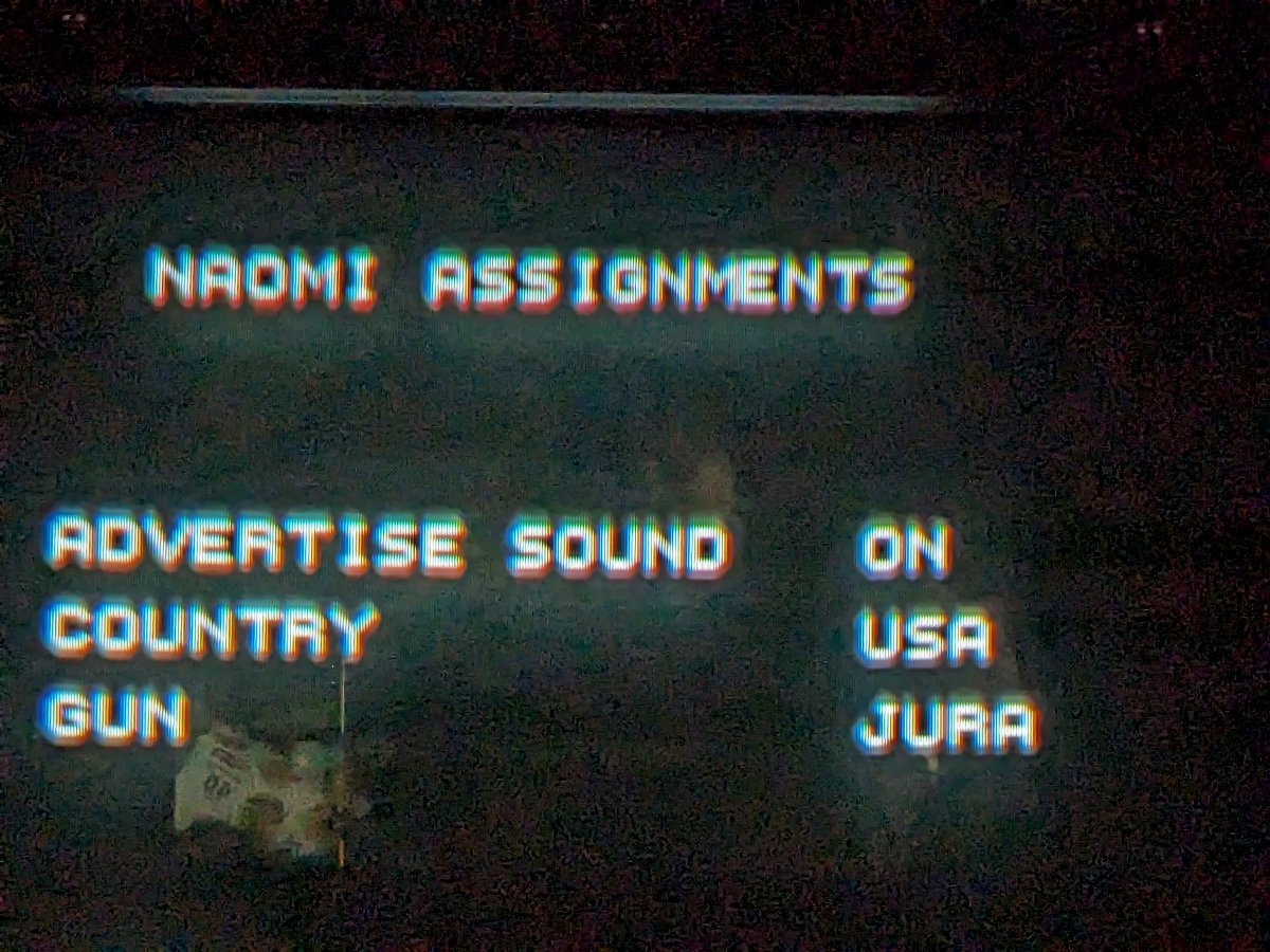

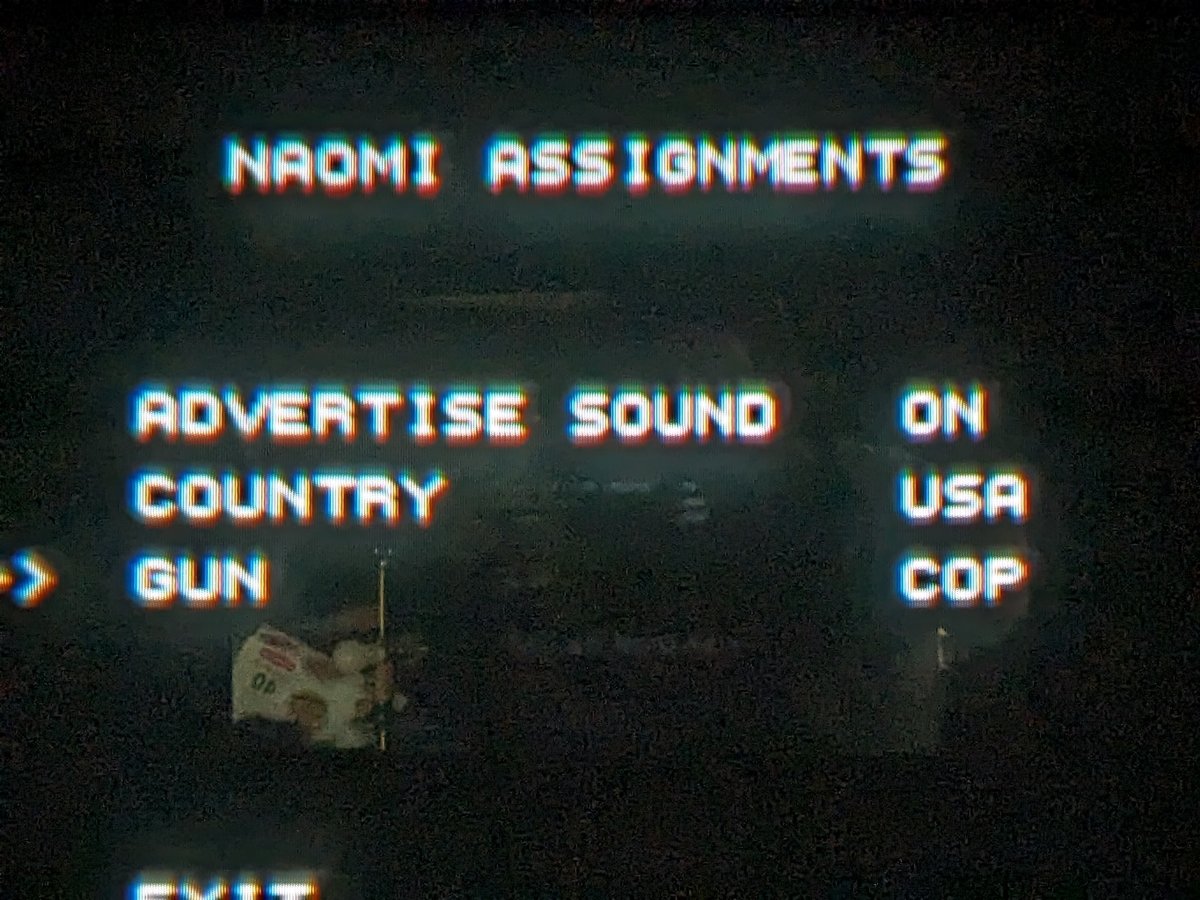

Followed directions to the t. Wasn't paying attention there was a gun setting in Naomi settings. Changing region changes the gun setting to 'non'. Found that out the hard way when my shots only registered dead center. Oops. Seems this prototype could use crt type light guns as there is a 'cop' setting. I'm not really a hardware guy so i don't know what that would take.i don't go deep enough into test menus and lately just overlook stuff right in my face. Heh. 'jura' is for sega type 2 guns.

JURA would be Jurassic Park The Lost World, which is the first game to use the Sega Type 2 guns.
COP is likely Virtua Cop 2, which is possibly one of the last games by Sega to use the light gun system?
Very cool find, and would be interesting to work out how it was actually trying to input these on the JVS end.
