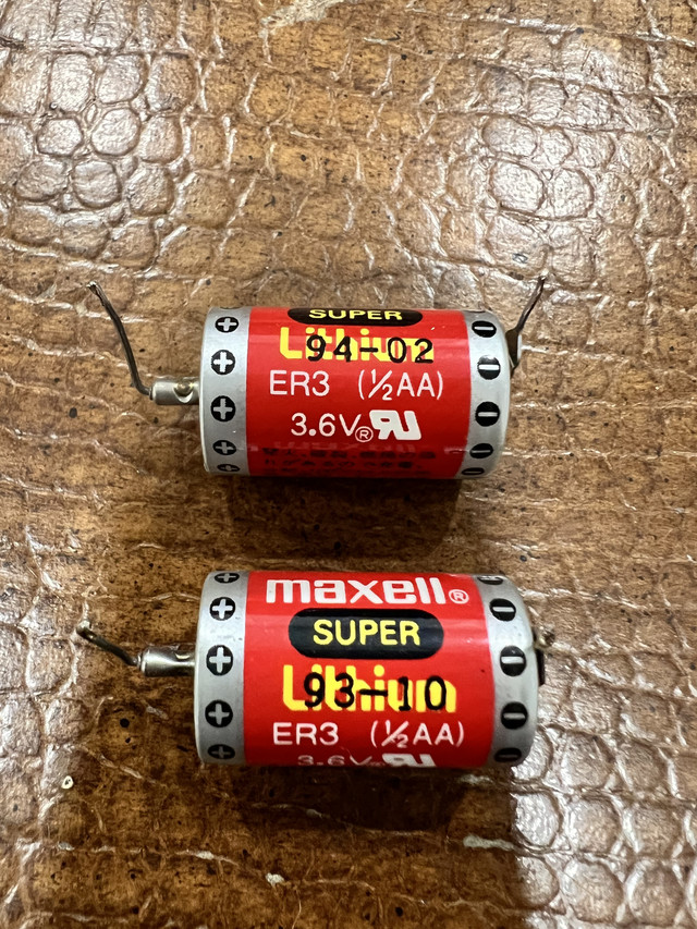

Today I was playing some games and realized I have 2 Dungeons & Dragons: Shadow over Mystara (Japanese: ダンジョンズ&ドラゴンズ シャドーオーバーミスタラ, Hepburn: Danjonzu & Doragonzu Shadō ōbā Misutara) Instead of one of each game Tower of Doom and SoM, d'oh! On top of that, my notes say I bought them years ago and they were on battery! Oh crap I thought, I need to check this out. Well, both games loaded, although the A board had no sound (quick fix, hold down the "down" button on A boards while booting, then go into menu and adjust sound) this fixed it. Then I said, aw crap, even though I don't have a way to revive them, I need to pull the batteries. Despite them fully working. Check out these codes. If these are dates, one was 28 years old and still working, while the other was 29 years old, and yup, still working!

Do you see any indication that someone changed the batteries before? When I replaced my batteries I could see that it was already done at some point before me. I plan on changing my batteries every 5 years to be extra safe.
Yeah, the newer one was changed, but not the older one. Still, batteries that are 30 years old, still working?...

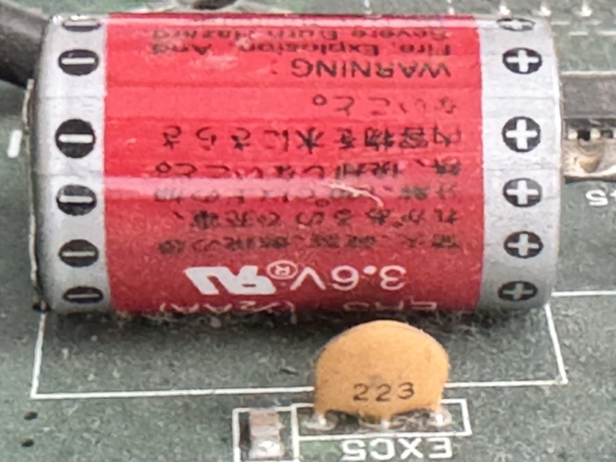

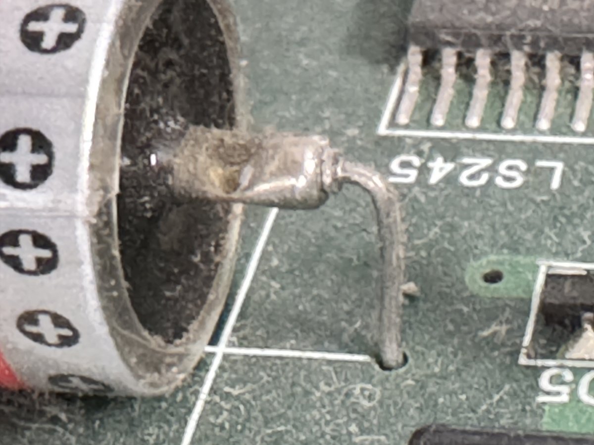

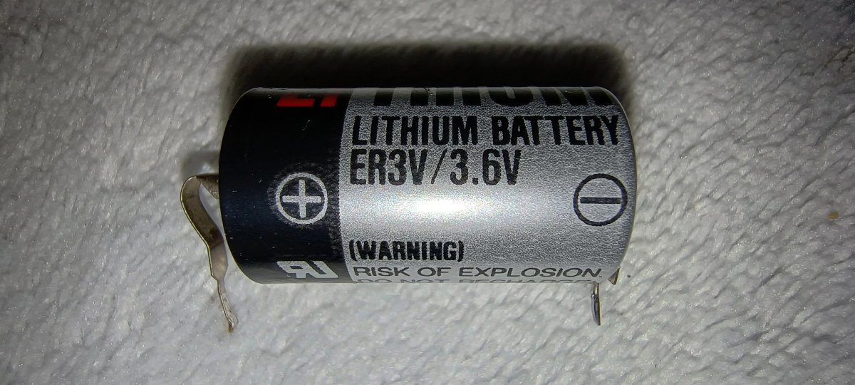

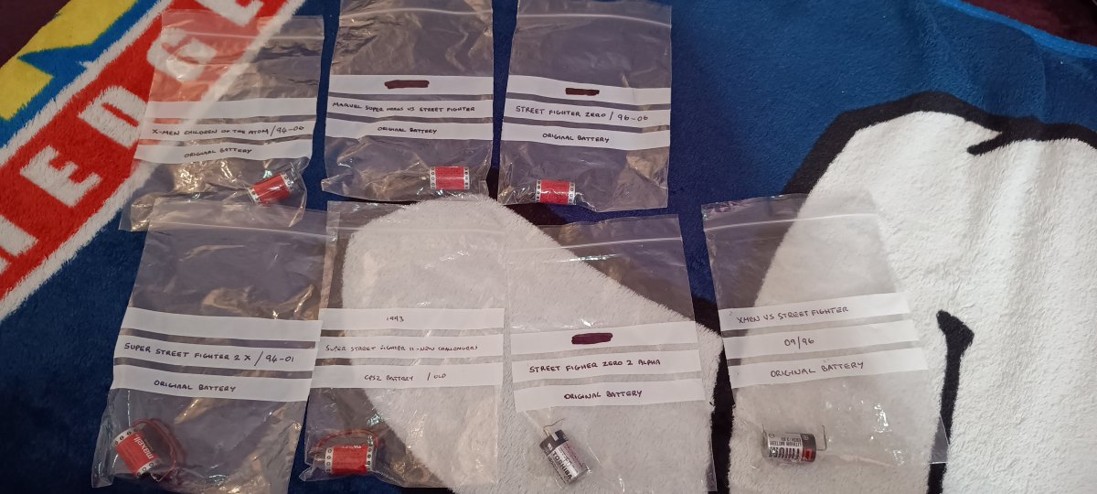

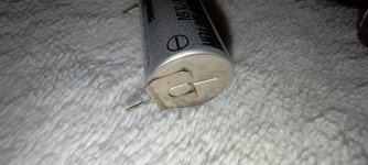

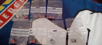

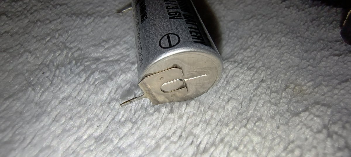

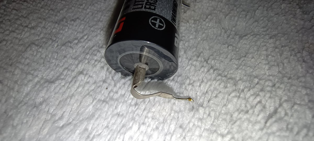

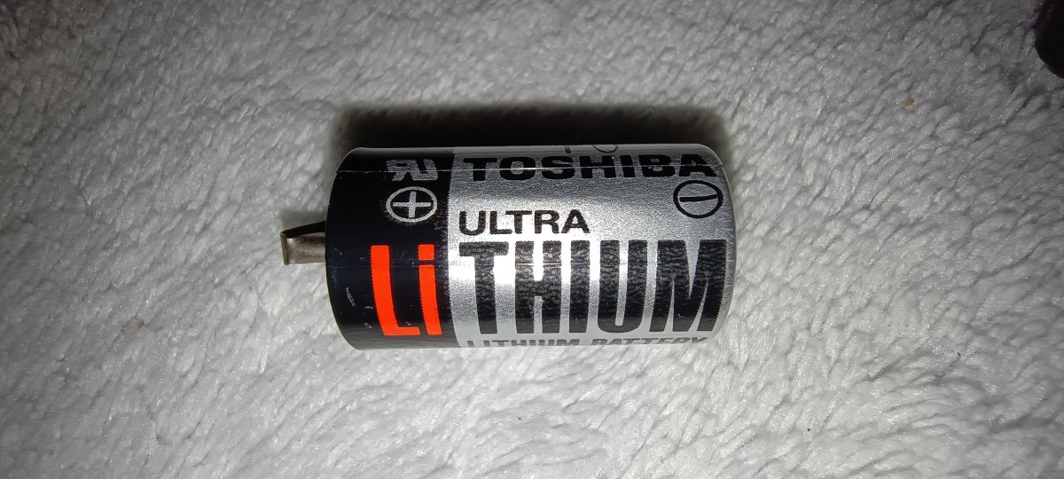

Old post I know, but I've bought 6 cps2 boards so far this year, all 6 had the original batteries in 4 Maxell and I have 2 with silver Toshiba batteries that are from 96 / 97, USA Xmen Vs street fighter and Brazil Street Fighter Zero 2 Alpha I think capcom also used Tosh batteries as I've had a couple with these batteries on in the past.
Hey, an oldie but still a goodie! Pictures of those old batteries would be cool too!
Yup this is some of the ones I saved, I used to chuck the old ones away but I bag them up like a sad git and keep them now this is the Toshiba battery I was on about, interestingly you can still buy these tosh ones new, even Maxell ones on axel leads.
I've noticed these tosh batteries seem to be more on the Brazil and Hispanic versions.
IMG_20240801_113818327.jpgIMG_20240801_113915393_HDR.jpgIMG_20240801_113927214.jpgIMG_20240801_113939288.jpgIMG_20240801_113951214_HDR.jpg
Are you sure those batteries have never been changed? Batteries can have a long shelf life and the date stamp is only the date of manufacture. Those 1996 batteries could have been installed in 2006. I recently pulled 2 batteries out of CPS2 games, one dated '94 and the other '97. Both measured slightly above 3.6V, even higher than the new batteries I just bought from Digikey. I would expect at least some voltage drop. Maybe these types of batteries don't degrade like that. I don't know. And all of my CPS2 games were definitely opened before me, which doesn't necessarily mean the batteries were replaced but it's a possible indicator. I haven't seen a definitive battery life expectancy and it would be good to know for sure if these old Maxells that I pull out are originals.

I think Maxell rates a 10 year lifespan on those batteries, which is probably a conservative figure.

By life expectancy I mean how long they will last installed in a CPS2 game. The battery manufacturer can only provide an estimate of how many years the battery will hold a charge before being installed in something.
These lithium batteries will maintain their charge around 3.6 generally until they pop.
Unfortunately theres no real measurable way to know when they will explode besides age.

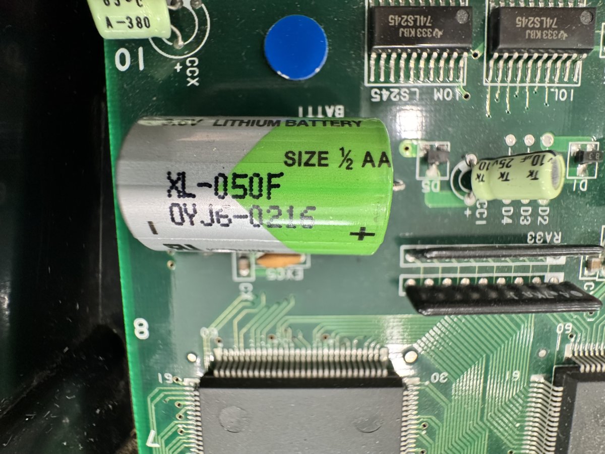

I just got an AvP and popped it open to check it out, here is the battery. Can anyone tell the date from the code?
I think that battery is 02/16 production so about 8 years old.
Could be wrong but pretty sure, caps look to be replacements also.

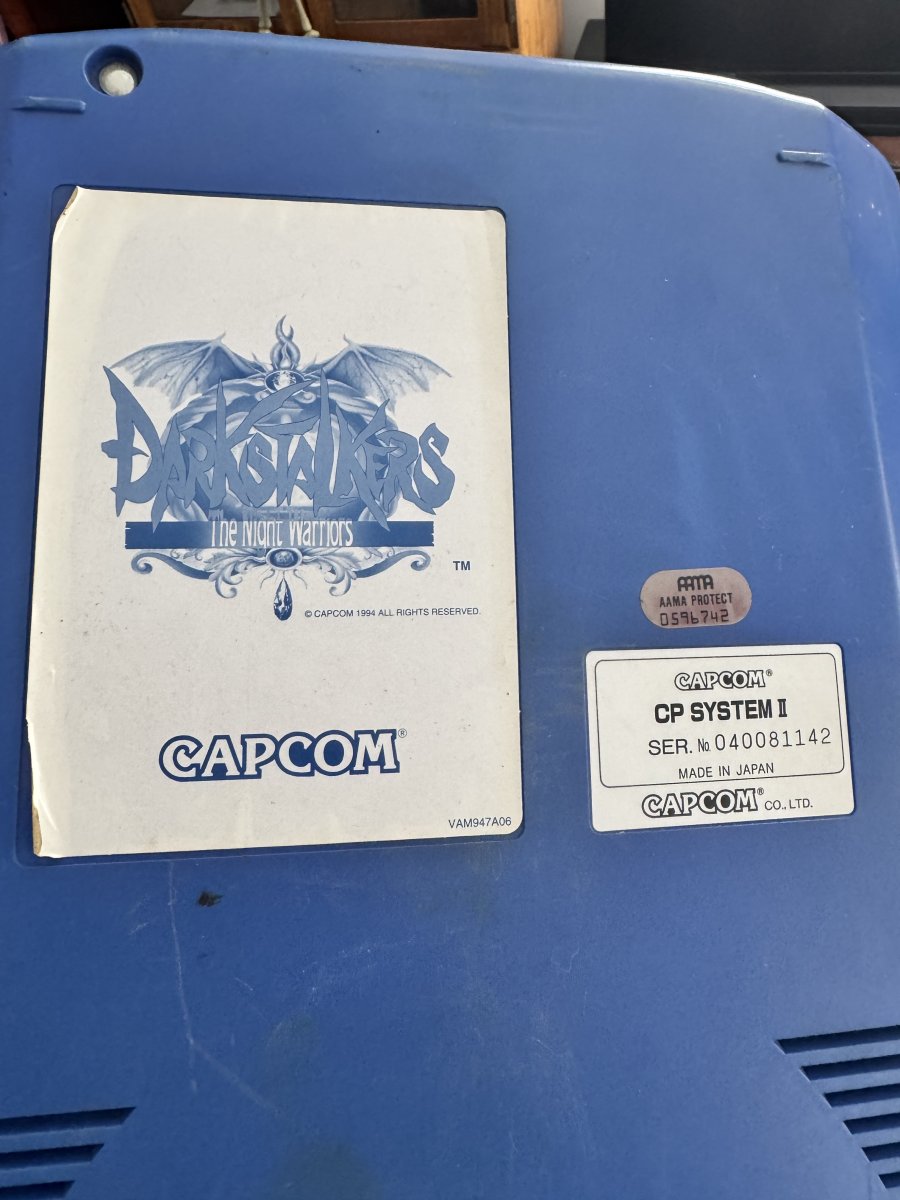

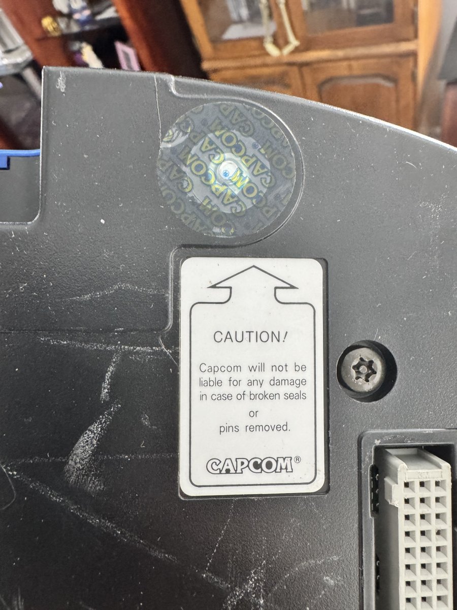

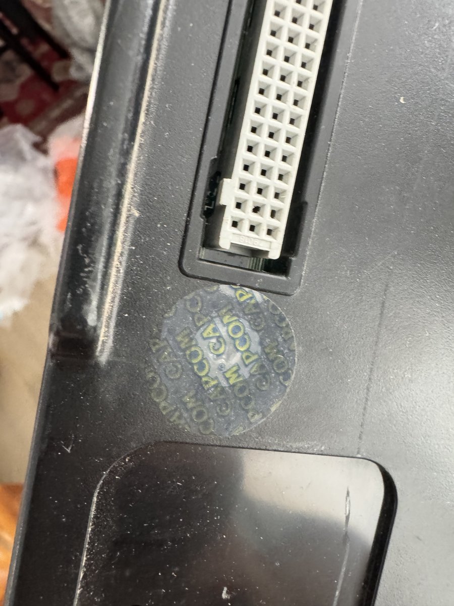

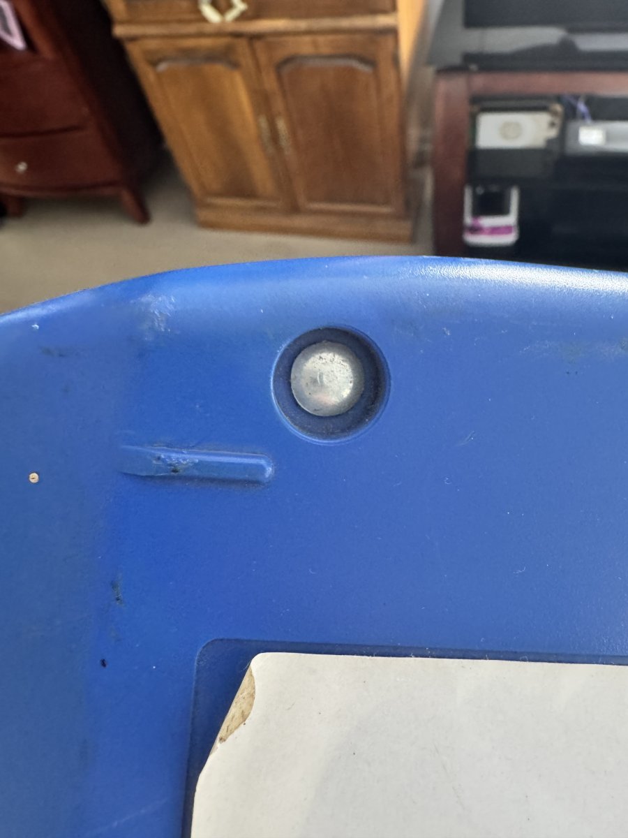

New update, man still finding US CPS2 games in the wild with original batteries. Just grabbed an X:COTA and Darkstalkers and the DS hasn't even been opened yet. Both still on battery. Wow.
