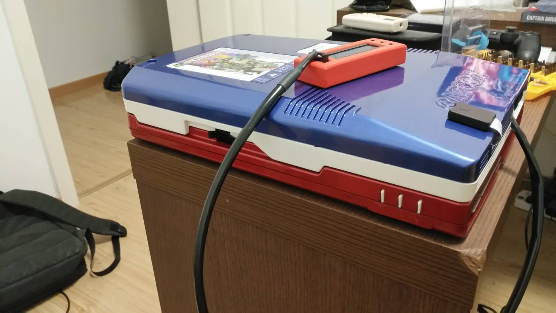

Yeah mine was just stock standard rattle paint.
Once I filled mine with car filler, I sanded it down and moulded it as best as I could.. Rough sand with some 300 grit sand paper, I then primed a couple of coats with a west sand with 800 grit in between coats.
Both paints were 3 coats iirc with no gloss as they were already glossy.
This is actually a pretty easy paint job to be honest.
This one looks really good...

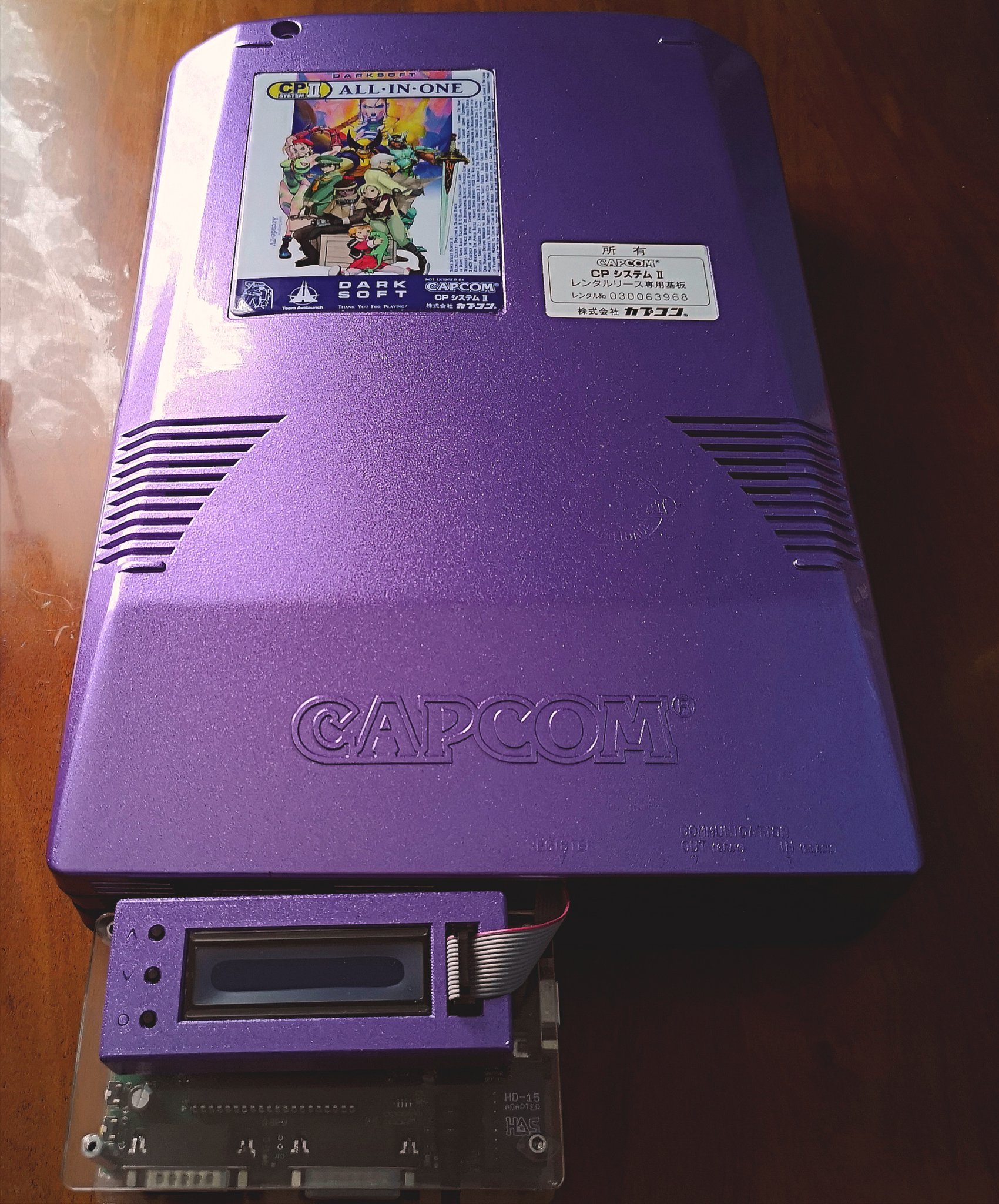

I wanted this purple so bad, but I couldn't find the colour in AU.
I tried this paint from supercheap
At first it looked OK...
But the end result looked crap, just too dark and wasn't pleasant to look at
I'm glad I ended up with the red as I'm really happy with it.

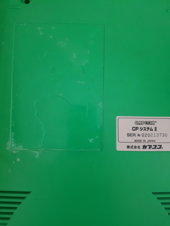

Reporting back;
I gave wet and dry sandpaper and Novus 1,2,3 multiple thorough attempts. I used them independently and together and on multiple boards.
There was little overall difference unfortunately (blue and grey boards btw).
(Strangely enough, none of my green boards have the discolouration at all).
If I had a buffing brush for my drill I would have attempted that as well. Hard to say if that would have made a huge impact - as it does indeed seem like the marks are discolouration and not merely surface stains.
