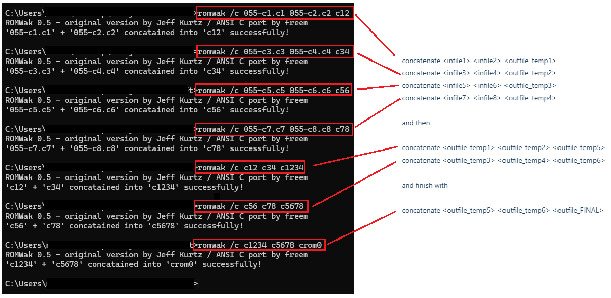

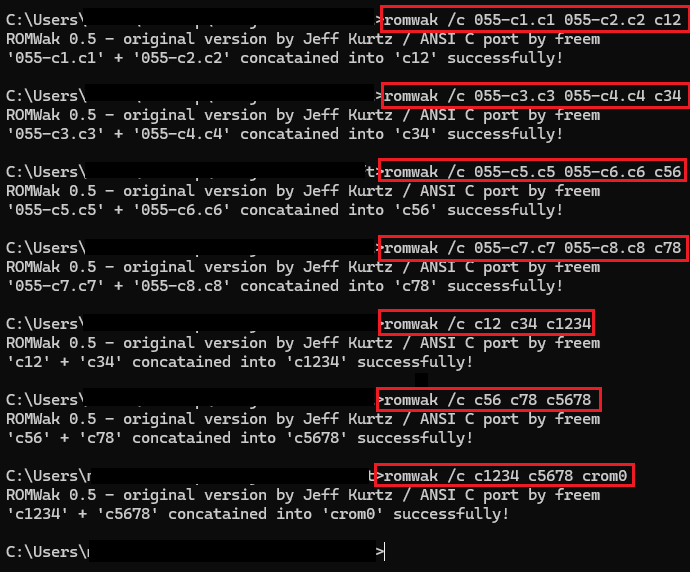

Hi,
Problem. You can concatenate only 2 files (not more) :
/c - Concatenate two files : <infile1> <infile2> <outfile>
do it in batches.
concatenate <infile1> <infile2> <outfile_temp1>
concatenate <infile3> <infile4> <outfile_temp2>
concatenate <infile5> <infile6> <outfile_temp3>
concatenate <infile7> <infile8> <outfile_temp4>
and then
concatenate <outfile_temp1> <outfile_temp2> <outfile_temp5>
concatenate <outfile_temp3> <outfile_temp4> <outfile_temp6>
and finish with
concatenate <outfile_temp5> <outfile_temp6> <outfile_FINAL>
Like that ?
Ohh that's CROM. Did you see above, that you need to merge those 2 with an script and then concatenate?
Your last 3 commands are OK, but the first 4 are not.

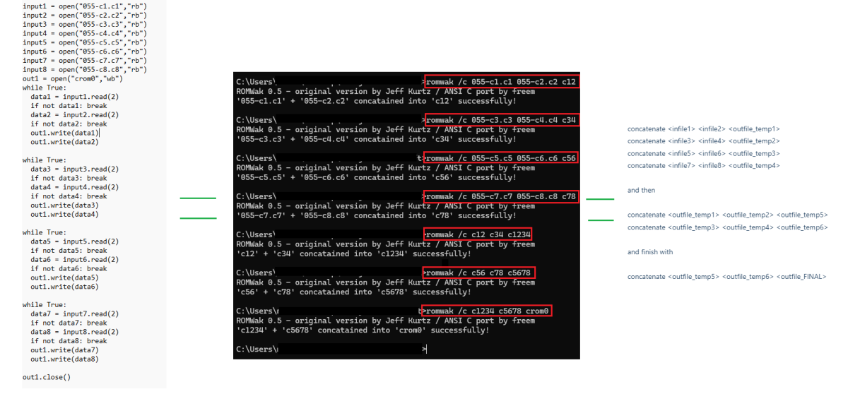

Try using this script and you'll see what I mean. It should be universal, if you just change the input files' names.
Thanks.
Sorry, I doesn't see the difference between your script, my cmd file and your post : http://url=https://www.arcade-projects.com/threads/how-to-convert-files-to-work-with-neogeo-multi.24393/#post-429617
Thanks.
What does it mean exactly that you dont see the difference? In what? In the multi? In the output file generated? Where? Please provide more detailed information in general if you want to get more accurate answer.
It's not. It's not the same to copy.one file after another (concatenate) than merging 2 bytes of each.
Hmm, for me the code and the text is identical.
