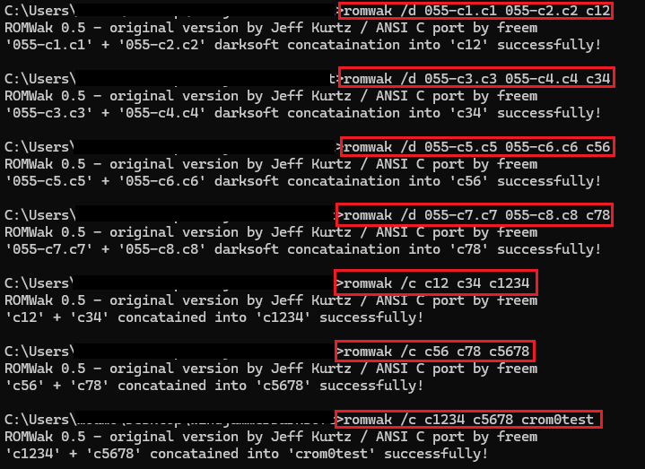

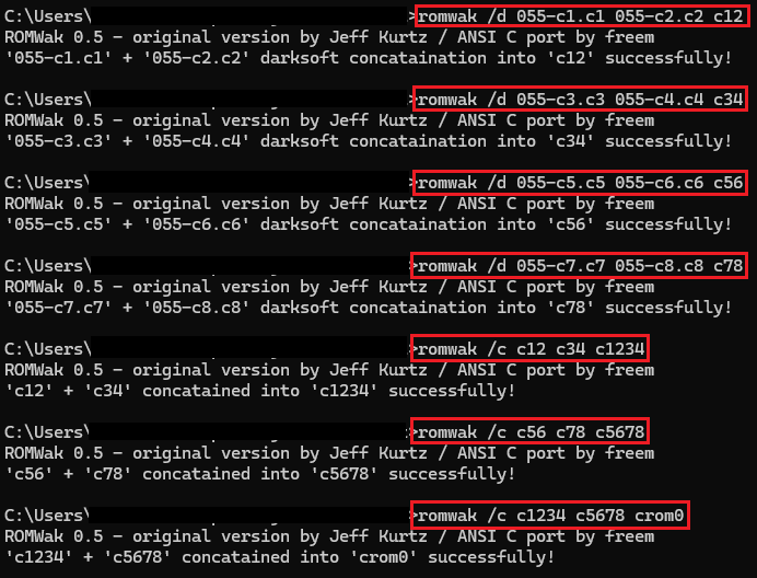

----------------1----------------
I changed the 4 first lines code by :
romwak /d <infile(X)> <infile(X+1)> <outfile_temp(Y)>
romwak /d <infile(X+2)> <infile(X+3)> <outfile_temp(Z)> ...
The 3 last lines code are the same.
----------------2----------------
romwak /m <infile(X)> <infile(X+1)> <outfile_temp(Y)>
romwak /m <infile(X+2)> <infile(X+3)> <outfile_temp(Z)> ...
But with the 2 tests (with /d or with /m), the rom doesn't work. :(

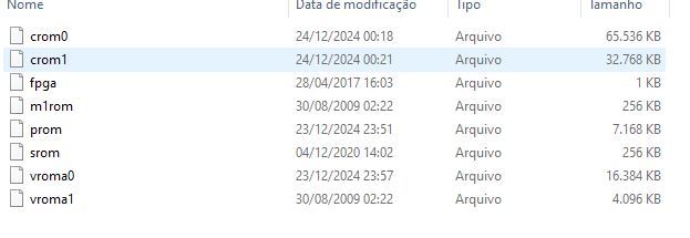

Hi, I'm here again...
I create the same crom0.
I created the same file as that of py with :
But the ROM still doesn't launch : white screen.
Then the problem is somewhere else. If the CROM is bad, you will see bad GFX, but you'll see something. Send me the original files and your conversions and I'll see what's wrong.

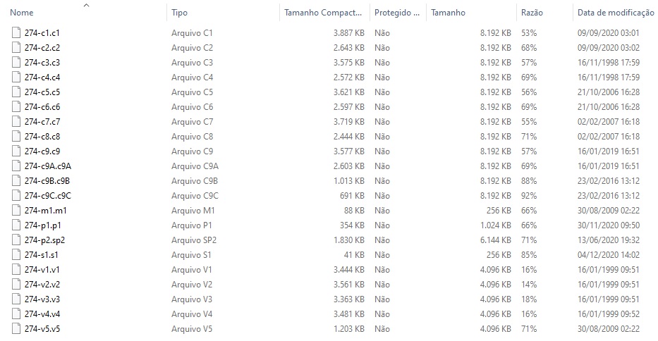

Hi,
Can i use the HJ-Split to concatenate the Vs and Cs?
Will try to convert the Kof98Ultimate hack to run in the Mult, any advice?
I gave instructions, but feel free to use another tool. As a guideline, if its a have, you should see some differences in the code but there should be minor and most of the code must be the same. Similarly for.gfc and sound.
I've followed the instructions (used the HJ-Split)and got this archieve...but the game does not showed in the game list.
Will try again later using your script.
Thanks!

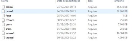

Just use the folder of another kof98 or use any of the homebrw1 homebrw2 or homebrw3 folders. Make sure to put the right fpga file in there.
Thanks again!
