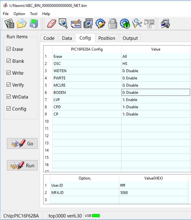

Confirmed working on a top3000 with settings:
under windows 10
note: on windows 10 the gui freezes for a moment and says (not responding) but just wait it comes back once is done.
GQ- 4X4 has no issues
no errors with PiForce Web

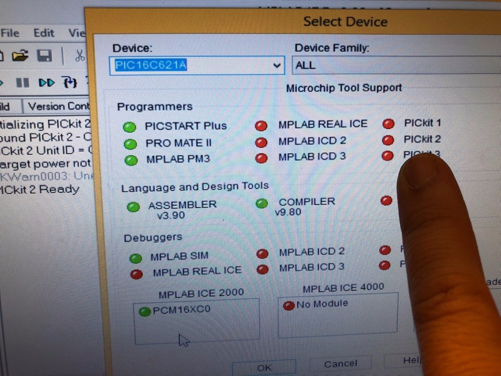

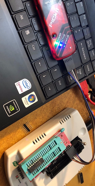

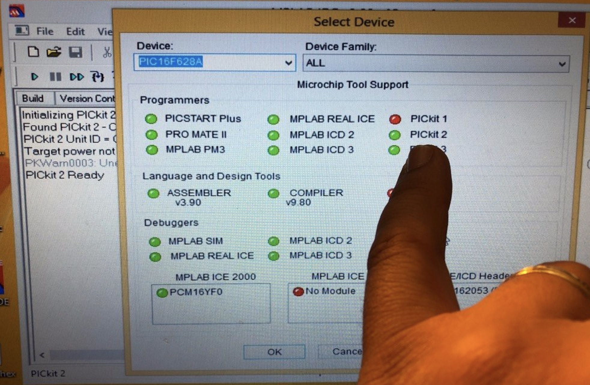

I was looking into why I am still having issues burning a Chihiro Netboot Capable Zero PIC (as opposed to a CF Zero PIC) and I ran across this seemingly interesting comment in the code disassembly at http://pastebin.com/Wn33TXMk
"When programmed with a Wellon VP-280 or pickit2 - it is confirmed working like the original PIC"
I have a PICKit 2, and when I tried to flash an older PIC16C621A or PIC16C622 like many of the original Sega Keys are. I noticed that I was unable to use the PICKit 2, it actually only supports the replacement chip that everyone latched on to PIC16F628A since it was binary and pin compatible per http://wiki.pcbotaku.com/wiki/NAOMI_security_PIC
I am not sure if this is *useful* information, but I thought it may help unravel why some folks are having issues with some of their failed attempts. FWIW the VP-280 lists all three PIC16F628A, PIC16C621A and PIC16C622 as supported. http://www.weilei.com/VP-280list.htm#MICROCHIP

Thanks rtw! Tried a few other Zero Pic bin files with no luck. Yours worked, but needed a little trial and error. Used a Top3000 (via usb only) and tried settings from the OP and trmm, but for some reason it was only writing zeros to the PIC16F628A chip (tried a few different chips) . Here are the settings that ended up working for me:
OSC - HS
WDTEN - 0 Disable
PWRTE - 0 Enable
MCLRE - 0 Disable
BODEN - 0 Disable
LVP - 1 Enable
CDP - 1 Disable
CP - 1 Disable
User.ID ffff
MFA.ID 5068
