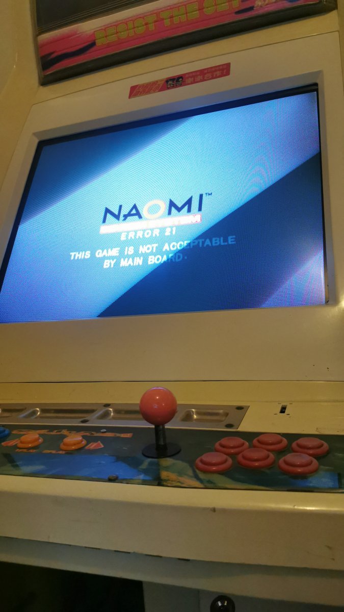

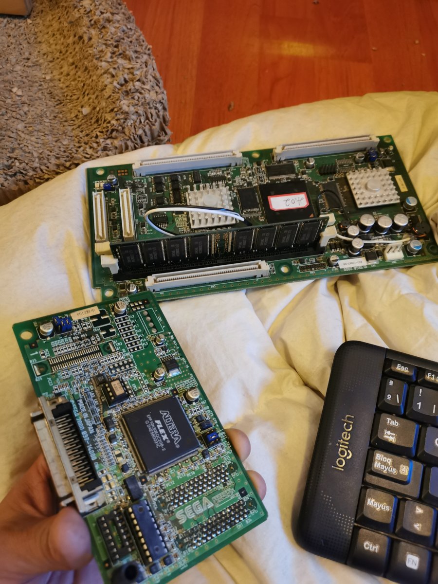

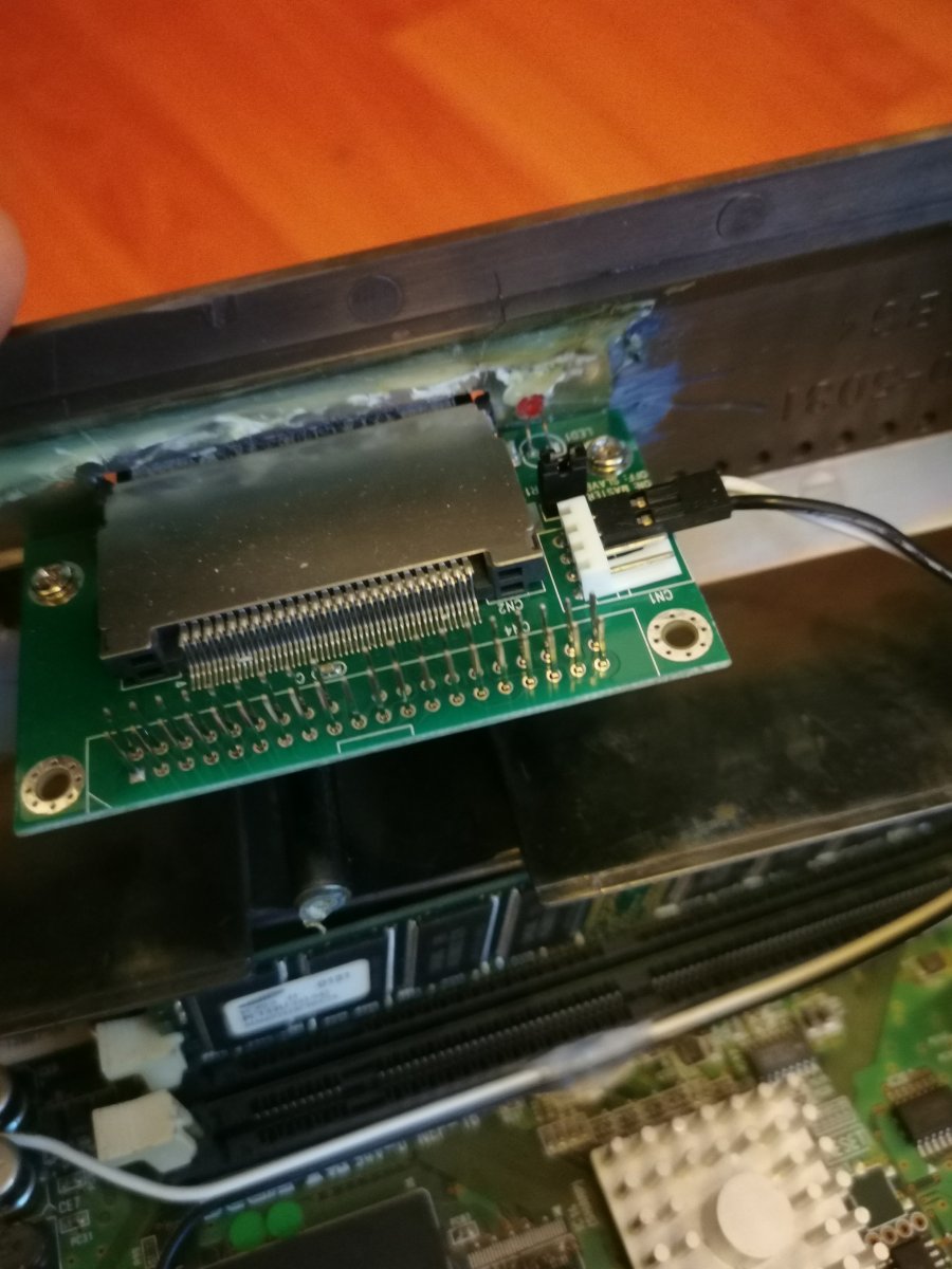

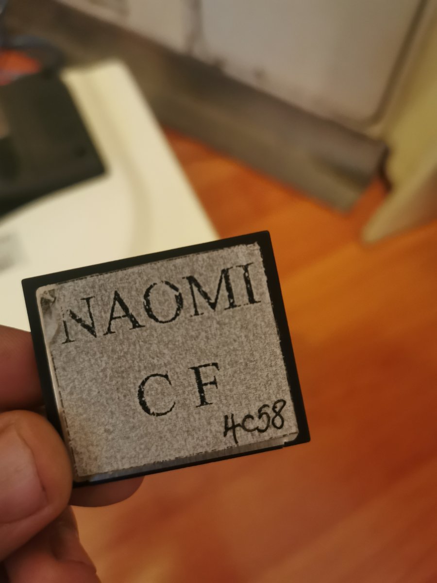

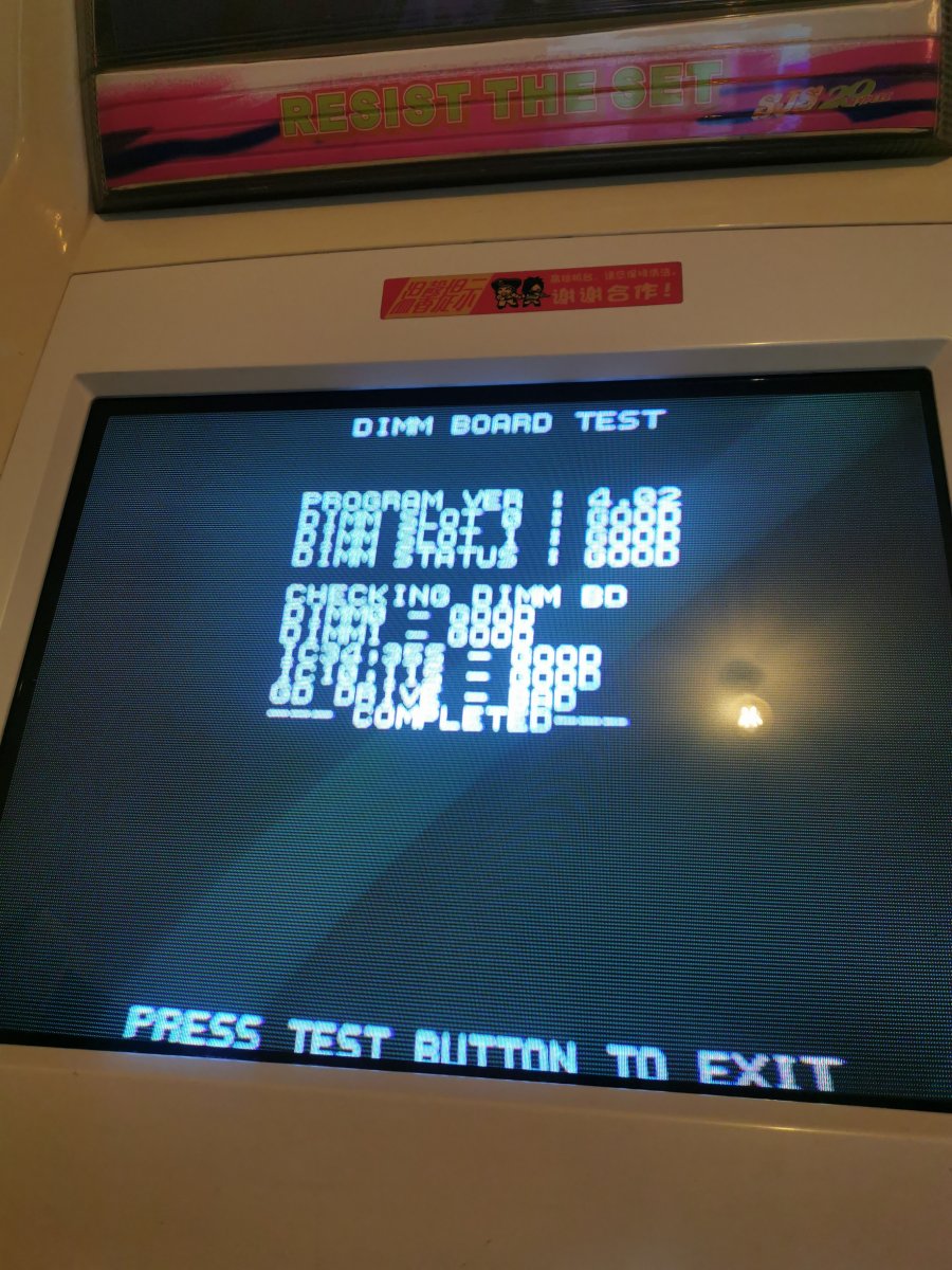

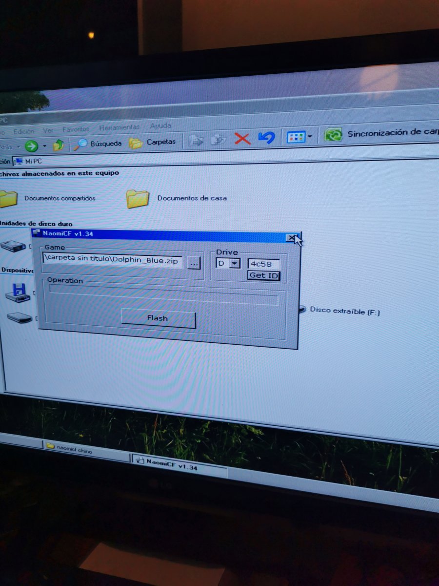

A few days ago I bought a naomi system with dimm firmware 4.02 with CF card, it included the Dolphin blue game, I connected it to my arcade and it worked correctly, I tried to load another game but it didn't work, I downloaded the corresponding roms in the first instance I tried in windows 10 but gave writing problems through usb to Cf adapter, i decided to set up a windows xp virtual machine and install nomicf 1.34, when i pass the game through usb to cf adapter it copied without problem, then insert it into naomi system but it gave me error 26, I decided to build an old computer with native windows XP to repeat the process, I put the key that captured it via ide to Cf with the naomicf 1.34 and confirmed that the key was the same, then I tried again and it happened the same. in desperation I opened the dimm and disconnected everything, applied clean contacts and put it back together .... now I get error 21
