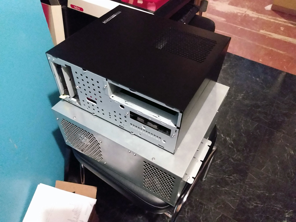

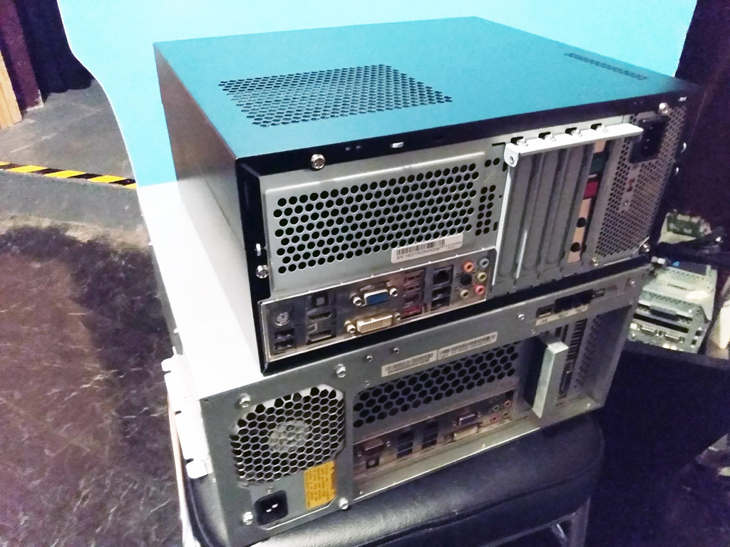

So I've got the In Win BK623 case in and it works beautifully.

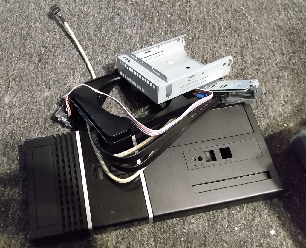

I removed the plastic front panel, as well as the power/reset button unit, the front panel audio/usb ports, and the FDD caddy, all of which simply attach with screws. Removing all of these makes the "front" of the case just flat metal with a bunch of holes in it and shortens the whole depth by about 25mm (~1in). In total this is smaller along every dimension than a TTX3 case, which is what I was going for.
I also bought one of these: https://www.ebay.com/itm/234144626782 It's essentially a PCI plate with power and rest buttons as well as power and IDE LEDs so all of the controls normally on the front of a PC case are now on the back; perfect for arcade use! Of course you could build your own by just drilling 4 holes in a PCI plate and wiring up some dupont connectors to LEDs and buttons.
I'll update with some pics a bit later. So far my only gripe is that there is no good place for a big case fan. The case is actually designed for the CPU cooler and PSU fan to provide airflow through the whole case. The ducting is designed so that the CPU cooler pulls air in then it passes over the rest of the Mobo on it's way to the PSU before exhausting through the PSU. Worst case you could probably externally mount a fan but on a whole I'm not sure it would be needed.
Here's all the Junk I removed:

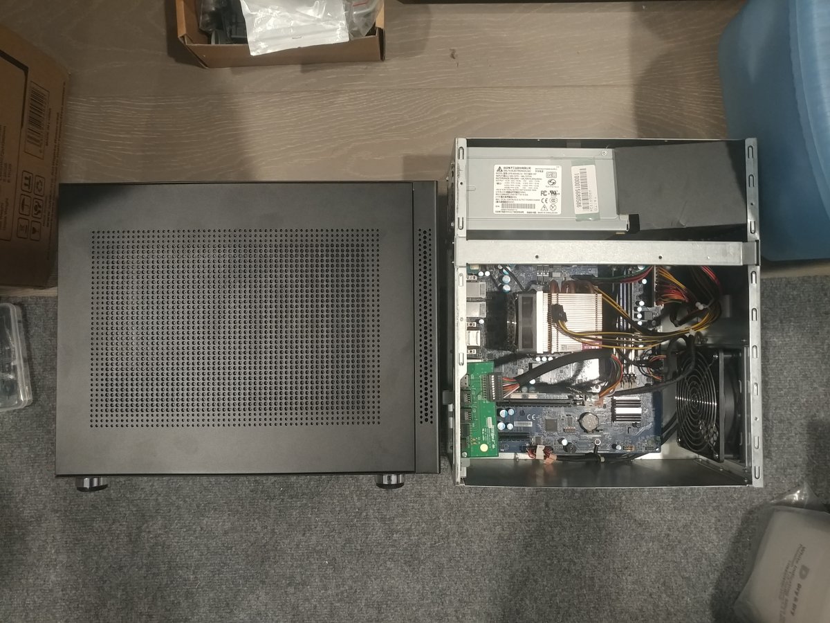

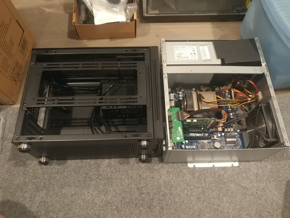

And here is the case compared to a TTX3:

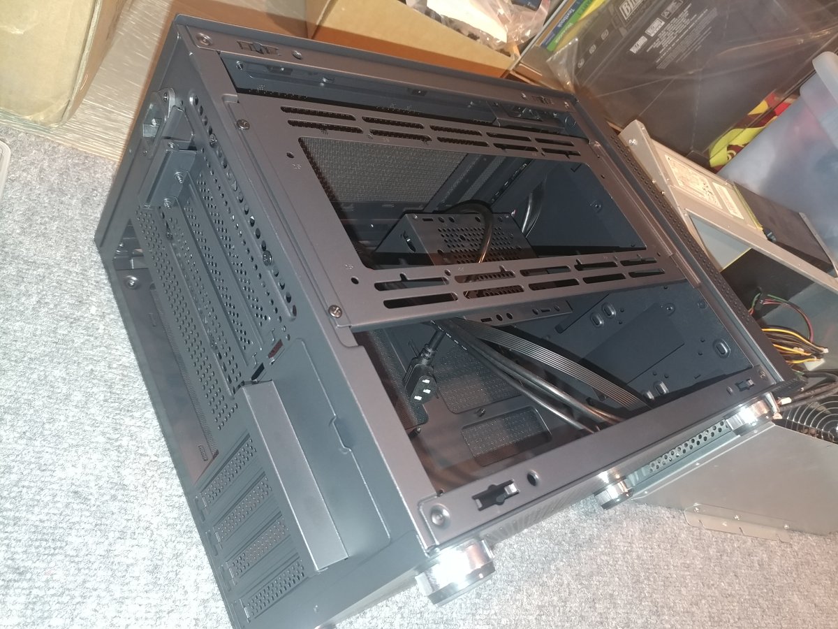

I recently went on the hunt for a replacement case for my TTX3 since my current case is missing the top cover, and the new mobo BIOS allows for better GPU compatibility. I ended up choosing the SAMA IM01 case, which is not much larger than a typical ITX case (like an NR200), but can still fit a mATX mobo and standard PSU.
The case is flat on it's sides, well ventilated, and the panels allow for tool-less disassembly. The optional vertical GPU mount is also a small plus, since I can use the vertical PCI mount spot for the TTX3 JVS/FASTIO port. Considering the cost, availability, and build quality of the case, I'm pretty happy so far. They even included a small plastic case that organized and labeled all the included screws, standoff, etc, which is a nice touch.

It's about 2cm difference if you orient the case 90 deg, and shorter than the stock case. The bigger clearance concern would probably be how tall the case is when it's lying on it's side (~3cm). I can't say for certain how well it fits in LCD cabs because I don't own one (yet).
