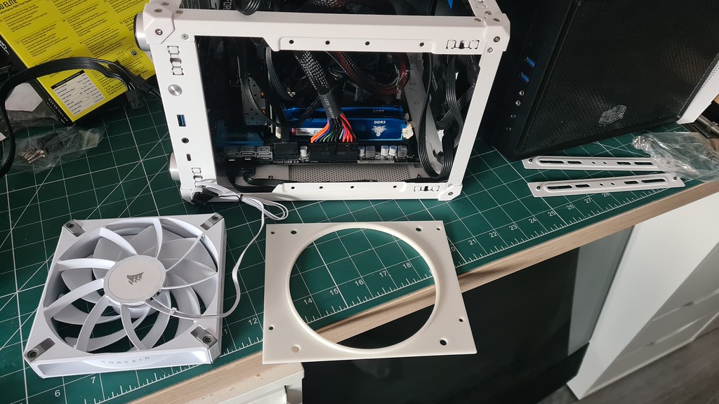

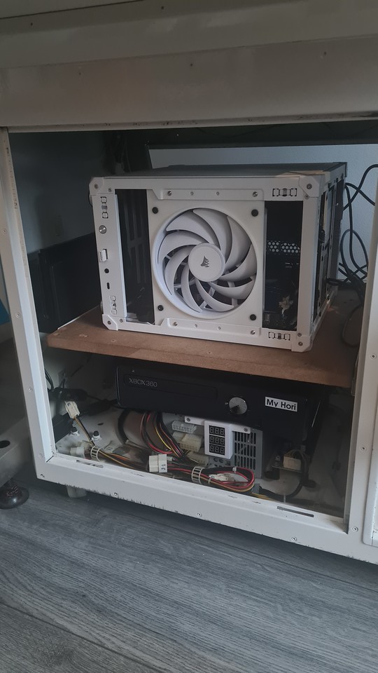

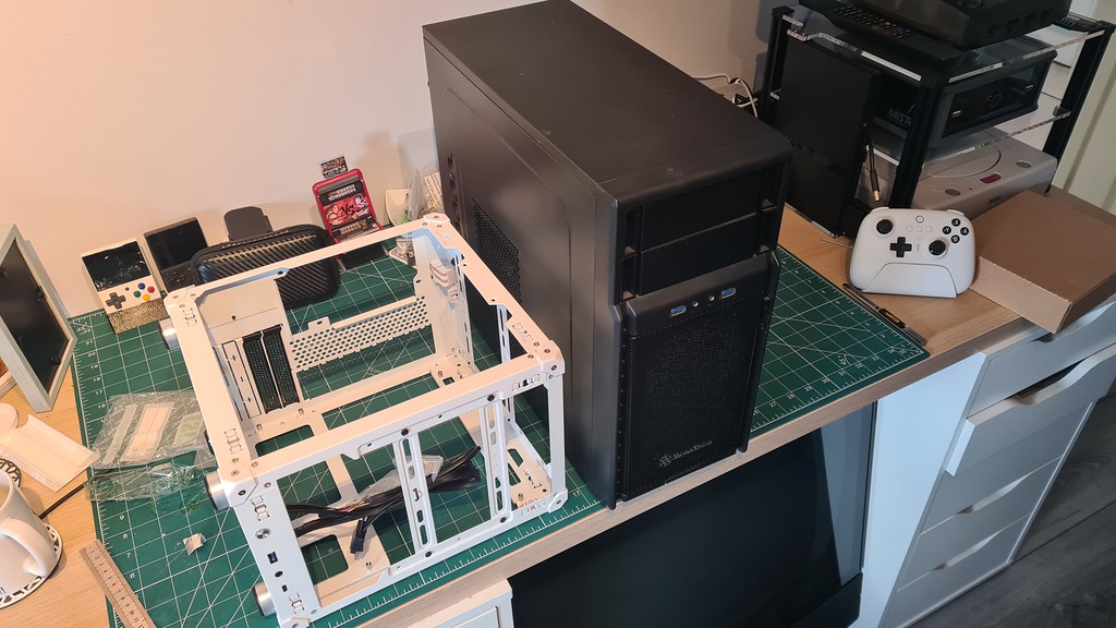

I've been sorting out a couple of mini and micro atx systems for my two Vewlix's recently:
Neither are particular power houses but they're fine for what I'm running at the moment. I've had the PC in the Cooler Master case for a while and it fits in the Vewlixs lovely. The white Jonsbo C6 case was a recent pickup as I needed to transplant the guts from an older PC into it. The below Silverline case was a pretty small midi case (It used to fit in an Astro City) but it wouldn't fit in the Vewlix's.
I made life hard for myself by picking up a used RTX2060 which I didn't realise was a triple width GPU at the time. I had a real hard time finding a case that would fit inside a Vewlix but would take a triple width albeit short GPU and the Jonsbo C6 was one of the few that fit the bill.
Even though the case is perforated all over the airflow is meant to be pretty shit as the holes are so small. Luckily the panels pop on/off really nicely so I've been using it with most of the panels removed. As the case is quite compact there are not too many cooling options and I could only fit a 120mm fan on the front as stock so I made my own adapter plate to fit a 140mm.
I found out since I could get two 120mm fas on the front so that might be an option if I have issues, so far soo good though but I've not really been playing anything too demanding.
There's plenty of room around the case though:

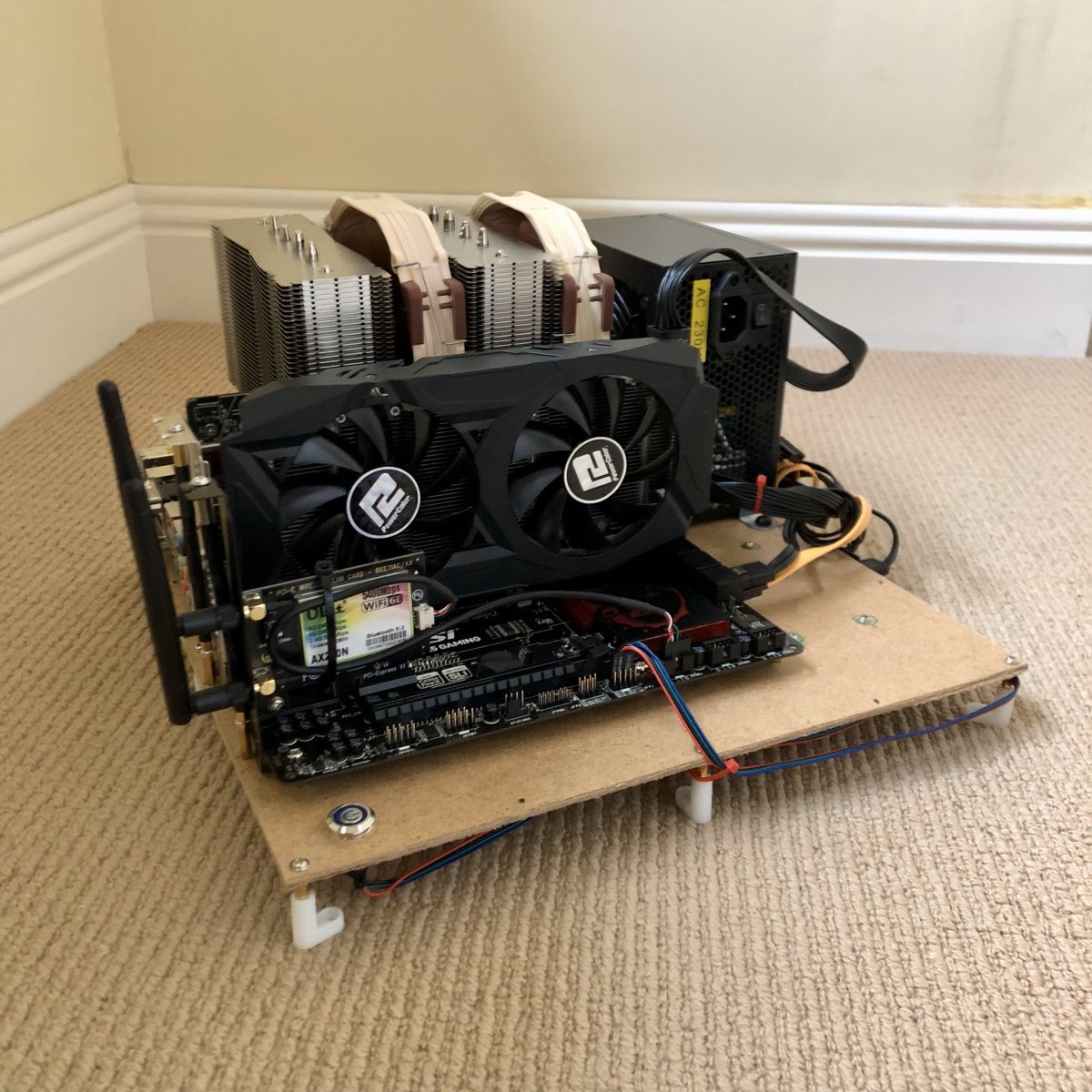

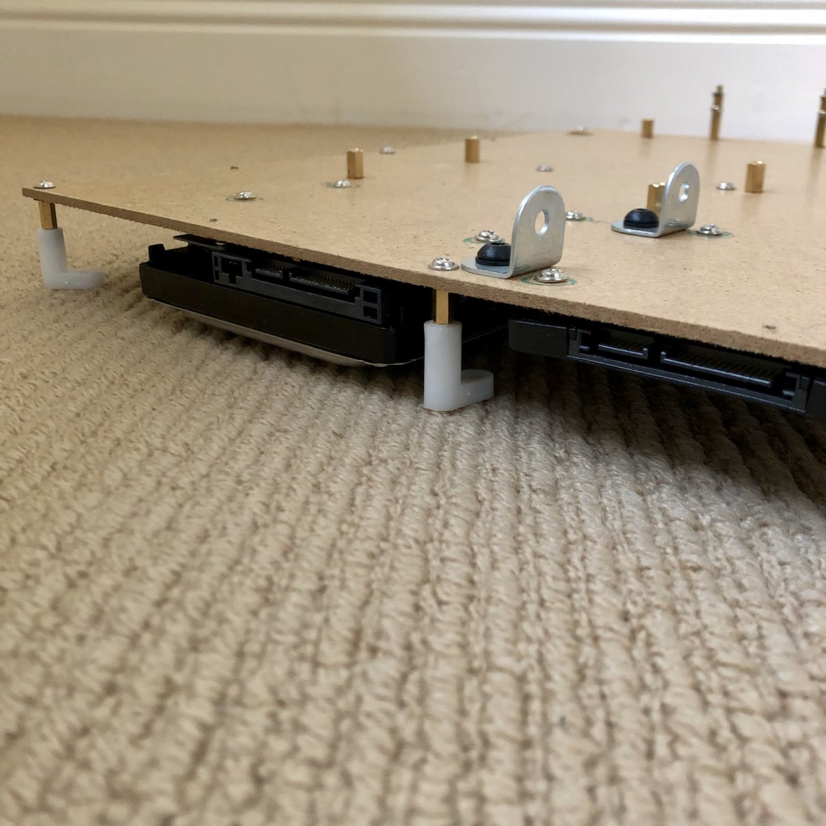

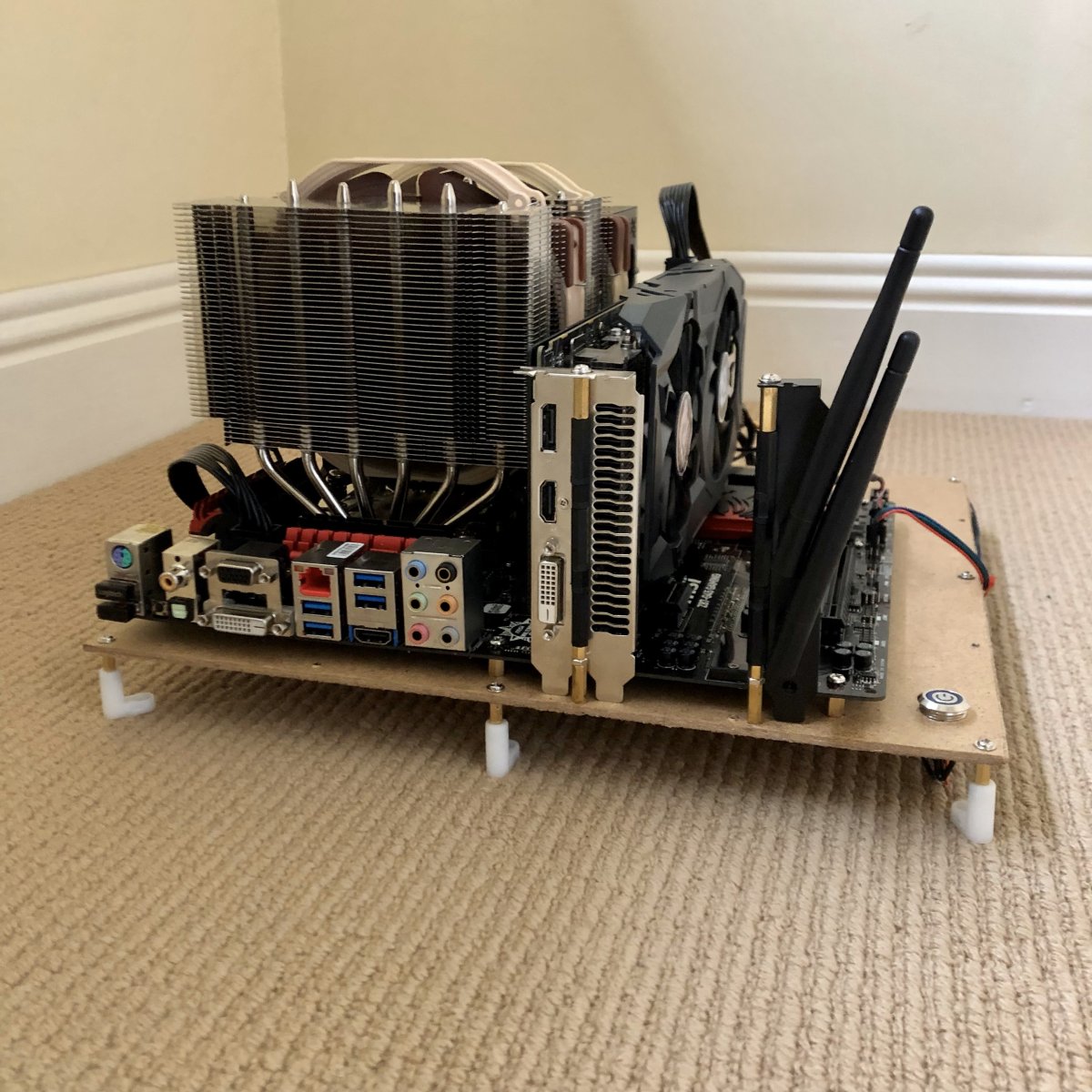

Following the @FrancoB 's size guide, I decide to make a DIY open-case/test-bench for my upcoming Vewlix.
It is a square piece of wood (which is a left back panel from an Ikea bookcase) of 350x350mm essentially, where I designed an ATX PC build installation using fasteners and basic hardware accessories that are always available in my little workshop/gaming-room. I did a basic build as you can see from the following pictures which includes:
- Gaming ATX mobo with a proper CPU cooler, graphic card and WiFi/Bluetooth card installed;
- ATX PSU;
- No.1 HHD + No.1 SSD installed to the bottom;
- Power switch button.
There is room for an additional i/o board or hard drive, but I stay simple for now.
They are all second-hand components except for the PSU and SSD.
Perhaps it can be an inspiration for other users... I can wait to install it inside my Vewlix!
