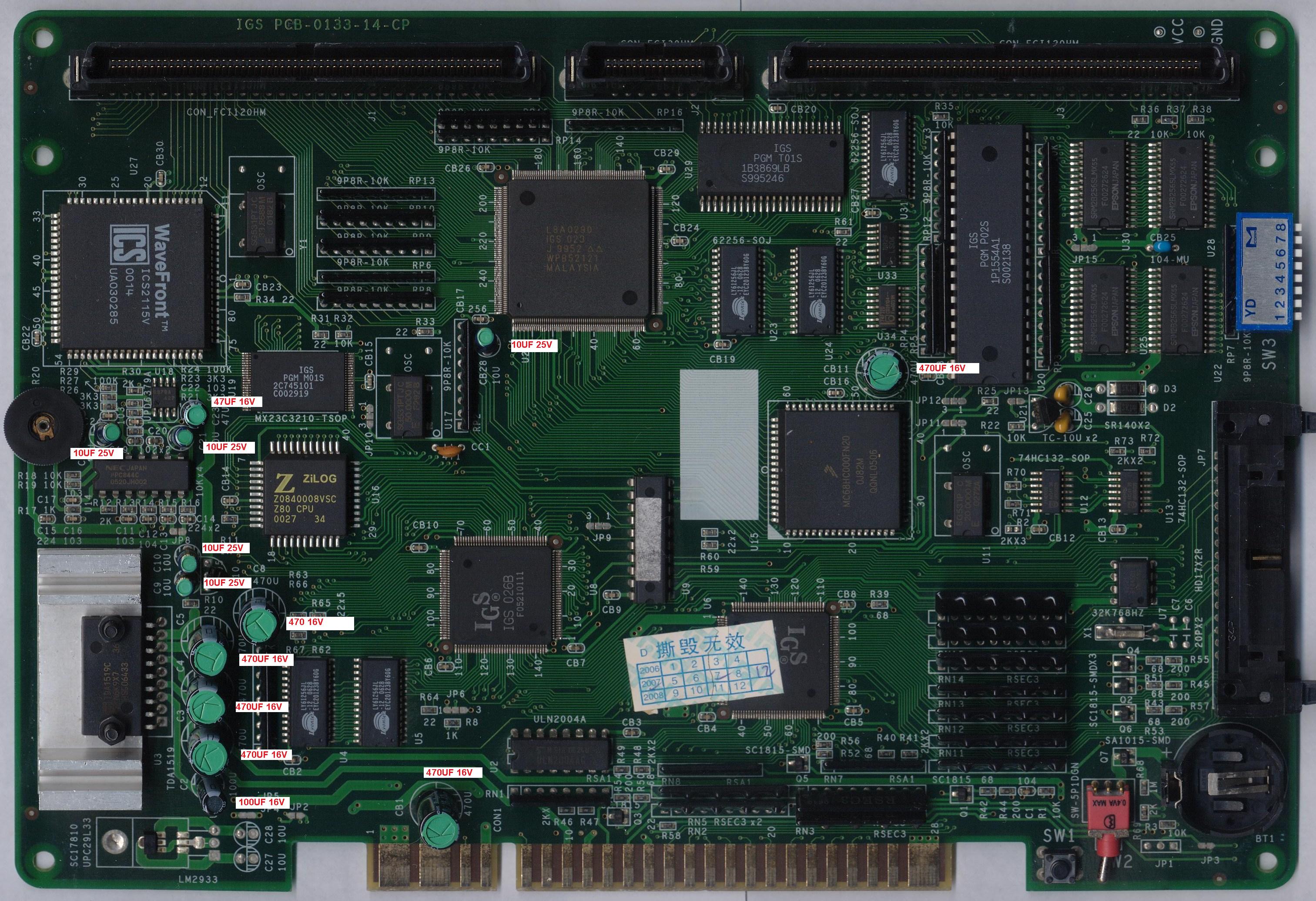

Sir , is somewhere a cap kit to buy for a rev 14 revision ? or did u make it one ? ... because i'm thinking to replace the existent board caps. ThanksUpdate 28.

I just did my own cap kit... There is only 3 or 4 different values. If your stuck i can look at my 14 and tell you want you need??Sir , is somewhere a cap kit to buy for a rev 14 revision ? or did u make it one ? ... because i'm thinking to replace the existent board caps. ThanksUpdate 28.

Will be awesome Tim, because i will make another order from digikey or mouserI just did my own cap kit... There is only 3 or 4 different values. If your stuck i can look at my 14 and tell you want you need??

OK.. i work today.. So will try to do it between Monday to Wednesday... When i have time off.Will be awesome Tim, because i will make another order from digikey or mouserI just did my own cap kit... There is only 3 or 4 different values. If your stuck i can look at my 14 and tell you want you need??

A "Cap Map" for youWill be awesome Tim, because i will make another order from digikey or mouserI just did my own cap kit... There is only 3 or 4 different values. If your stuck i can look at my 14 and tell you want you need??

Yes , Nichicon is an OK brand... still heaps better than whats on the MoBo to start with!!!Good morning @T. Sir , are these capacitors good ? I've made a bom who will maybe help another guys too :
-https://www.digikey.com/product-detail/en/nichicon/UHV1C471MPD/493-15298-ND/2598248 (6 pcs)
-https://www.digikey.com/product-detail/en/nichicon/UPV1C101MGD/493-17683-ND/2600289 (1 pcs)
-https://www.digikey.com/product-detail/en/nichicon/UPW1E100MDD6TP/493-11347-1-ND/4319945 (5 pcs)
Cheers
Yeah brother , but in my head are only Nichicon brand (it's easy when you have on hand a esr meter to know exactly the value of capacitors you wanna change) ... if you're in my place you will go on the Panasonic or Rubycon route?@AlxUnderBase - I've seen Panasonic, Nichicon and Rubycon capacitors being highly recommended in arcade repair logs / tutorials. I don't think you can really go wrong with either of those brands.
