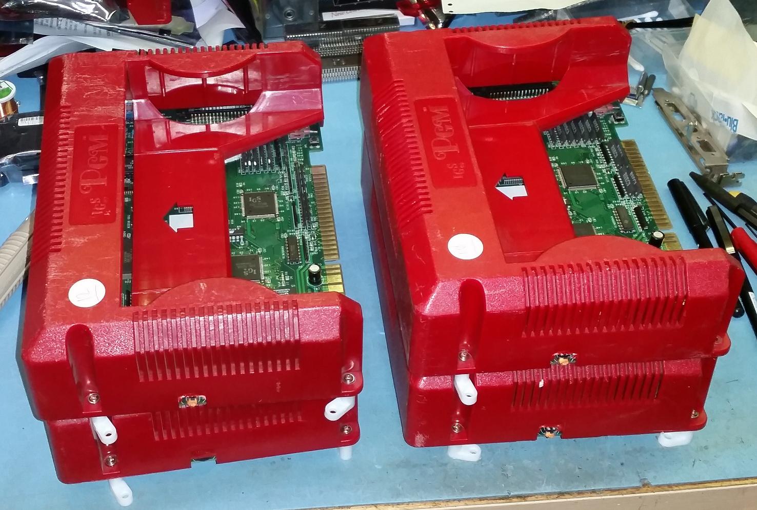

Small update on the pre-modded PGM MotherBoards i will be selling....
First 4 Motherboards arrived from China.... 3 more are coming as well.... Time to test them...
