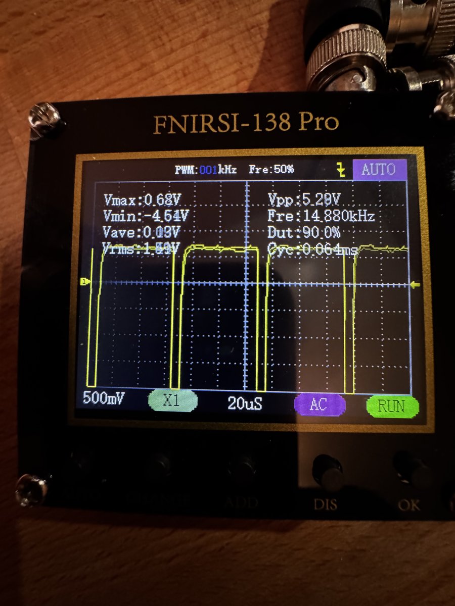

Direct output from the pgm, no sync regen.
This is my first experience with an oscilloscope, so not sure if I have the range and everything set correctly. . . . or what I should be looking for in terms of interpreting this output.
So, knowledgable arcade peoples of the internet- does this waveform look weird?
In my experience the PGM sync signal is pretty out of spec, and certain consumer CRT's wouldn't display an image with a supergun. The jrok sync cleaner didn't help. For the most part, you need to have a CRT that isn't picky with it.
100%, only thing I will add is that some PGMs seem better than others, never been able to work out why
yep, that other thread had some differing results with earlier vs later HAS superguns, too, but given that I'm using a BVM that's known to be a punk with syncing to difficult sources I'm really not going to be surprised if I can't get this to work- having the IGS on my flat panel displays for now is keeping me happy and there will be other CRTs in my future- there's a sony 20f1u for sale near me right now that i've got my eye on (price is crazy though, so it's been sitting for a few months) and a couple of mitsu diamondtron 2030's near by too- I might bring the IGS to see those and see if they get along or not.

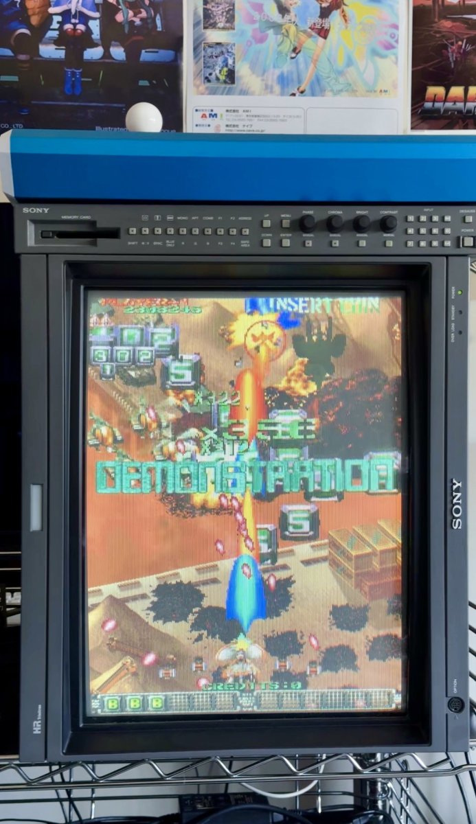

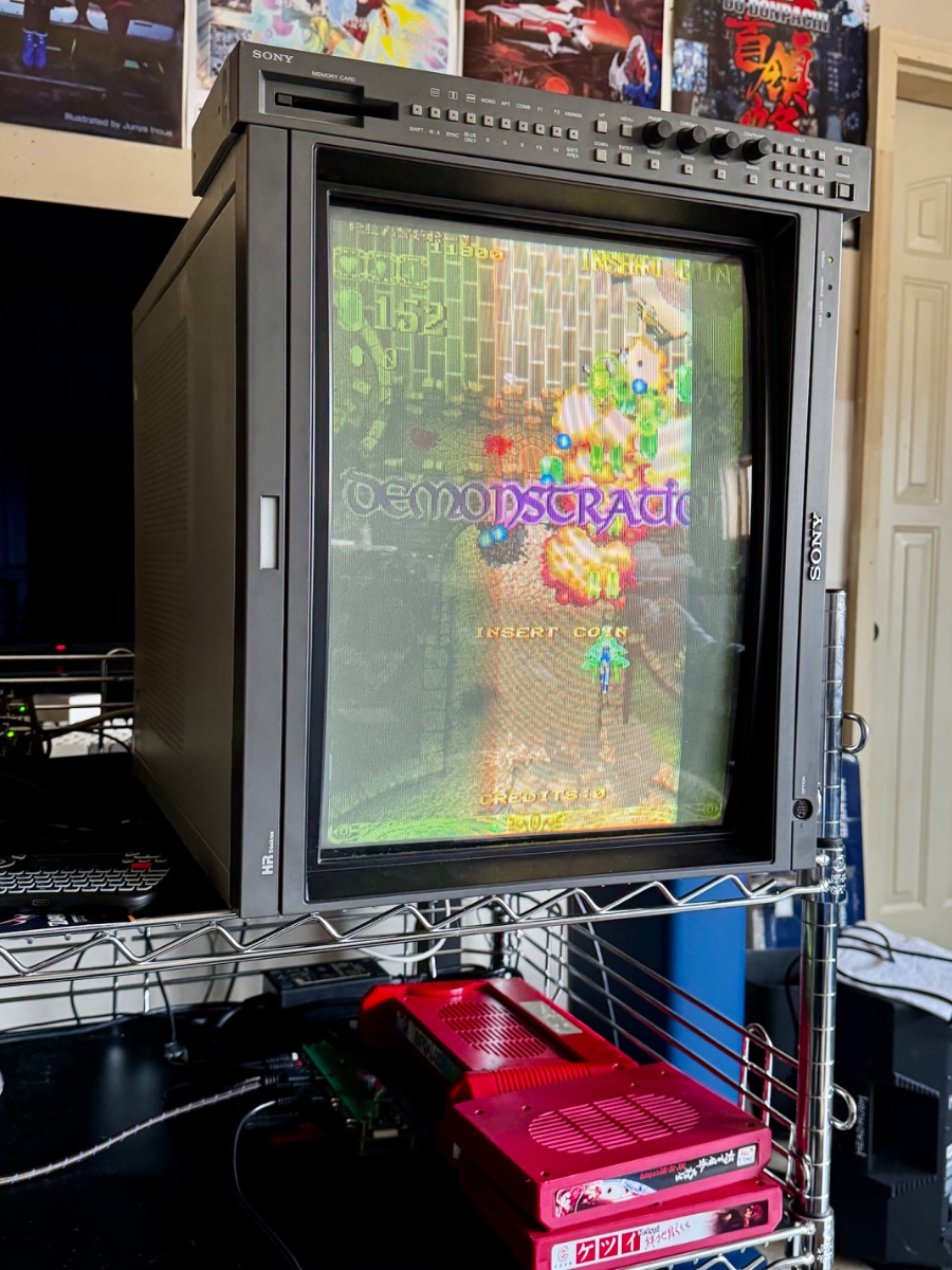

been a long time!! Busy few months on my end but I was continuing to work on getting this to sync to the d14- tried a sync strike at the end and even that didn’t help.
I did find a solution though: bought a 20f1u! Syncs perfectly to everything the d14 refused to work with.
