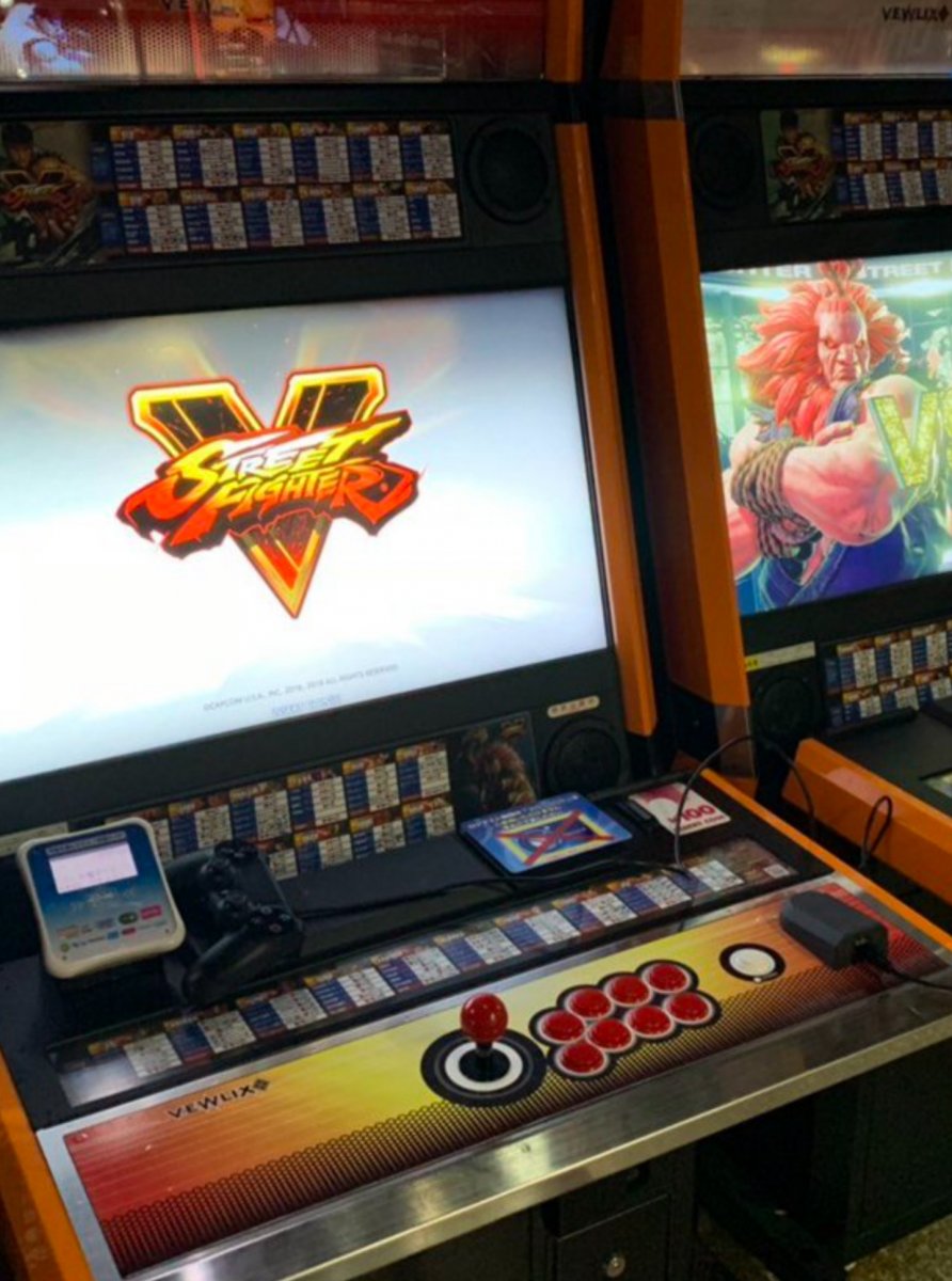

I would love to share my vision to building my Street Fighter V: Type Arcade Machine. I have started to assemble the parts as this will be an ongoing project for probably more than a year...
My inspiration for how I want it to look is shown in the pic below that I saw in a Japanese arcade but wanted a 2 player version, similar to my Street Fighter IV: Arcade Edition Chewlix/Vewlix, (pic below). (Yes, I know for the time being, there is only a 1player version...more on that later)

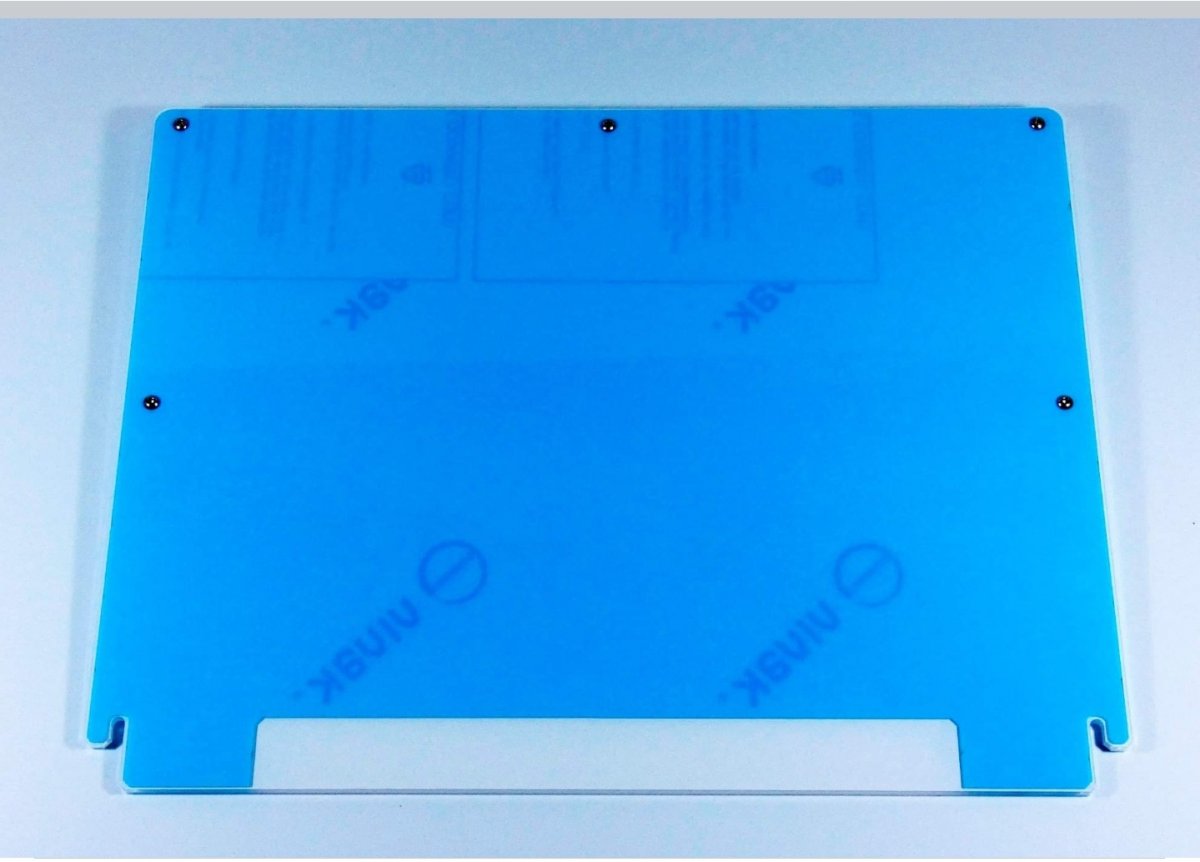

-Acrylic Marquee Topper (Should arrive July) Ordered from Erik Goetheer on Facebook

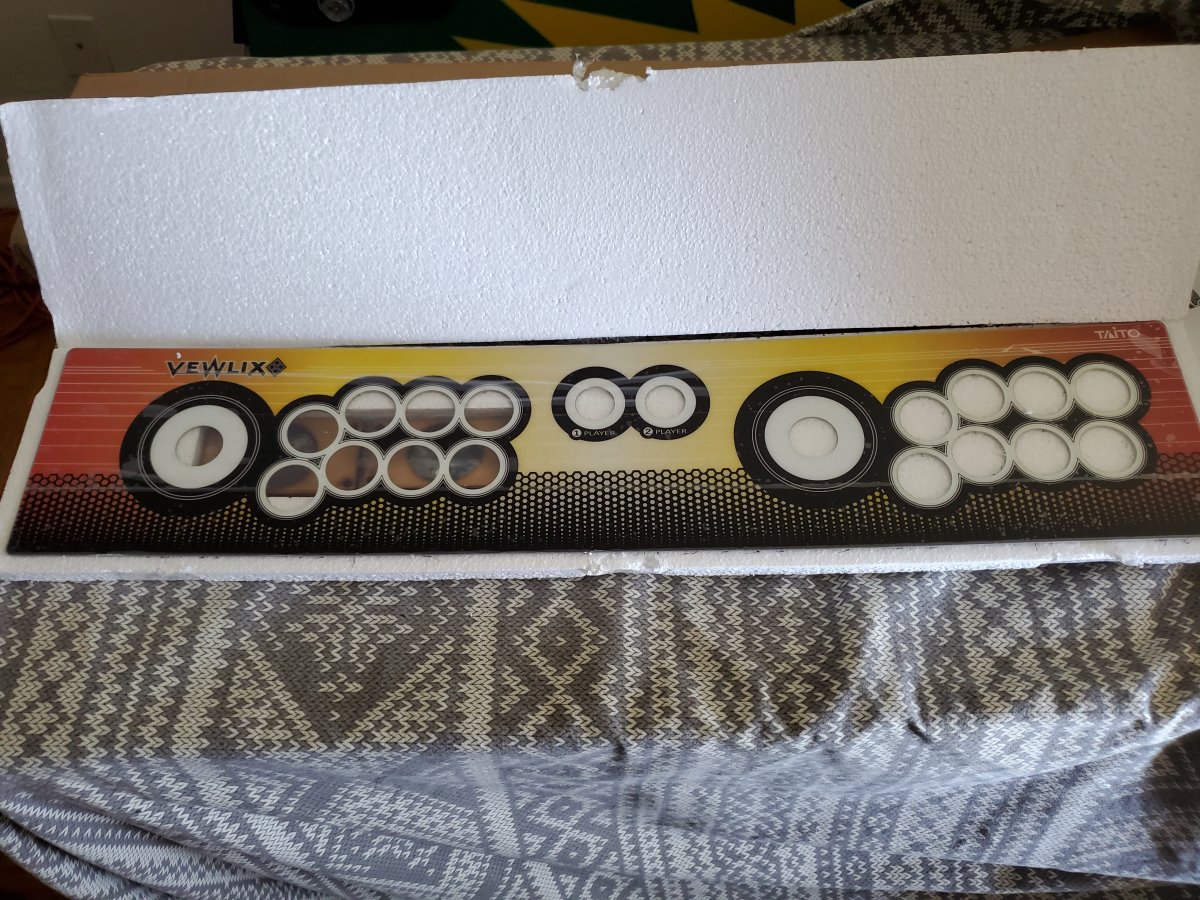

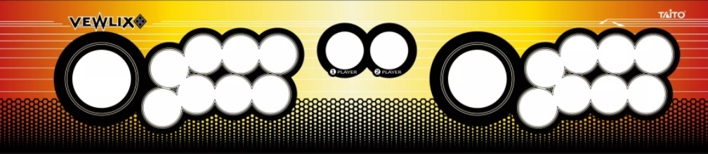

-Custom SFV:TA 2 Player color CPO made from Rafael Tamanini on Facebook

I want the Taito Type X4 cause it's original hardware. Similar to my SFIV:AE, though it's a Chewlix, the games hardware, buttons and monitor are authentic, so gameplay is 1-1 the arcade. I will absolutely love the cabinet as I do my SFIV:AE. I have 0 interest in original Vewlix as this is for my own arcade/home. Other than thinner metal and cheaper internal components (amp,speakers, which I can change to the same ones used in vewlix), I like the Chewlix color and price better, personally. It wouldn't be authentic regardless of the cabinet as I want the 2 player version and the originals are only 1player. Honestly, the only thing I need is SFV:TA hacked like SFIV:AE was to play 2 player and have the characters unlocked and I'm good. Plus, there is someone online I have been following that also added Fighter EX Layer, Samurai Shodown (new version) and other games and would love a multi game, like my SFIV:AE that has many great games. Thanks for your feedback and I will update this thread once I get more info and parts
