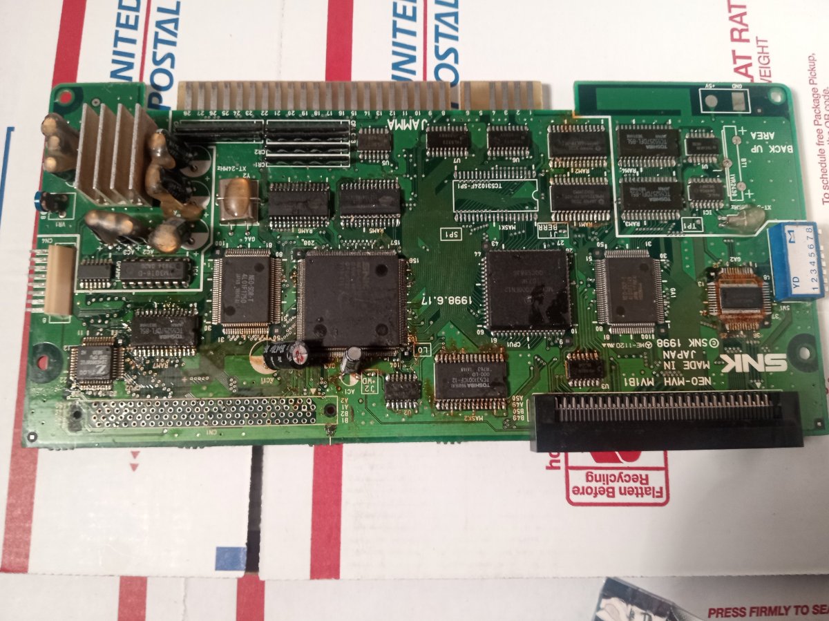

I was wondering if anybody had a spare pair of the MV1B adapter boards in the photo provided.
Any help would be greatly appreciated.

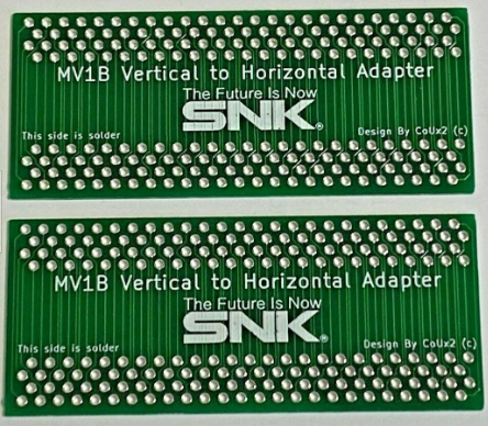

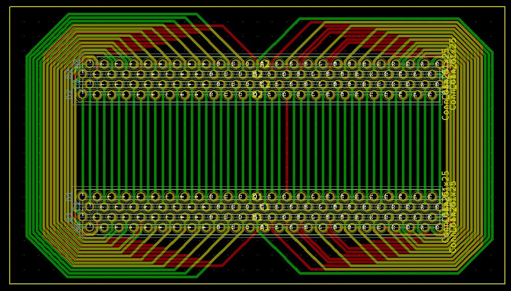

The gerbers for the original design were released here some years ago. Maybe someone grabbed them. Otherwise I'll dig for them if you want to have a few printed.
[EDIT]
From 2019, gerbers in attachment, credits Apocalypse.

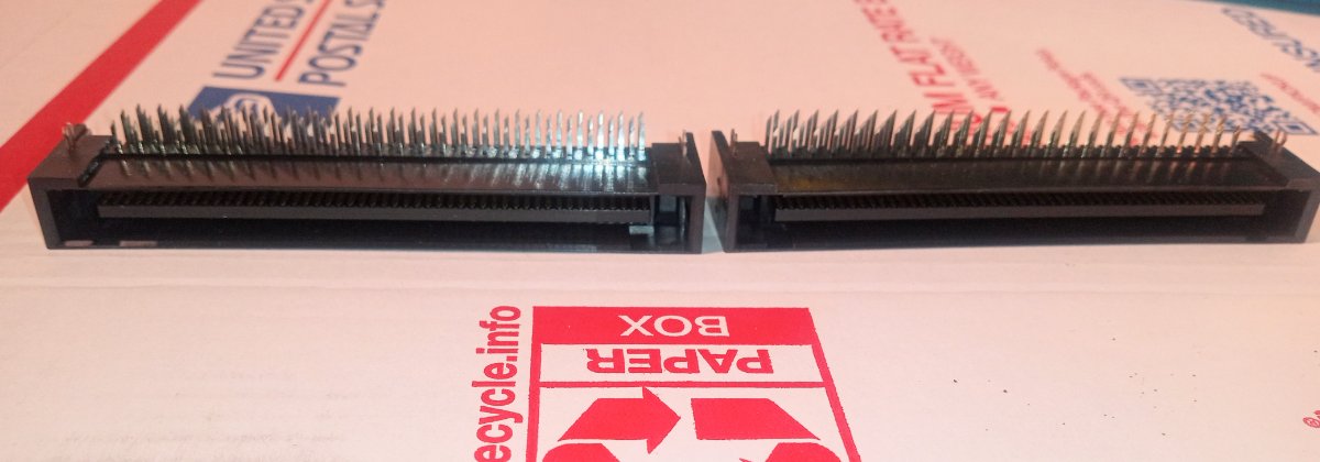

The connecters have arrived!!
They cost approximately 18.00 shipped and about a week and two days to get to me so now what I will do is remove the original connecters from the main PCB once again and install these.
The problem should be resolved and these connecters will ensure a stable connection between mother and daughter board lying flat.
Any daughter board corrosion or not will/should make a solid connection between the two.
I will return after they're replaced.

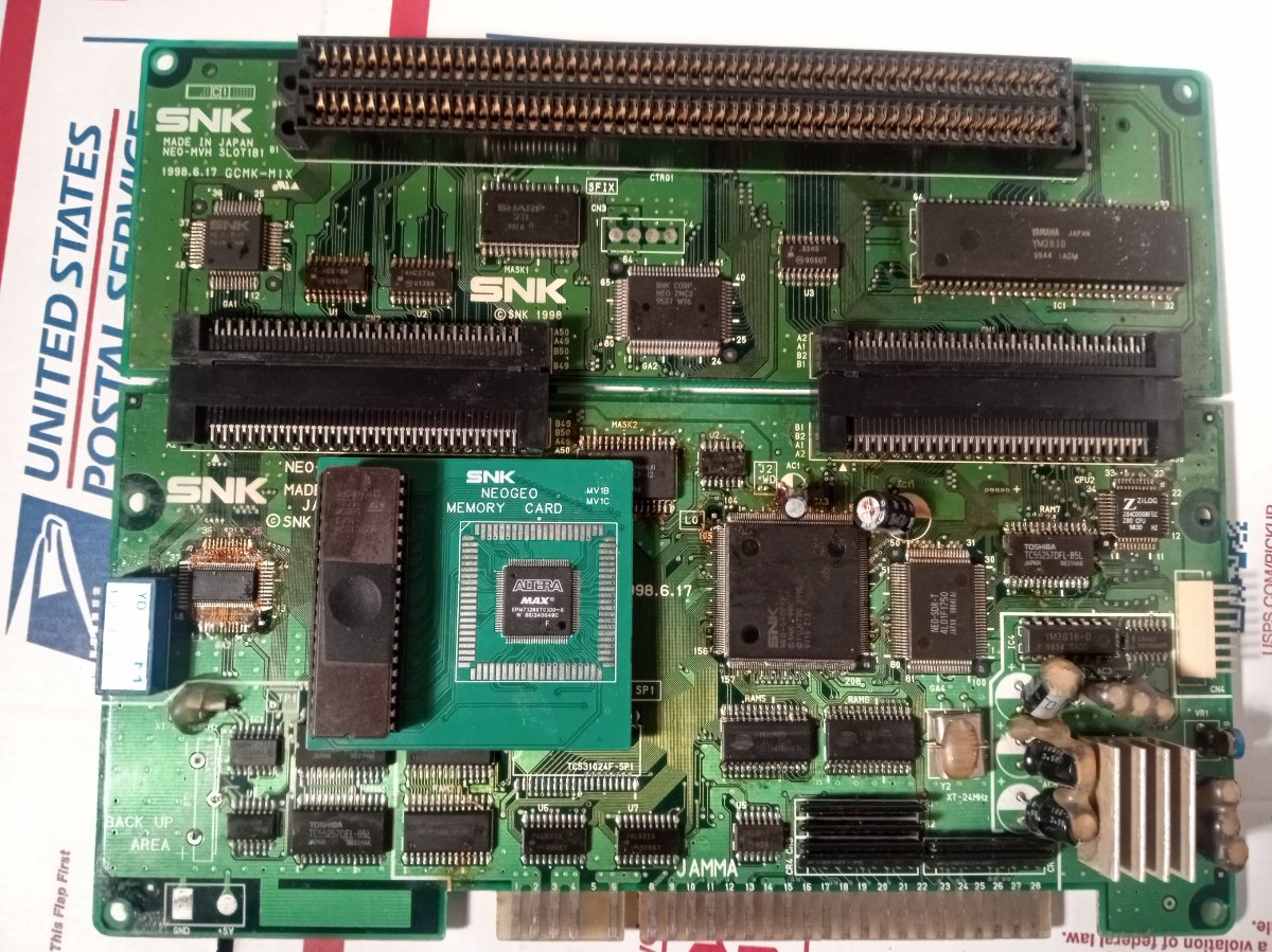

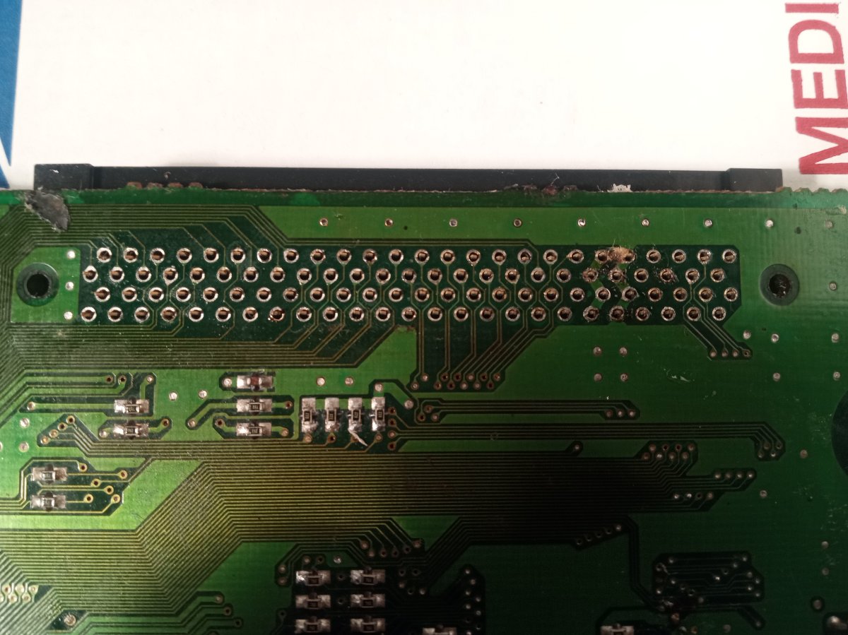

Alrighty...done deal and she works perfectly right away.I had to remove the reinforcement pins on the connecters because they will not align properly with the board.
I prefer these over the pcbs only because I went through a great amount of hassle and wasted a lot of time trying to make a solid connection and failed.
This looks good and no worrying about corrosion and or cold solder joints.
