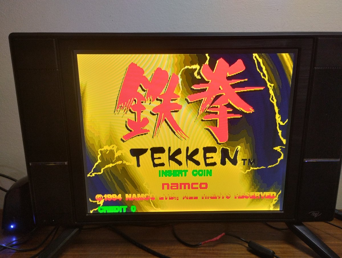

Blue is back!
I traced the signal back from the Blue JAMMA pin, past the filter, up to TR9 and TR10 on the Mother PCB. I was convinced it was the NPN Transistor at TR10, so I replaced it. Didn't do the trick.
This wasn't very encouraging for me. I then used your schematics and managed to make a turn on the CPU board, figuring out the DAC (the PG11 has a Sony DAC) and the VRAM. All were toggling fine.
I took some time off to think about it. Watched some YouTube videos and tried to understand NPN and PNP transistors and how to test them properly.
If not TR10, it had to be TR9, right? Took both of them off and tested them properly out of circuit. TR9 was dead. Replacement did the trick.
Man, Tekken might be old, but it still looks so pretty =)

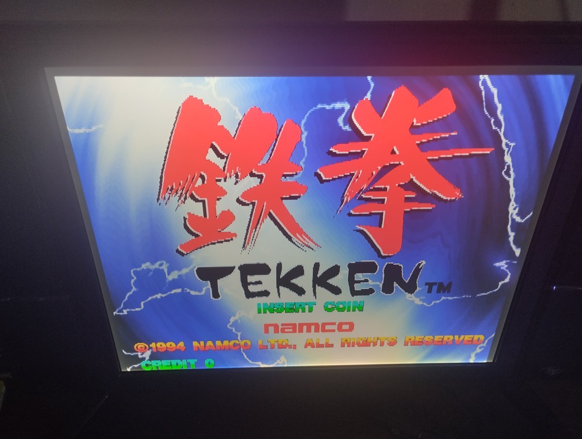

Ok, Managed to get an osciloscope to debug my Circuit. My Q202 Transistor appears to be the problem since it outputs less voltage than their similar counterparts even tho the base of the transistor were getting the same input on all 3 color channels.

Disregard that last message, I found the culprit. It's the L203 Inductor. It barely lets a voltage pass.
If anyone knows with what to replace it, I would be deeply grateful.

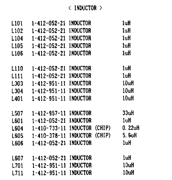

Ok, After some experiments (and getting my hand on a frequency generator from the '70s), I determined that the inductor used in L201,202,203 has a value of 10uH. Please update the schematics to add this info.
EDIT: The SMD packet code size is 2520, based on the inductors used in the PS1.
