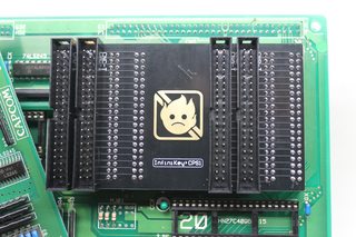

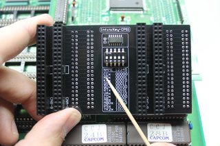

It's happening, boys. InfiniKey-CPS1 will handle C-board (C.P.S.-B-21 chip) encryption key writing.
CPS1 games that only have encrypted C-board:
*Capcom World 2 [TESTED]
Captain Commando [TESTED]
King of Dragons
Knights of the Round [TESTED]
Quiz & Dragons [TESTED]
Three Wonders [TESTED]
*Varth [TESTED]
*Light gray plastic cases do not have enough room for InfiniKey CPS1

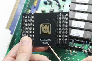

Q-Sound games from that era (aka CPS Dash, CPS 1.5) that have both C and B-board encryption (yes, double suicide action):
Cadillacs and Dinosaurs [TESTED]
Muscle Bomber / Saturday Night Slam [TESTED] Masters [TESTED]
Muscle Bomber Duo
Punisher [TESTED]
Tenchi wo Kurau II / Warriors of Fate [TESTED]
These will use the "Q-Type" version (more compact so it will fit inside case, but lacks keyed connectors on top so requires more care in installation)

Does this require any modification to the game PCB other than soldering on the CPS1 infinikey (as in no trace cutting/etc.)? I didn't think it was possible to write a key to the C board while it was attached and unmodified.
No mods to original hardware. It will make more sense to you when I get photos of the protos.

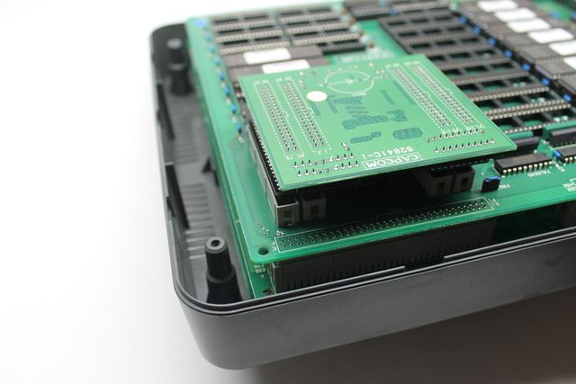

Just waiting on some parts (I realized I needed lower profile connectors in order for the CPS1.5 board stack to still fit in the case) and then I'll be testing on a friend's Punisher and someone is sending me a Tenchi wo Kurau II.

Derick2k's Varth really helped me refine my program because I learned that some CPS1 games interrogate the C-board processor very early on. My Knights of the Round and Captain Commando to not do this. Also, sadly I discovered that the light gray cased games, Varth and Capcom World 2, do not have the head-room necessary to fit the CPS1 InfiniKey inside the case :( :(

Not sure what UD means by not enough headroom in the case though, really keen to see how this thing works

It is, but this will I assume need to be soldered and desoldered rather than the connections you make with an Arduino so it's really more of a permanent solution
Nope! No soldering on this one :)
It's pluggable so it adds height to the board stack. Anything with a case only has so much room inside.
