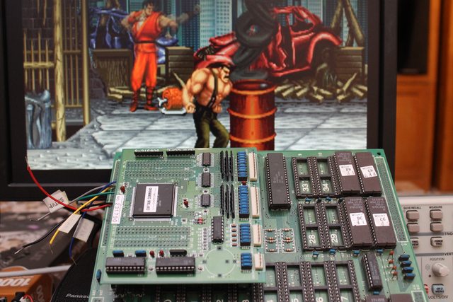

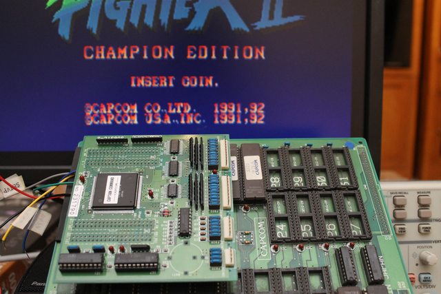

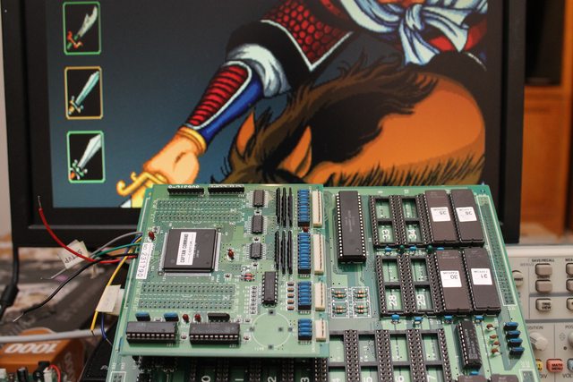

Multiple people have inquired about adding to InfiniKey CPS1 the keys to configure a Battery B-21 to behave as all other B-XX chips. I don't know if I will support this upon initial release, as I have simply don't have a game for each B-XX chip type on hand with which to test. Here I've verified what games I do have on hand using a Captain Commando C-Board with InfiniKey CPS1:
As No Battery B-21 on SFII' CE
As B-17 on SFII:WW
As B-13 on Magic Sword
As B-04 on Final Fight
As B-02 on Dynasty Warriors
-ud

Eduardo made a pretty in-depth video detailing which data goes where, back when he released all the info on the Arduino revival kit. He had a few boo-boos in his presentation, but with some educated guesses I was able to sort it out. MAME source (God bless those people) actually has all the critical information that makes up the keys, but it must be massaged differently in order to be loaded into the B21. And within that data, there are a few key bytes that can be massaged one way or another, so you really have to test it to find out which way those bytes are supposed to be. I wish it were as simple as just writing a script, load in the MAME data, and call it a day, but it actually requires a bit more hand-holding than that.
