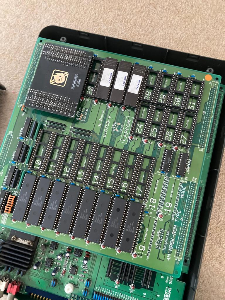

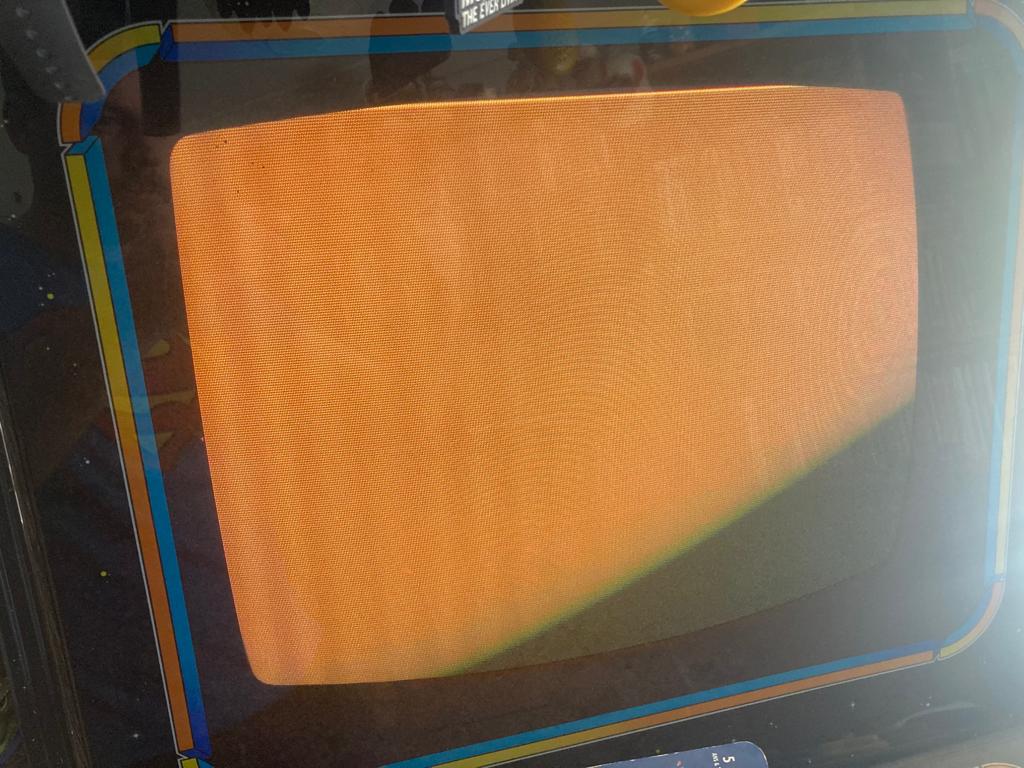

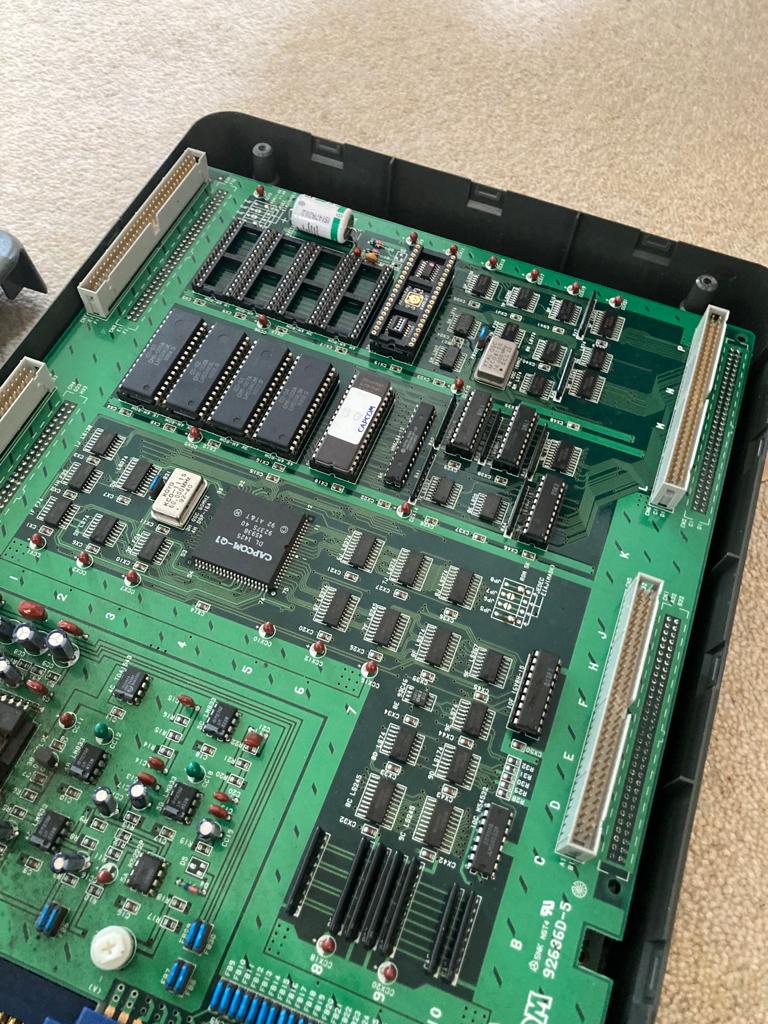

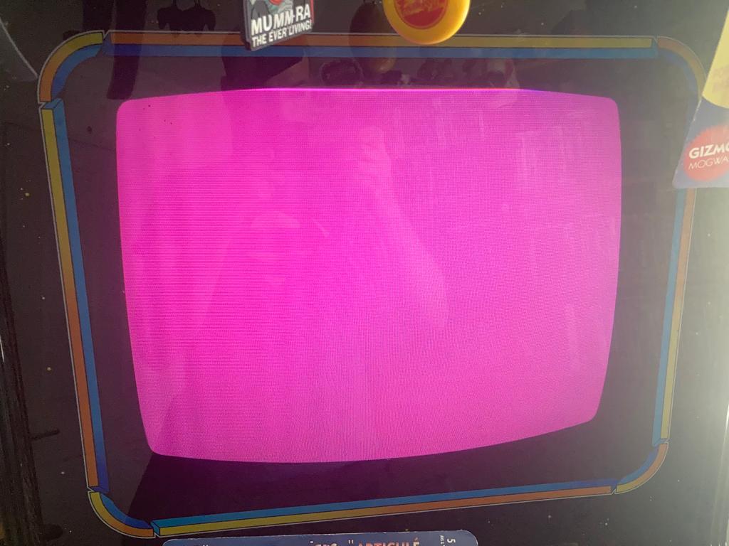

I knew there was a reason I got these! My batteries were replaced in 2017, so I thought i might have a couple more years left.
Before:
3365ea26-d687-4b3c-8f31-f14f12d85bed.jpg 1ef60df3-9de9-4507-9692-bd476a62c960.jpg
During:
ccb33044-358e-4a57-abe5-42f2093490e8.jpg c89601a6-7ef6-4eca-9233-d08804b686f4.jpg
After:
Thanks @undamned, worked like a charm. :thumbup: Now I just need to decide whether to get a couple more batteries, or leave it as.
Hopefully there'll be more stock of these in due course for those that are after them.
