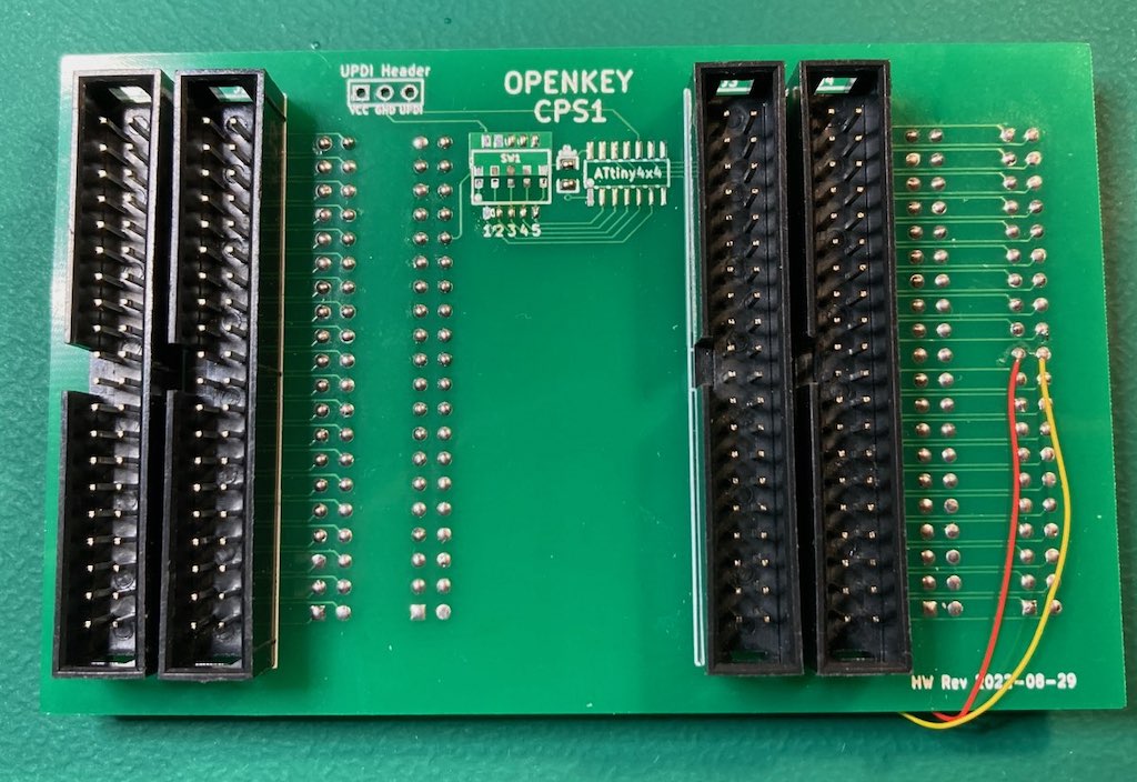

In May/June I got my hands on bunch mitchell boards that were in need of desuiciding.
The plan was to put infinikeys in them can call it a day, but turns out there was no stock of infinikeys. Undamned hadn't logged into the forum since late last year, so seemed unlikely there was going to be new stock. At the time I didn't even consider trying to make my own and started looking at doing the dead battery society mod instead.
Mid-July I bought sbbros from a forum member that had an broken infinikey in it (ended up being a bad dip switch). Looking the infinikey over it was just a MCU and a dip switch for picking a game. I decided to read up on the process of how to reprogram and found Eduardo Cruz/Arcade Hacker awesome write up.
I initially built his out of socket arduino based programmer to confirm I was able to get reprogramming working at all. After that worked, I breadboarded up a attiny MCU and a dip chip test clip to work on programming the cpu on the fly when powering on the board.
That plus writing the firmware for the attiny took about a day to get a working on a single game. The next day I added the dip switch to allowing picking games. This ended up being a pita. I thought I had some firmware bug as some games worked and others didn't. I eventually figure out the dip switch that I had pulled from a cps1 parts board had a bad switch on it. I also spent a far bit of time figuring out the timing of when the attiny should start programming after it gets power.
Up to this point these were all similar things I've done in the past on other projects, but I've never done anything related to creating a pcb. I spent a couple weekends learning up on kicad and all the different lingo related to having pcb's made. Got a very basic PCB made in early August.
It worked, thankfully.
Continued learning more kicad and making numerous additional revisions. I'm currently at this
For someone that mostly programs, 1-2 week turn around on being able to test a new pcbs is brutal. I burned almost a month going through a couple revs to get the solder jumpers to where they were easily jumped.
At this point I think I'm mostly done. My plan was to throw this up on github, but it feels like a bit of a gray area since its obviously looks pretty similar to the infinikey. So looking for a some feed back on that.

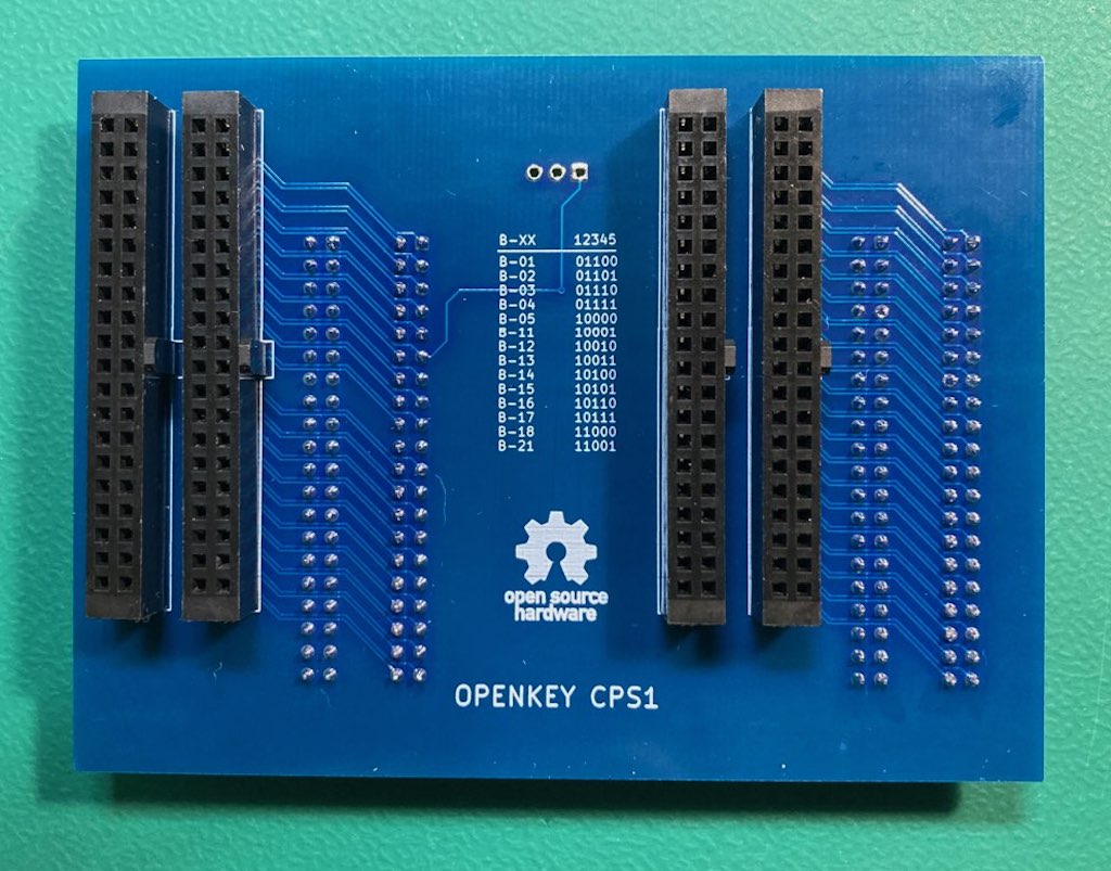

I actually started working on a cps1 programmer a little after I started on the kabuki one. I was going to need something so I could test openkey-kabuki on a cps 1.5 board. I was planning on making post in this thread later today/tomorrow about it.
Yeah, I wouldn't have gone through the hassle of making it if they were still available. My original thought when seeing them all out of stock is he was just tired of making them. I don't believe there is any parts shortage on the parts needed for any of the infinikeys. I had thought the best course would be to ask if I and/or the community could buy out the infinikey designs and then he could open source them. However I didn't end up asking after seeing that he hadn't logged in since late last year. I'm still open to this idea as I think it would be better if there was only one solution that was easily available to everyone.

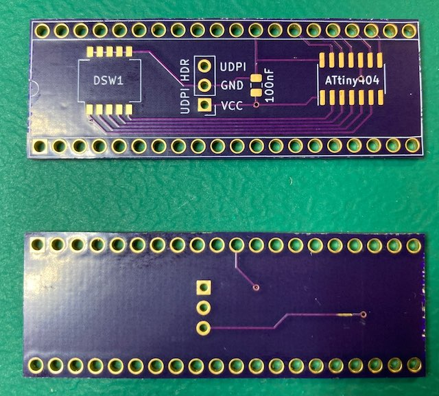

With the long down times between having new revisions of openkey-kabuki pcb, I decided to take a look at making a on the fly programmer for cps1. I was going to need something to test a cps 1.5 game with the openkey-kabuki so it made sense to try and make openkey-cps1. At the time I didn't have a cps 1.5 game but was looking for one.
I started out the same way I did with the kabuki, using ArcadeHackers out of band C board programmer. It worked as expected on a suicided capcom world I had.
I breadboarded stuff and started writing the firmware. I used the same ATtiny MCU and was able to reuse a lot of the code from openkey-kabuki. The initial breadboarding didn't work and after some debugging it turns out 2 of the 4 pins needed to do the programming are tied to ground on the B board. I ordered some short IDE/40pin extension cables and cut those 2 pins from the female side of the cable. This allowed programming to start working.
At this point I started designing the board in kicad. This was a good step forward in learning as it required taking real world measurements of the locations/spacing of connectors and getting them into kicad. Plus a lot of practice running the 160+ traces.
First rev of the pcb ended up not working. After a bit of debugging I found I f'd up on the schematic. I accidentally mixed up those 2 pins that should have been disconnect from the B board with the 2 that shouldn't. 2 bodge wires and cut traces later, stuff was working. (pic is from after I had already stolen the MCU/dip switch for the next rev)
Fixed up that issue in schematic and added some silk screen, then ordered up a new rev.

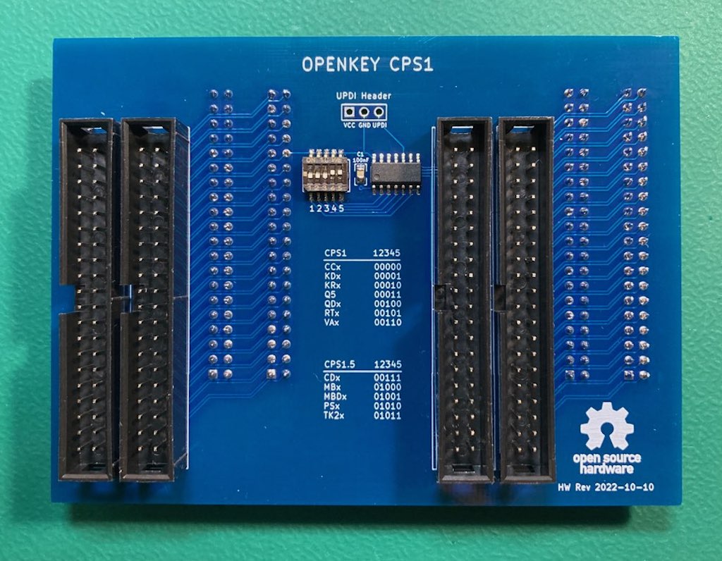

While that rev was being made I got my hands on a punisher board. After reverting the dead battery society mod on it, I installed openkey-kabuki/cps1 and both were
working good. However I found out having the openkey-cps1 installed didn't allow the cover to close on the punisher board. The C board being shifted directly to the left caused it to conflict with a plastic standoff on the case.
I ended up taking a hacksaw to one of the first rev boards so it was possible test shifting the C board connectors down to see where best to place it. Once I figured that out I adjusted the pcb which required re-running all the traces. This puts me at the current revisions of
This new rev allows the punisher case to fully close, but its a tight fit height wise.
I still need to write up some docs, but once those are done I will looking at putting this up on github too

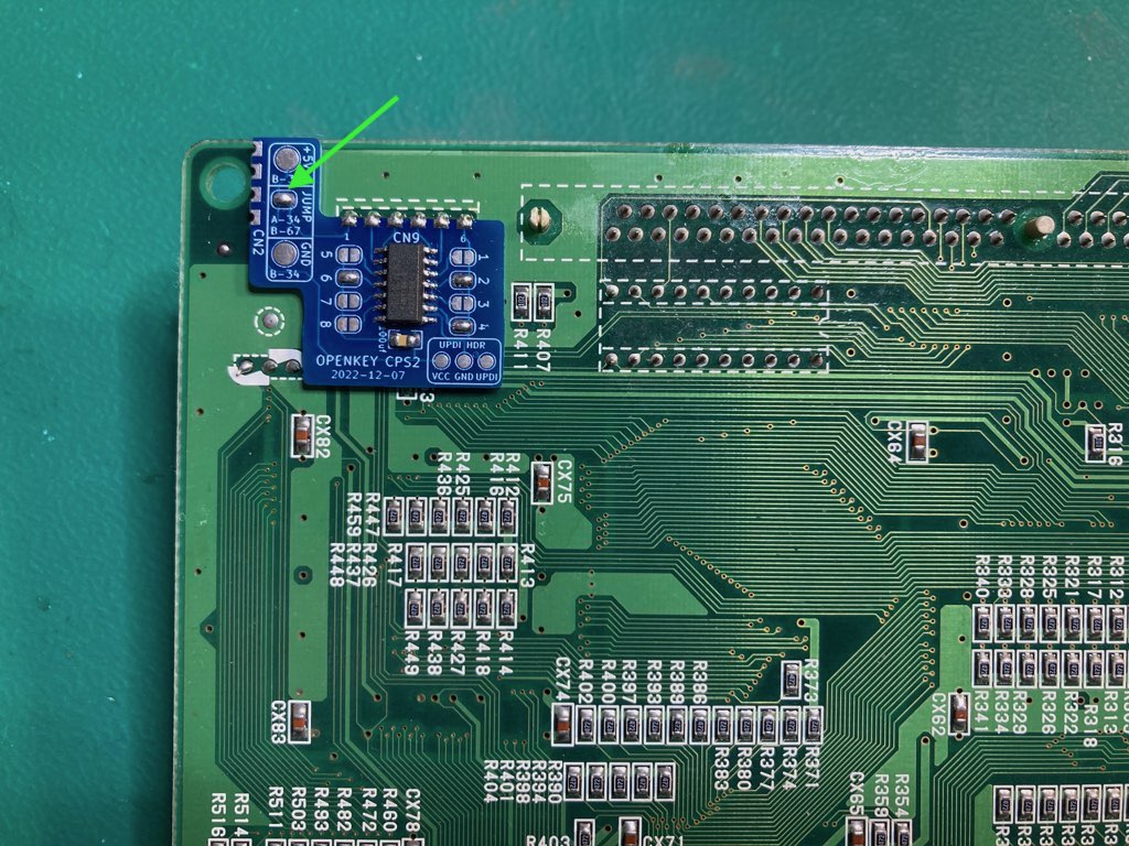

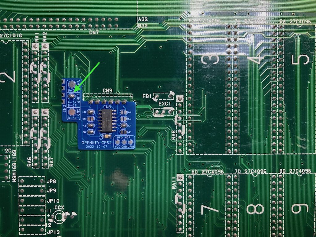

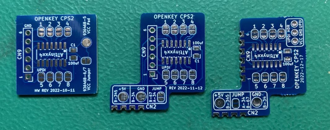

I'm back, with an openkey-cps2 board. I've been working on this on and off for the past couple months. The progression of board revisions
It was a slow process because when I started I only had 93646B-6 and 93646B-7 CPS2 revisions. This is reflected in my initial revision which only supported those.
Once I got my hands on a 93646B-4 board it led to the 2nd openkey-cps2 revision. At the time I did my best to verify that version should fit ok on the all-in-one CPS2 boards based on pictures. However I only focused on making sure the openkey board didnt interfere with the screw hole and the plastic dimm/simm connector. I didn't consider that the nub added for 93646B-4 support might stick out past the edge of all-in-one board, which it did :/

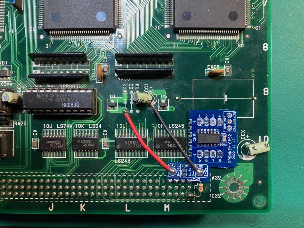

This led to the 3rd/current revision which shifted the nub closer to where the openkey board solders into the all-in-one cps2 board. This change also allowed me space to add in a UPDI programming header. The lack of one of them made it annoying to program the mcu in the first 2 revisions.
Here are some picks from it installed. Ignore the green arrows, I stole these from my install docs.
Firmware was pretty straight forward, just writing out 20 bytes. There are a lot of games / keys, which made firmware size right at the 4k limit of the
ATiny404. I was a little worried about that initially, but was able to save about 800 bytes by making a lookup table for the first 6 bytes of each key. There ended up only being 10 unique combinations of those 6 bytes across all keys, which made the lookup table possible.
https://github.com/jwestfall69/openkey-cps2

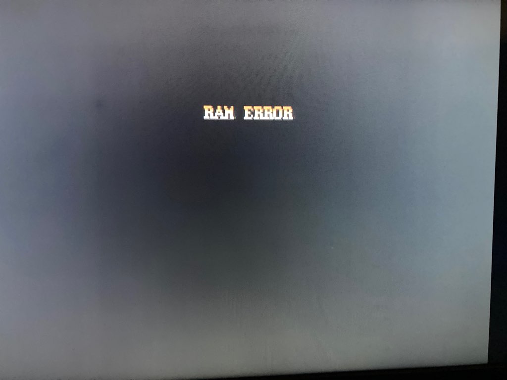

This is some of the details related to openkey-kabuki having a compatibility issue with the older (uncommon?) cps 1.5 92636D-3 D board revision. Ultimately I suspect its not possible to program the kabuki at power-on with this D board revision.
I had a user contact me that their 3x Warriors of Fate USA boards were all giving "RAM ERROR" when using openkey-kabuki. I made a conversion of wofu with my punisher board and it worked fine. So wasn't sure what was going on.
I disassembled the wofu rom (tk2u_23c.8f) to see what can trigger a "RAM ERROR" thinking maybe (but unlikely) there was some issue with the all 3 of their A boards.

So its possible "RAM ERROR" to be triggered by the shared ram between the main cpu and kabuki. I provided the user with programmer and we tried a number of different firmware to test out different timing thinking it could just be an issue with the kabuki writing to the shared ram while the main cpu was doing its shared ram test. None of these made a difference.
The user sold me one of the boards. Once arrived I confirmed I was getting the "RAM ERROR". (also a side note, sometimes you can get around the error by doing a very fast powercycle. Which is short enough the kabuki retains the key data, openkey itself doesn't power cycle, and the board reboots. The effect is openkey doesn't program and the kabuki uses the previously programmed key data and the game starts fine).
I also confirmed that game worked fine with a battery backed kabuki that had been programmed by openkey. Turns out his wofu's all have 92636D-3 D boards, where my punisher/conversion has the 92636D-5 D board.
Next was to modify wofu code to identify which ram test was triggering the "RAM ERROR". This was done by making the gfx ram test print "M ERROR", work ram print "ERROR", and shared ram print "ROR". In the event there was some other code path I missed it would still print "RAM ERROR"
That confirmed it was the shared ram. At this point I tried may different timing tweaks to the firmware. However making programming take longer doesn't seem like its going to help because of main cpu is waiting for the kabuki to write that 0x77 to shared ram before it will even start the shared ram test. So I focused on making the programming go faster, all the way to the point of removing all logic from the firmware and just long list of pin enable/disables.
openkey-kabuki-tk2-raw.ino
This version still results in "RAM ERROR". Additionally I've tried many other tweak in the firmware with no luck.

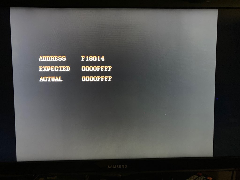

This resulted in

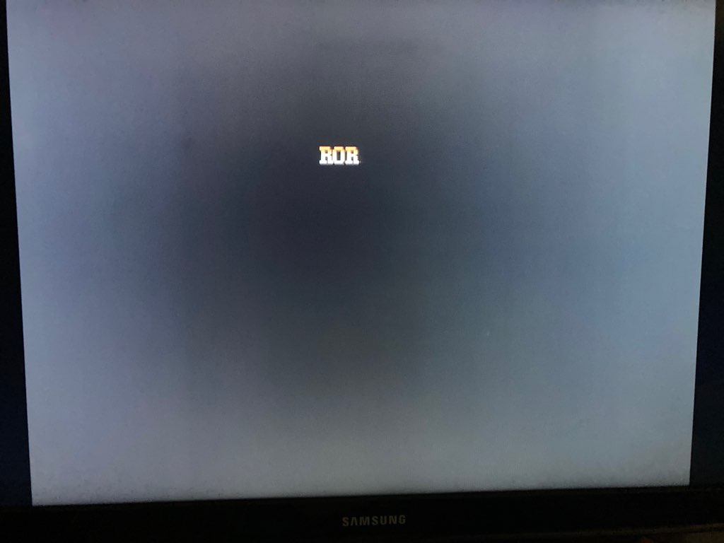

wtf? expected and actual are the same (address is random within the shared ram range). I originally thought I had messed something up in my print_data_error code, but confirmed it was working correctly by feeding in manually set values.
This made me think there could be a dead output situation, where the main cpu trying to read from the shared ram but the ram (or maybe a bus transceiver) never
put anything on the data lines. On a 68k cpu this usually results in part of the next instruction being put into the register. However even if this was the case, its unclear to me how the cmp fails if d1 actually contains 0xffff.
To rule out this dead output idea I put a 'nop' between the move.w (read) and the cmp as this should cause a behavior change, hopefully with different 'actual' data.

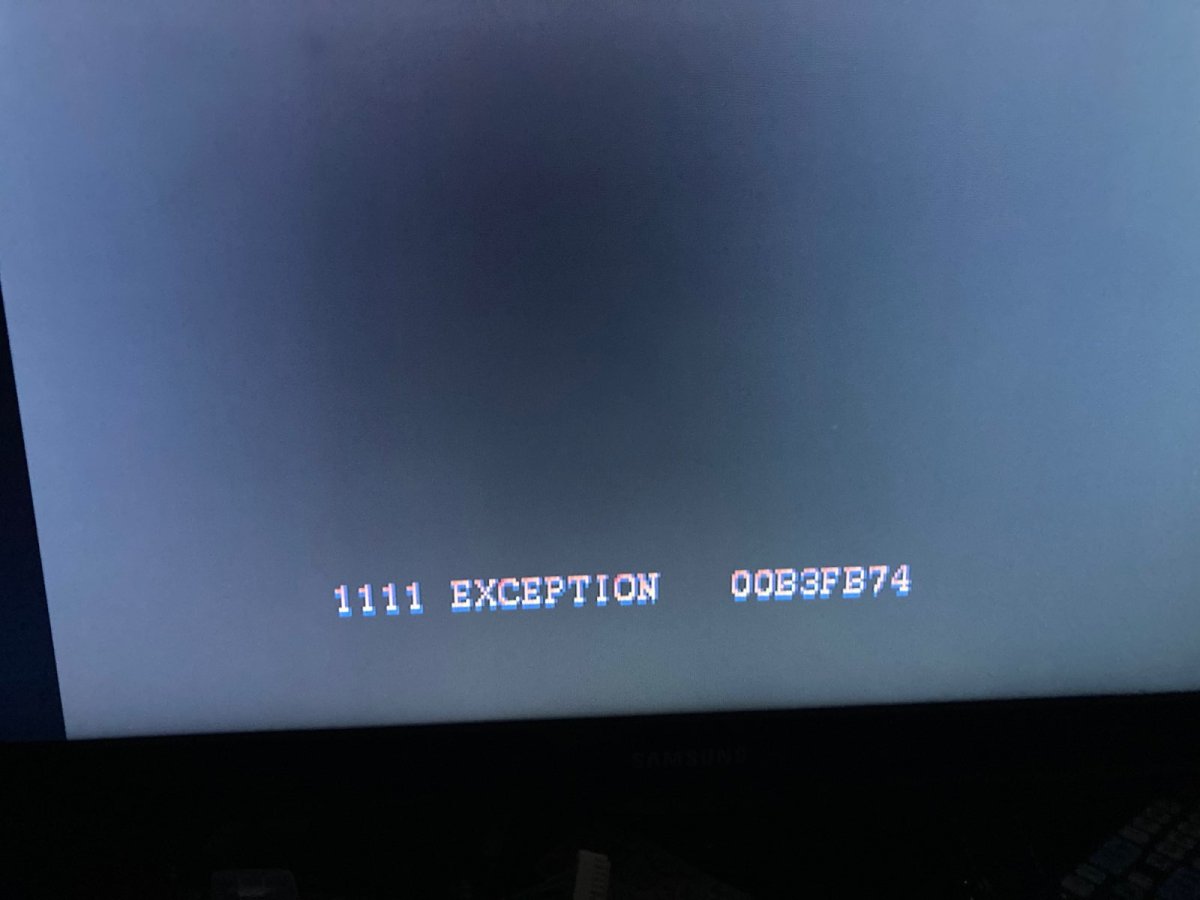

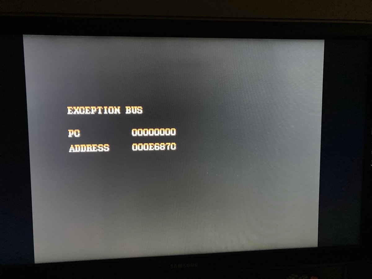

The added 'nop' resulted in a black screen instead (yawn). At this point I added some code that if the memory test passed it just printed "PASS" instead of giving control back to the game on the off chance the 'nop' fixed the issue but some other part of the game was causing the black screen. No change, black screen still. Adding a 'nop' shouldn't have this effect.
The only thing I can think of that would cause this black screen is an exception, so added some code to override bus/address/illegal instruction/divide by zero exceptions with my own code.
The result
Its unclear to me why/how the PC is 0x0, but the 0xe687c address value is the location of that 'nop' instruction.
At this point I'm suspecting there is some design flaw with this older revision of the D board. Such that any delay in the kabuki starting is tickling this flaw and causing problems with the main cpu accessing the shared ram during its shared memory test.

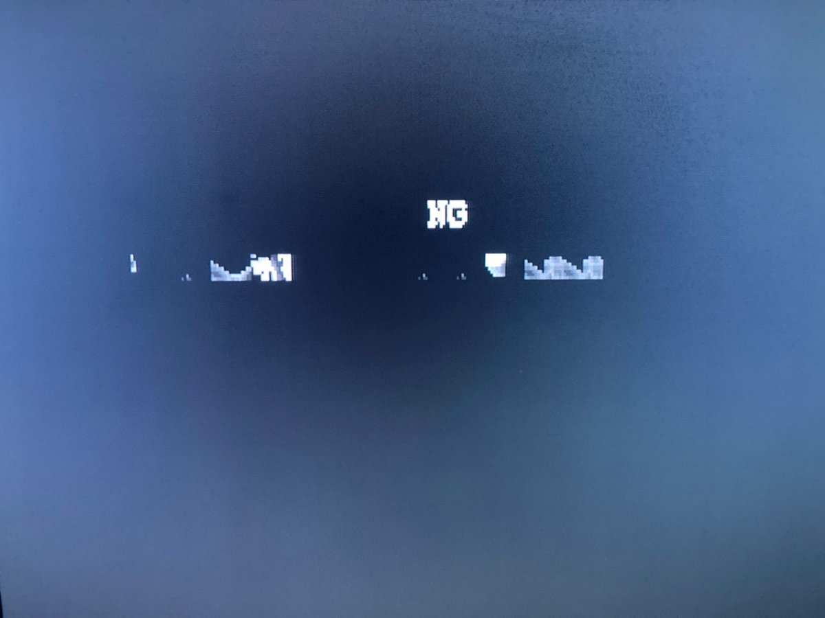

Muscle Bomber Duo:
The "NG" on Duo has the same meaning as "RAM ERROR" on wof

The original D9K1 PAL would enabled 3x 74LS245s that handle passing data/address lines to/from the main cpu to the kabuki data/address bus whenever the kabuki enabled BUSACK.
The updated D9K2 PAL adds additional restricts on enabling those 74LS245s. For example one of them disables the 74LS245s if the main cpu is no longer accessing the shared memory address range.
So its likely with the original version those 74LS245s were just being enabled for to long and could cause problems.
