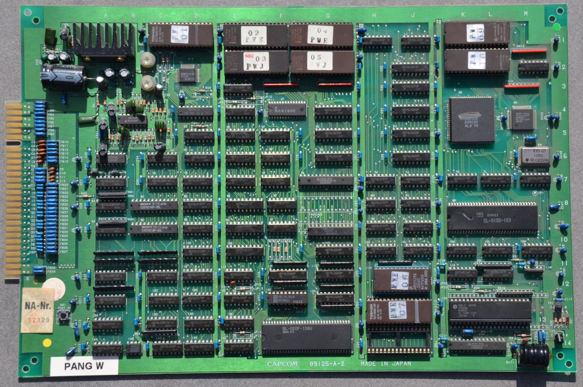

I am fixing my Pang World with the Kabuki. The board was originally using Arcadehackers decrypted set and it worked without any issues.
When I insert the original ROMs and set the Kabuki to 00111 I am greeted with the message: RAM OK.
I have read through the documentation and tried holding down Start, button A, button B, setup button on PCB while powering but no go.
Anyone have any idea what might be wrong ?

Regarding being stuck at "RAM OK" screen, In my testing I had consistant success holding COIN + START + P1 SHOT. Every time I changed Super Pang region EPROMs, I had to do that exercise.

I would be interested, one is better then none. Did you by chance try the hold down p1 start, then power on the board to see if it fixes your issue?
I held down all kinds of shit, test/service/jamma b1... I just can't remember IF I did start.
I'll try it again this weekend and let you know.
Some interesting news to report...
I put the PCB (with InfiniKey installed) into my cab, held down start and powered it on.
Same results as last time (ie solid color screen behaving like a suicide) however I noticed something very important...
Because I'm a Jammafier user, upon boot no matter what I hold down for controls/buttons.
Controls aren't passed to the JAMMA PCB until communication with the JVS IO is established!
The handshake process, while fast isn't instant, and I think this could be the issue.
Aka from the PCBs perspective the start button is being held just after power on, but not during power-up.
