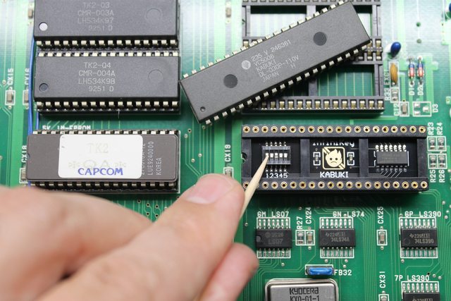

InfiniKey-KABUKI will handle both dedicated PCBs and Q-Sound (aka CPS Dash, CPS 1.5) audio boards.

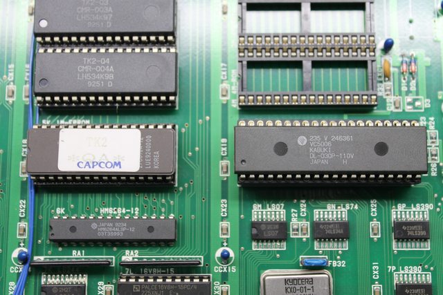

Installation:

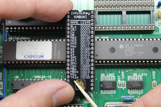

1. Remove dead battery and find switch code that matches your EPROM name
2. Remove Kabuki chip, insert InfiniKey, and set switch code
3. Insert Kabuki chip into Infinikey socket
