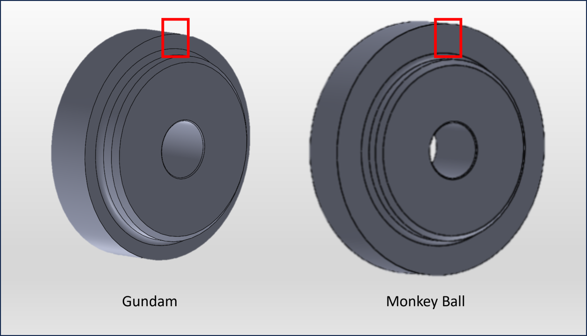

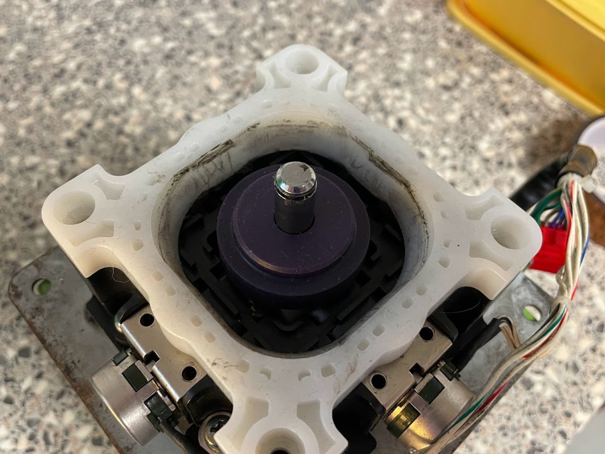

The main factor here is the restrictor disc (purple) residing in the base of the unit. Gundum units are 40mm outer diameter while MB is 45.5mm.
@plasticfactory has very kindly offered to attempt a CNC repoduction of the og Monkey Ball disc as shown below:
The plan would be to machine these (no 3D printing) from a similarly tough/suitable material (glass filled nylon, wear resistant POM or Delrin), with a target price around $15-20 each at Q10-20.
I would therefore like to run a quick interest check here now.
