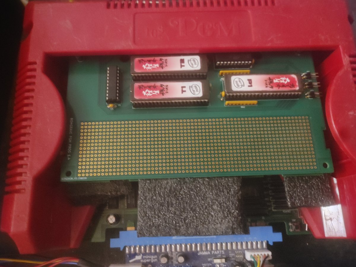

See if shimming foam between the eproms and the board helps so they wont touch.

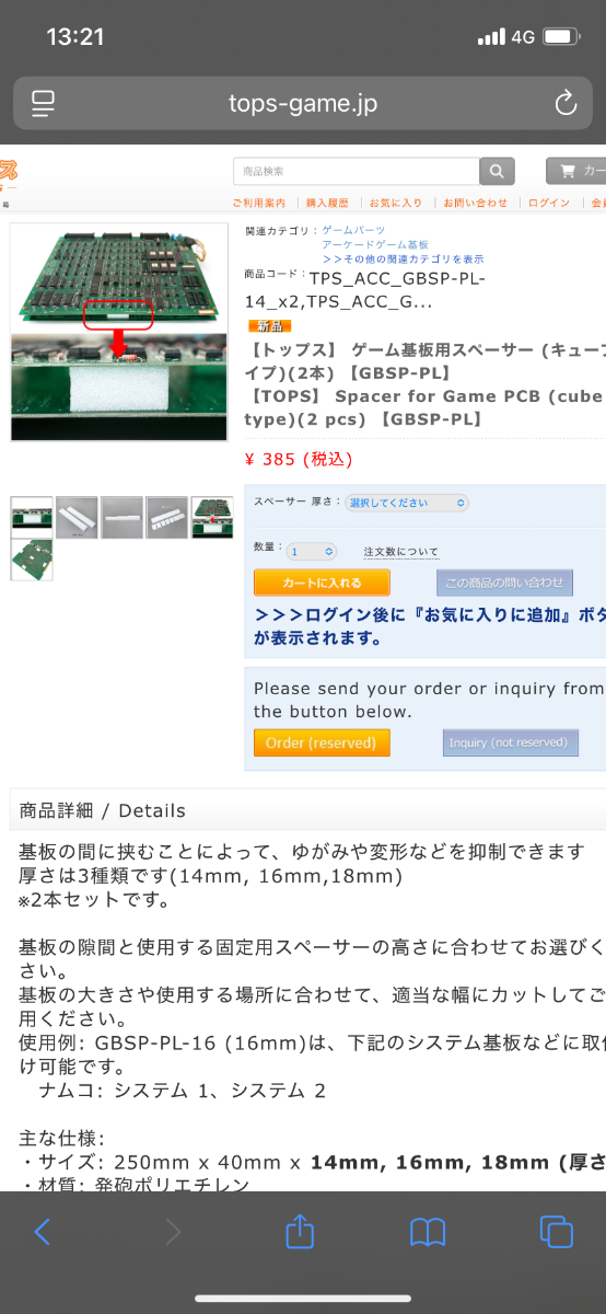

Is it what you are recommending to use ?

Caps help but any rubbing on the eproms for the multi still gives me glitches.
The fact it goes away makes me think it isnt a board fault. Regardless the board is old, a recap stabilizes things.
Here's an example of some foam I used to test the pgm carts I am building on my test bench.
I just stick it between the boards so they can't touch.
