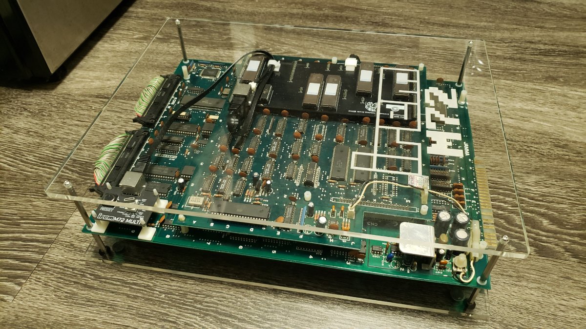

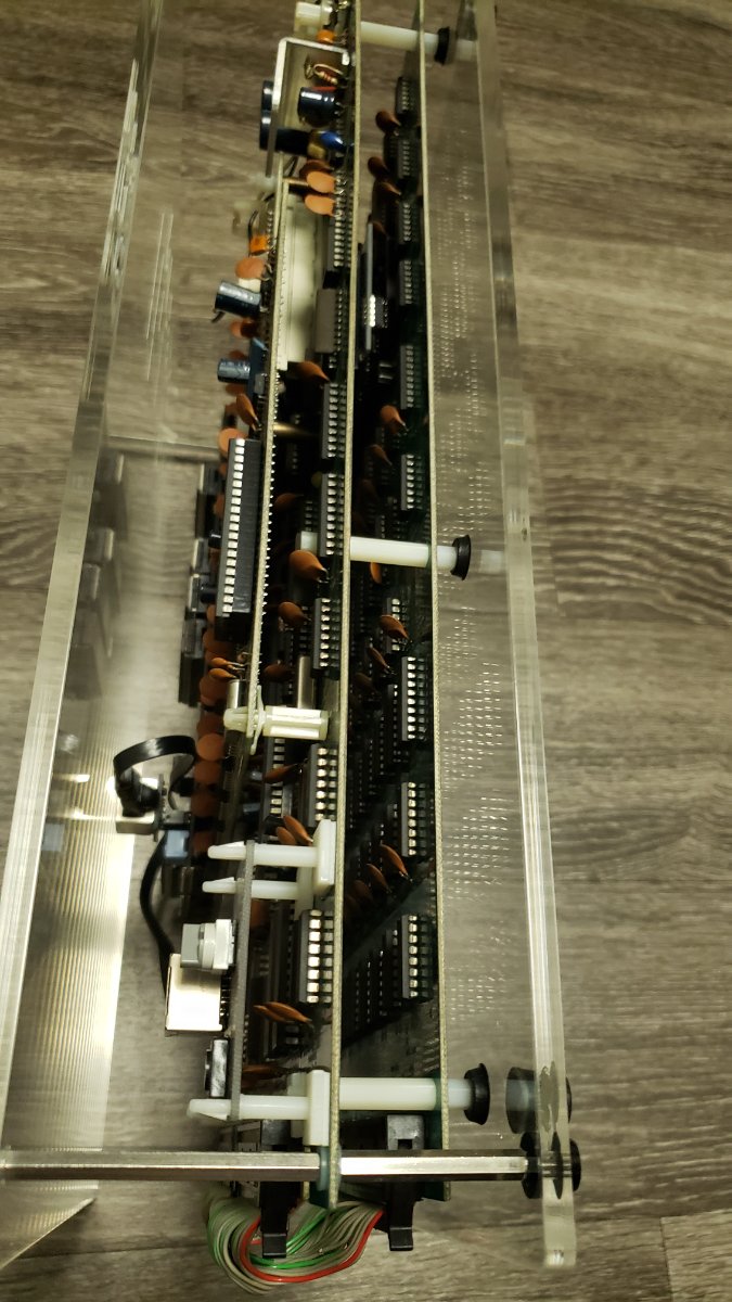

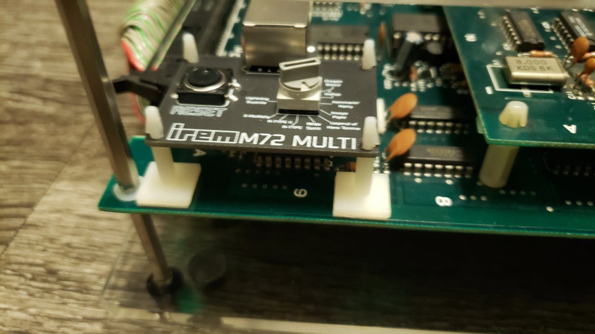

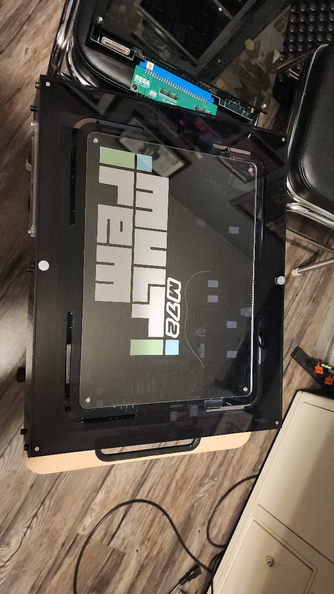

I have this one and like it very much. I was able to mount the rotary selection switch in the left bottom corner so it is under the acrylic. I added additional standoffs that rest on the acrylic and static safe foam blocks between the board layers to keep it from gravity's curse.
Thanks for your message
My memory was wrong about the foam. I removed it when it went to the case as it wasn't needed with the additional supports present.

Do they provide this exactly case for m72 as a standard, or you asked them for longer spacers and boards to fit your m72 multi ?
I bought the acrylic from them and then went shopping for my own standoffs. They include some but not as many as I added with the clearance I wanted
Ok, They are selling only one type of acrylic ? Or is there a special type size for multi ? Where could you get those standoffs?
Highflow only sells one type of M72 case. It comes with the standoffs pictured on their website.
You can get standoffs from amazon, aliexpress or similar. If you buy an assortment of them, you can see which ones work best. If you can't get perfect height, you can cheat with some m3 nylon/plastic washers or use rubber feet on the acrylic side to close the gap and make everything uniform. Just look at the pictures.
