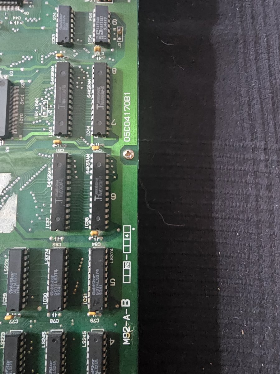

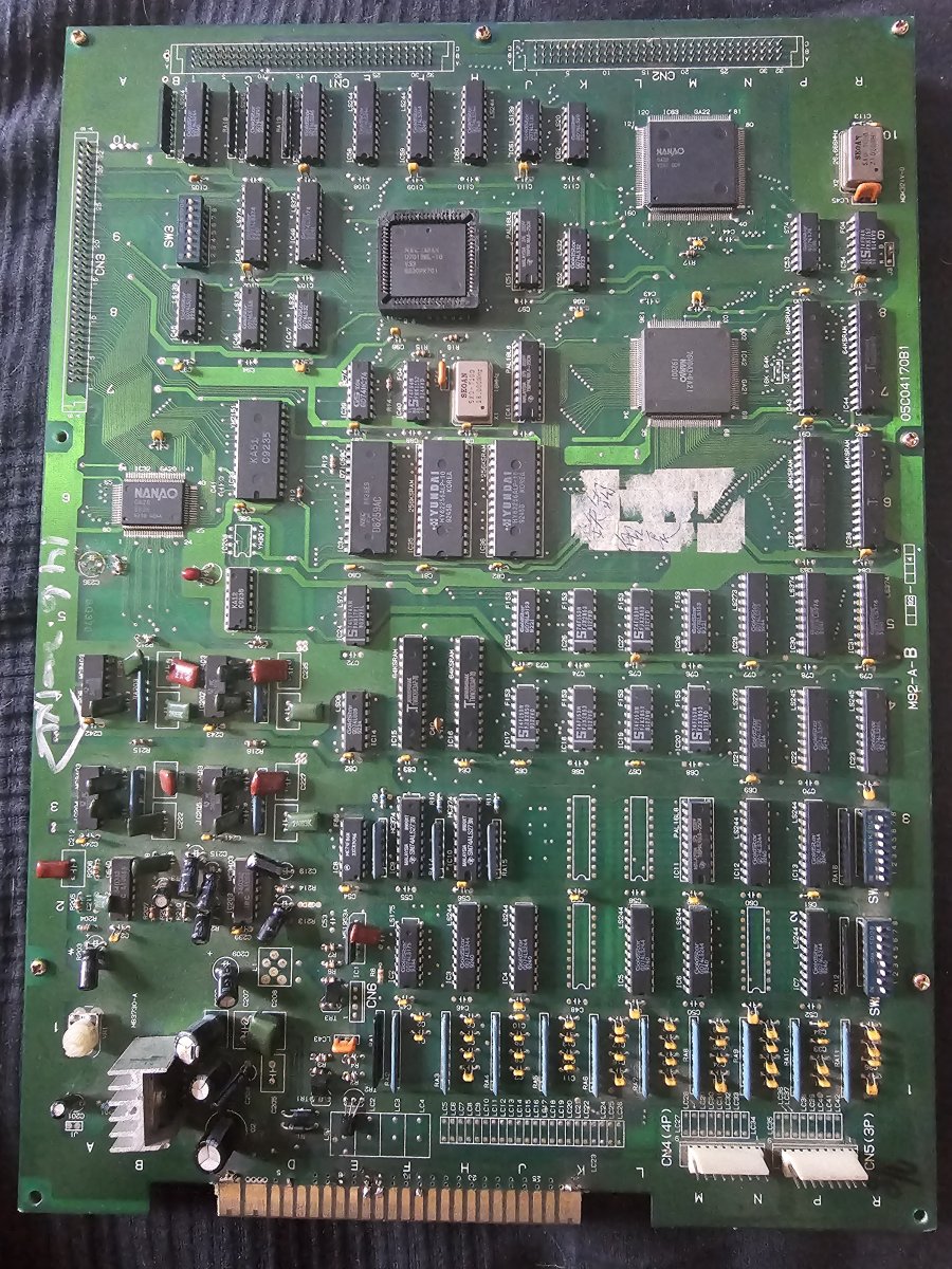

I have a question will it be compatible with my Ninja Baseball Batman I bought it à long time ago as an Korean Original.
For some of my friends it's a boot.
It's written M92-A-B and the board is really similar to my Undercover Cops just a few differences.
Thanks

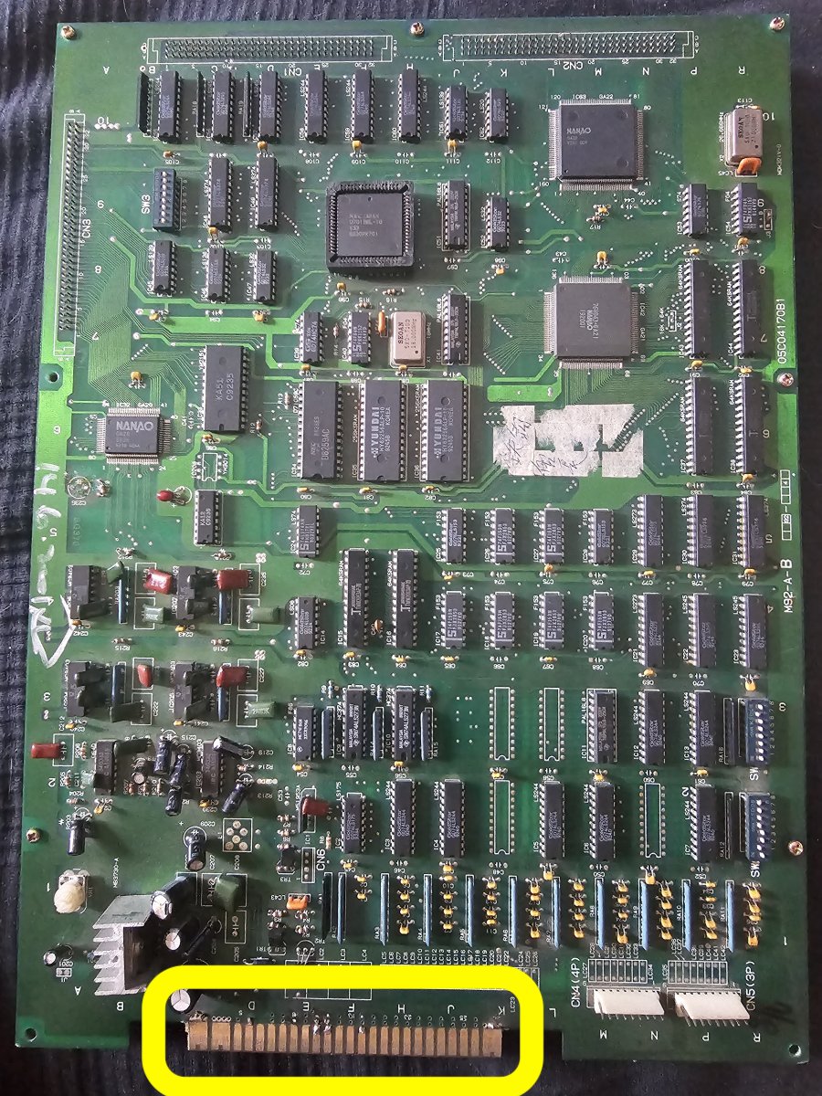

Your NBB board isn't a bootleg, but it is a conversion from a different M92 game - not a Korean original NBB. It should work fine as a donor for the Multi when it's released.
I'll do a rare disagree with you on this one @ShootTheCore . From what I've seen, all Japanese M92 boards have the JAMMA notch. Korean "official" ones (not pure bootleg) sometimes don't have the notch.

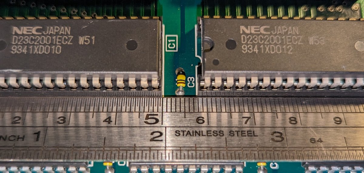

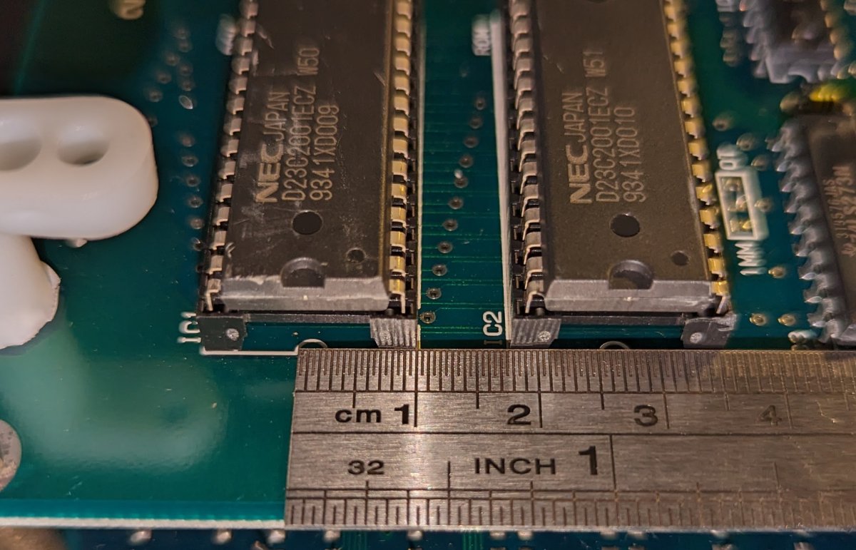

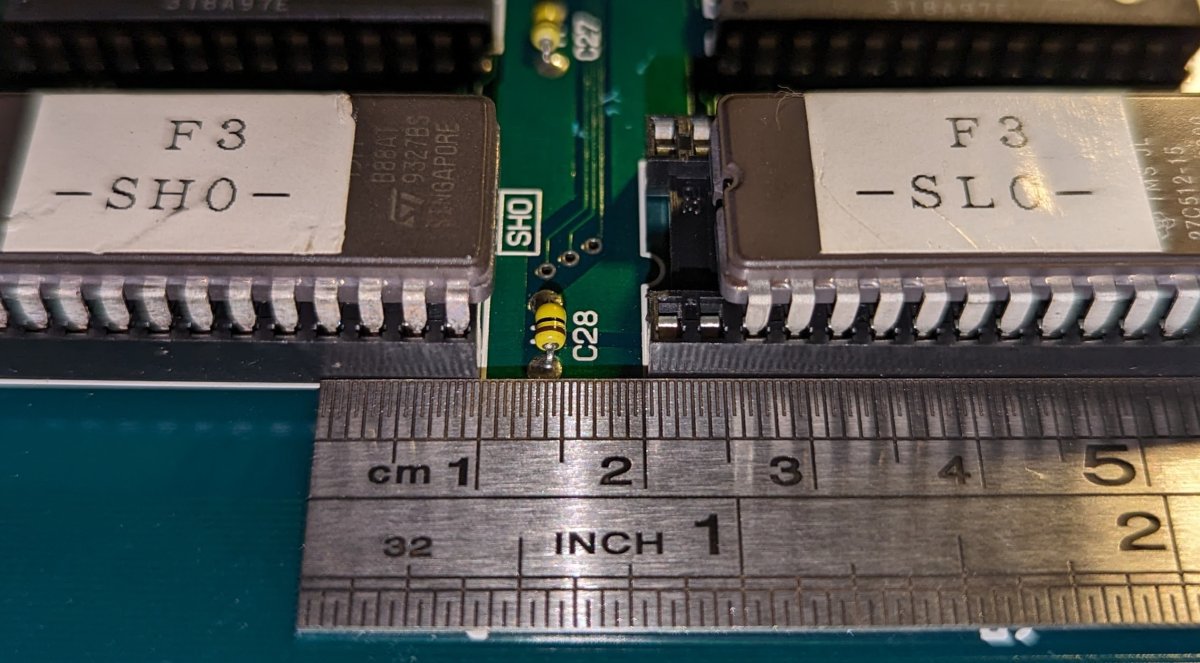

Ok guys. We took a break from s32 development to start on M92 and we may actually get this done first. But we are going to need your help.
As you know the M92 multi in its intermediate form will rely on two daughterboards, thing is there are many different layouts.
I'd need the spacing for the following romboards:
- M92-B-G: spacing between sound ROMs (SH0/SL0, vertical layout), spacing betwwen C ROMs (C0~3, square layout)
- M92-D-A: spacing between sound ROMs (SH0/SL0, horizontal layout), spacing betwwen C ROMs (C0~3, horizontal layout)
- M92-E-B: spacing between sound ROMs (SH0/SL0, horizontal layout), spacing betwwen C ROMs (C0~3, horizontal layout)
I'm under the impression (low res pics I found online) M92-D-A and M92-E-B follow the same layout for both sound and C ROMs.
Any confirmation for the other boards (M92-B-A, M92-B-, M92-C-B, M92-C-N & M92-F-A) would be great too.
Thanks for any help!

I have a M92-B-G on my Superior Soldiers. I'll take some measurements.
