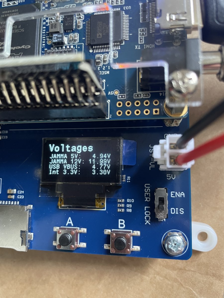

Ive been able to test it in two cabs. I didn’t encounter any issues with the ‘New Astro City’ with a voltage of 5V right on the nose.
Testing it in the Impress is giving me a garbled screen, which I am assuming is a sync issue, although the voltage in the impress was rated at 5.3v. Any thoughts or help would be appreciated!

If you get the voltage reading screen and can't press anything, the voltage was too high on boot. If you can access the menus on the expander, it should give you an indication why you get a garbled screen - most likely syncguard.

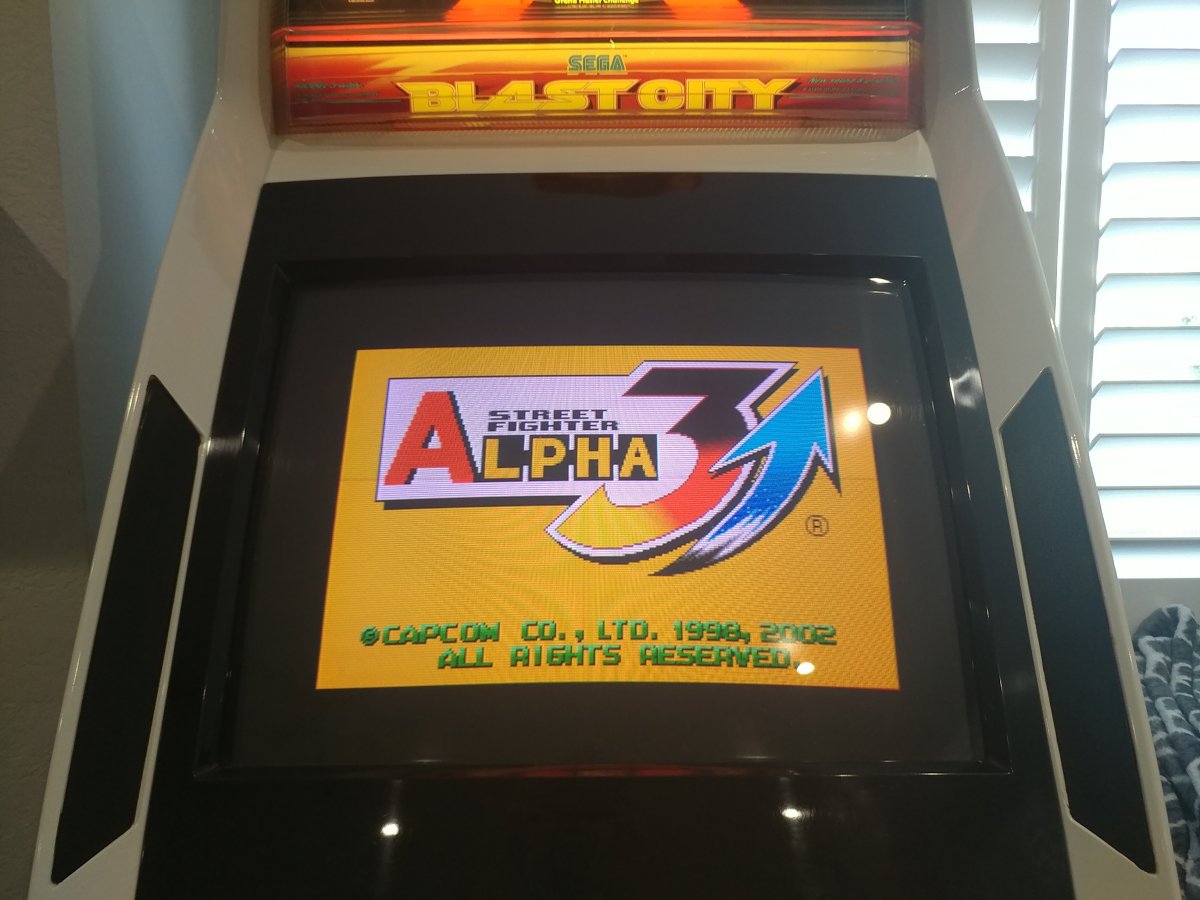

Mine came in as well today, that was quick!
I briefly tested it out and seemed to run into an issue where my MiSTer doesn't seem to turn on, in my cab, although the JAMMA Expander lights up. It may be because I bought a fully preconfigured MiSTer with addon boards, although I removed them and double checked that I configured the MiSTer itself correctly per the website instrcutions before installing it into the JAMMA Expander. I'm guessing it's either a preconfiguration related thing I need to change, or some other form of user error. I'll find out after tomorrow when I'm off work and have more time to tinker.
Most likely I'll buy a bare DE10 Nano and RAM just for the JAMMA Expander soon. I didn't expect to enjoy the MiSTer on it's own as much as I do, especially with the analog add on board. It feels so much simpler and faster than dealing with a Pi or other emulation based mini PC, particularly the menu and controller config.
To update on this, the 5V on my Blast PSU was set way too high (I should've rechecked this after I had the unit recapped!), which caused the power issues. After adjusting this, the Jamma Expander and MiSTer both fired right up! Now I can finally play the best version of Alpha 3 in the way it was always meant to be played :P
