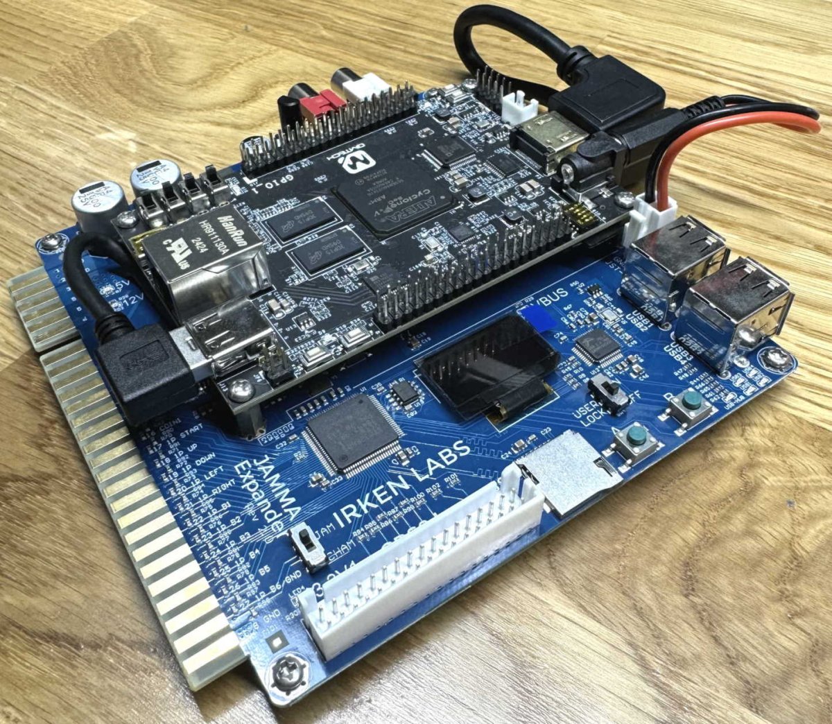

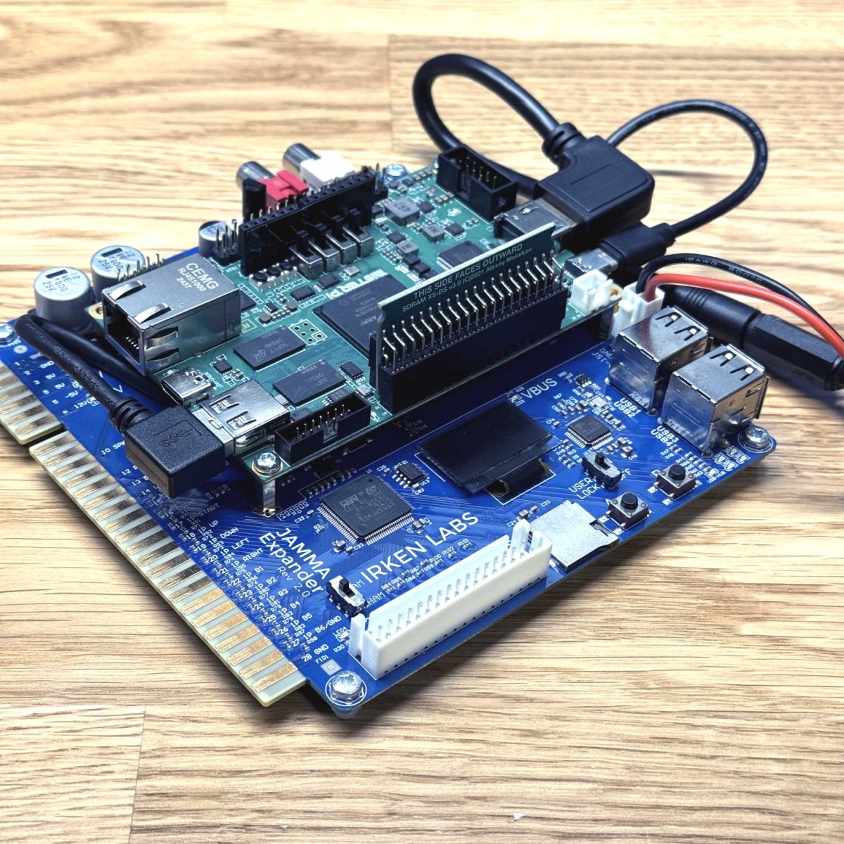

I would say highly likely, as the expander only uses standard connecors/interfaces and not GPIO pins. You may have to get a USB cable to connect it, as I don't htink any of the clones use a usb micro OTG port, but a standard USB A instead / pin headers.
@elrod - Tried the qmtech and had no issues!
https://irkenlabs.com/qmtech-de10-clone-mini-review/

I tried it but no joy yet, not getting any video out , could be a crappy SD card but I also didn't realise at first that on taki's board the USB c connector on one side is for debugging only, only saw this after watching takis setup vid so need another cable or adaptor to connect the otg cable connections similar to the qmtech on need a type a to type a . I'm out of action for a few weeks so may not get back to setup soon, can't see why it wouldn't work though
Managed to get to properly hook this up briefly today with taki s board and looks to work as expected, you will need an different "type A female to type A, male otg usb cable" and an adapter to convert the power connector to USBC for it to work
