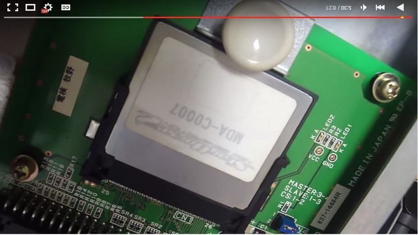

In this video below, when Lukemorse1 first got his Lindbergh Yellow, there is one CF card on the motherboard and then when he flips the plate that normally would hold the hdd at around 5:25 there is a CF to ide adapter and another CF card which I would assume like the HDD that would normally be there contains the game data:
https://www.youtube.com/watch?v=KWAjwwhHqrU

Ah I see. So someone just replaced the HDD with a CF adapter. The HDD is not protected at all so you could use and IDE device for the data so yeah they just copied the HDD to a CF card to prevent future crashing.
You are right the CF acts as a booot drive. The OS and some other bits are loaded directly from the CF card and then game data is loaded from the storage device....usually.

So, that Star Horse 2 game that Luke had running on CF, Was that a mod someone did to replace the hdd with a CF card or is such a thing factory installed? (might be, looks like it might have a Sega Part number 837-14484R on it)

That game is probably an original sega. Probably just wasn't very big. I've never seen it personally.
