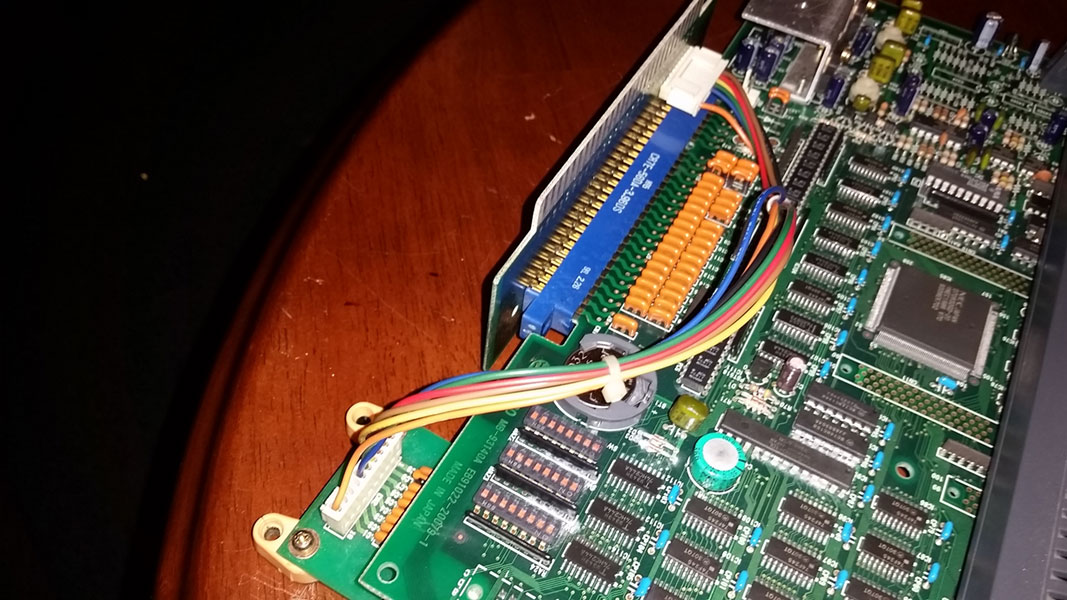

I've bought some more Mega System 32 hardware and it's clear now at least Hayaoshi Quiz Nettou Namahousou and World PK Soccer V2 require this additional daughterboard to boot:
I believe it's an output board. I can confirm that Angel Kiss, Kirara Star, and Suchie-Pai II all require it as well.
those are all Mahjong titles and they come with a small harness that runs from that header to another daughterboard that plugs into the JAMMA edge and provides a new edge pinned for mahjong.
This is clearly a problem for the multi: so far we've discovered at least 5 games need it but it also seems quite scarce (the Quiz game I got from @Derick2k needs it but wasn't there for some reason, I guess a lot of them have been discarded thinking they were only optional). It's very simple and could be reproduced but the market is probably too small for it.

Here are some additional pictures of the mahjong daughter-board and harness
the part number on that chip on the right is: LB1234 4X0
the part number of the big connector is: OMRON XC5D-9621 3016S

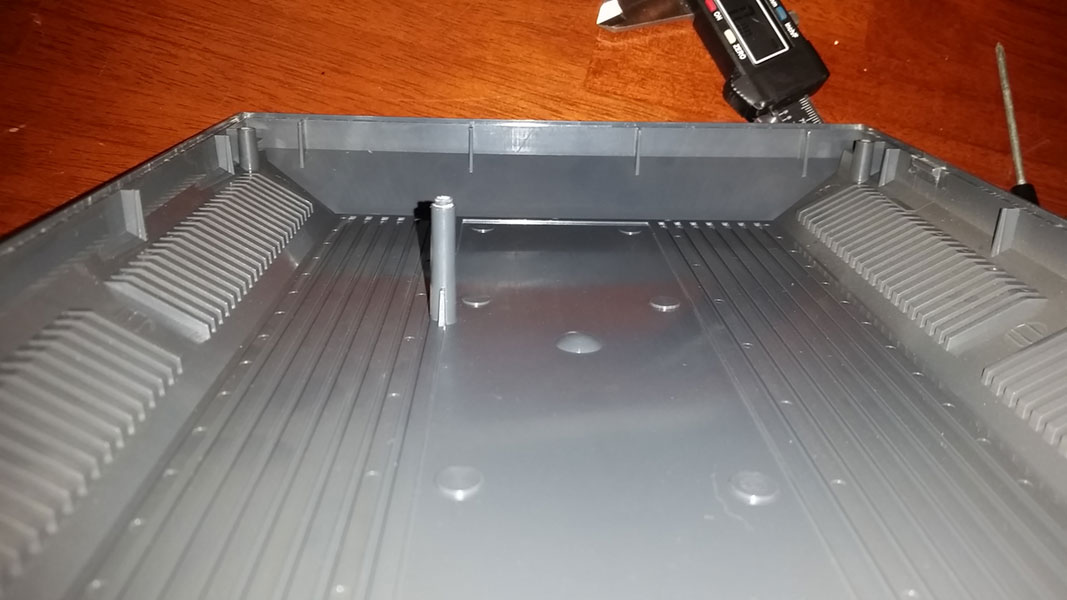

@twistedsymphony can you post some measurements/clearances on the shell and game board.
The cart mounts to the PCB with 5 screw posts that I've highlighted here:
You can see it tapers along the parameter:
The clearance between the PCB top surface and the lid bottom surface I measured at 27.9mm.
Similarly the clearance around the parameter is 13.1mm between the PCB top surface and lid bottom surface.
Estimated length of the tapered section on the front and back:
Estimated length of the tapered section on left and right sides:
One other thing to consider is if the multi board is contained within the cart housing how would you get any wires out to attach a dip-switch bank or other selector without modifying the cart case?
The entire parameter of the cart seats together with a lip, so you wont be able to squeeze any wiring out between the cart halves.
there are only 3 available openings:
1. the air vents on the front and rear of the top shell
this is a really terrible option, you might be able to snake some uncrimped wires through here but that's about it, plus it'd be really truly ugly.
2. The cart connector openings:
it looks like we might be able to snake a ribbon cable out along side the cart connector, this is nice because it's on the underside of the cart housing so it keeps it clean looking, also you could feed the connector through before closing up the cart. The only hold up is if the cable interferes with the connector; it may need some testing.
3. the clip openings on the bottom:
the back edge of the cart has two large plastic hooks that help clip the cart together, but it also provides a pretty big opening where you could fit a wire through, only ~16mm wide though so you could fit a cable with a dupont connector on here, but you likely wouldn't be able to squeeze through a ribbon cable connector

Technically correct... though it's worth noting: games that DONT use the daughterboard, such as Tetris Plus, WILL NOT boot if the daughterboard is connected, the service manual even has a page dedicated to showing you how to remove it.
So if the multi supported 100% of the games, you'd be swapping that sub-board on and off depending on which game you were playing.
I don't know about World PK Soccer, but the mahjong games are meant to be played only with a mahjong panel, AFAIK there's no joystick option, hence the need for the sub-board.
