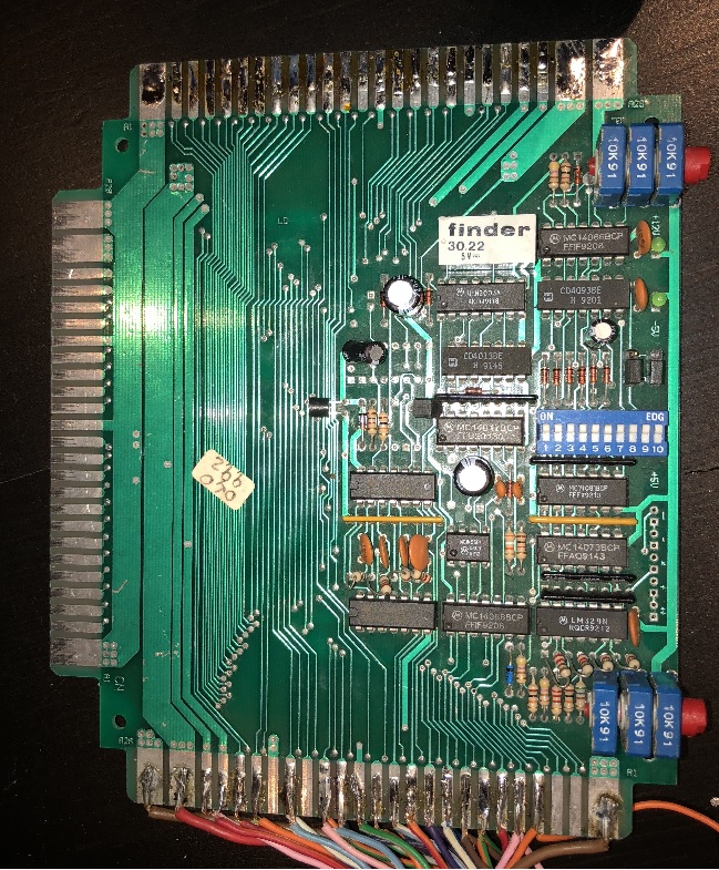

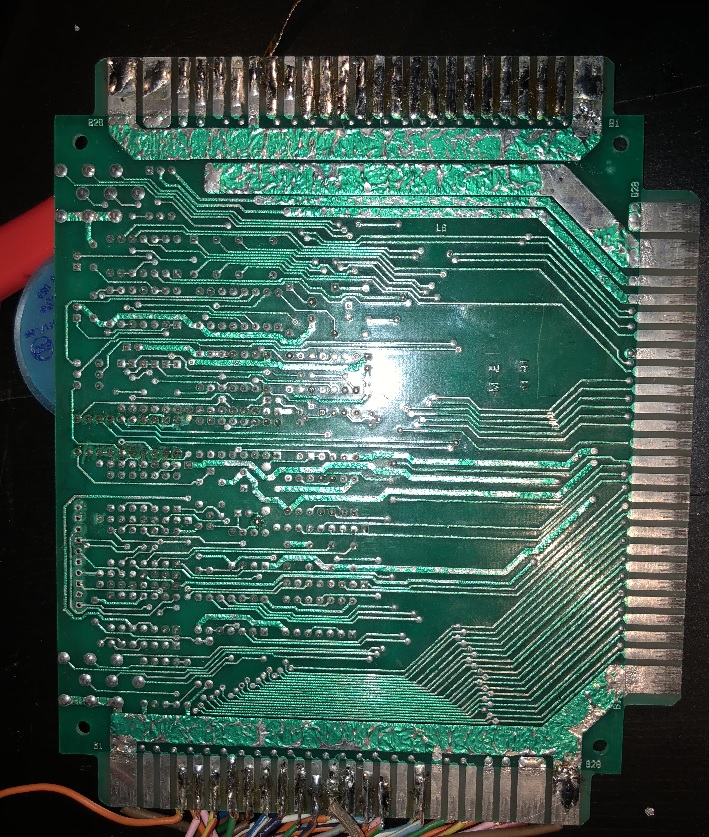

Here it is, had to size it down so hope you can see enough on the pics :)
