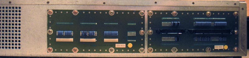

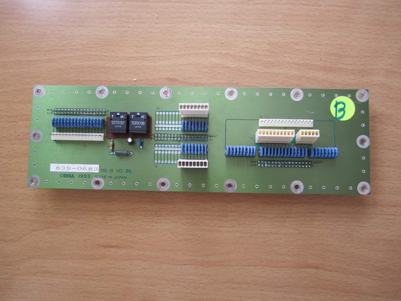

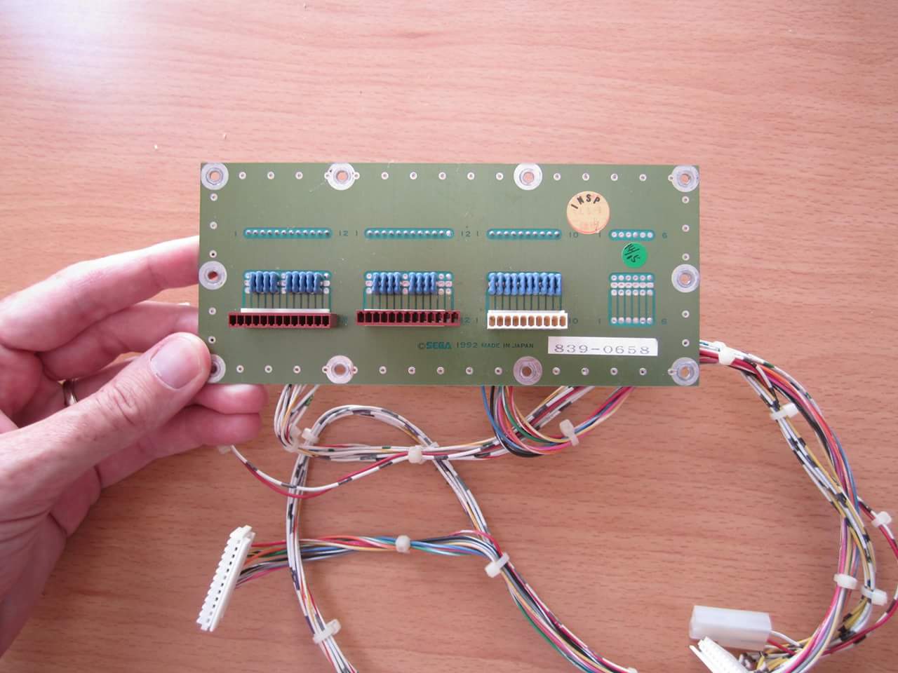

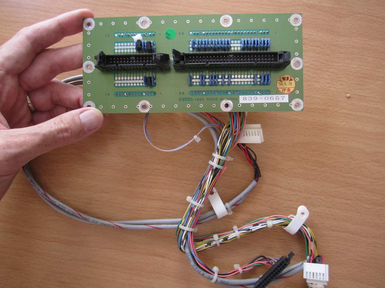

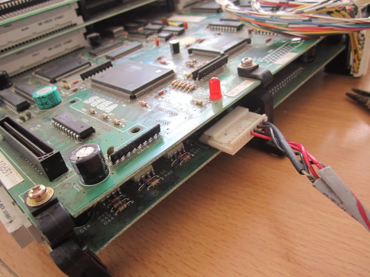

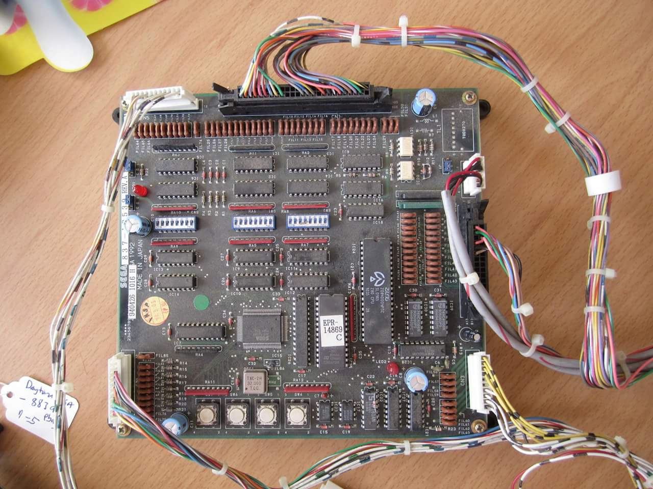

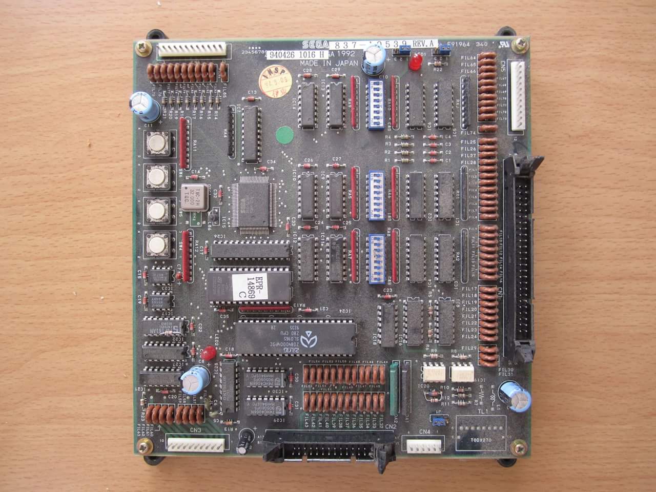

I got the following boards (see pictures):
839-0683
839-0657
839-0658
837-10539
the main game PCB

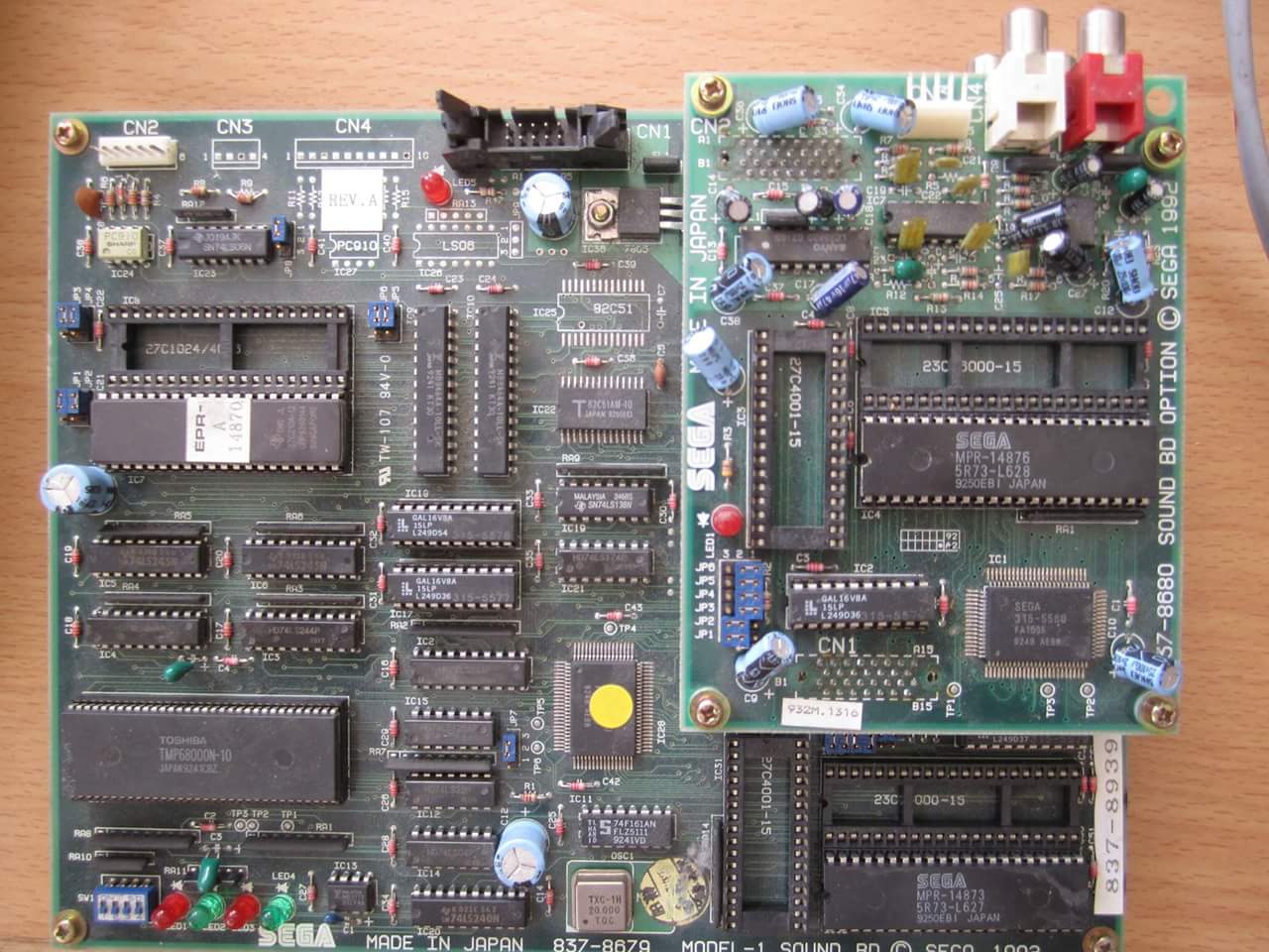

837-8679 a Sound BD from virtua racing 1
I got the owners manual and familiar with the connections that i need to do but im not sure i got all the boards.
I purchased some molex type connectors for the filter boards and basically i'm going to make a jamma conversion to play with my ABP-01 supergun.
what else do i need to make it work ?
