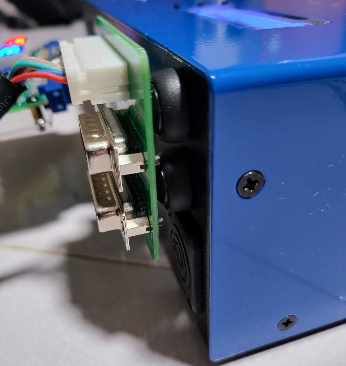

Thanks. The drawings shows 12mm opening requirement and I'm not sure that'll fit since I measured 11.6mm. Can't hurt to try though and return it if they don't work.https://www.amazon.com/dp/B09BKXT1J1?ref=ppx_pop_mob_ap_share
Those are the buttons I got and they’re a bit lower profile.
Screw them in. The buttons will tap through the powder coat.Thanks. The drawings shows 12mm opening requirement and I'm not sure that'll fit since I measured 11.6mm. Can't hurt to try though and return it if they don't work.

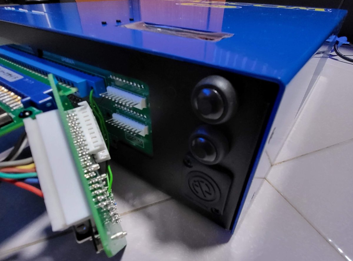

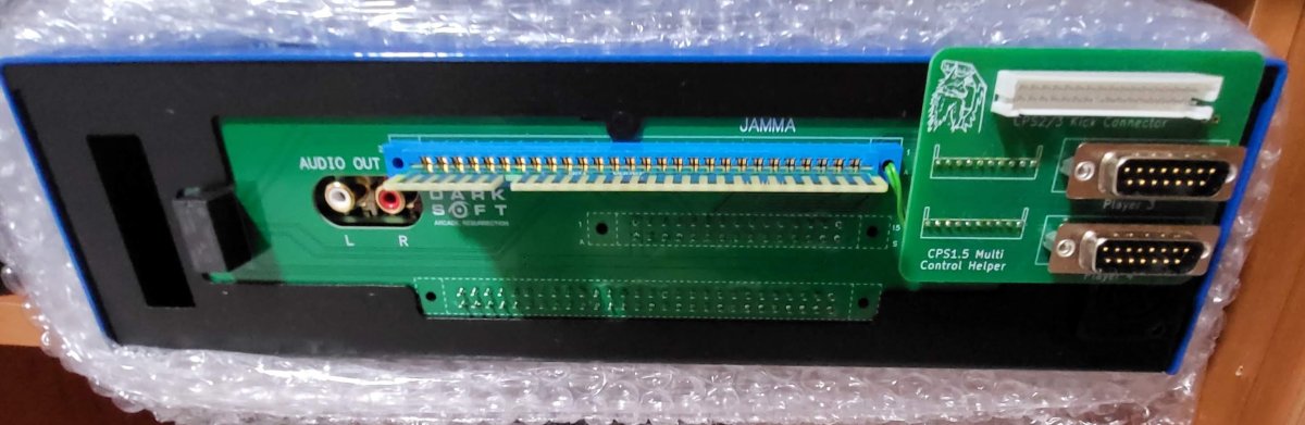

You need an extension cable to go from CNI02 on the multi to CNI02 on the inside of the filter board, then you connect the harness to that. Mitsu sells emI have one more silly question.
Where do i connect kick harness with case closed? I do not see any hole to connect. Do i need to buy some kind of add on board?
