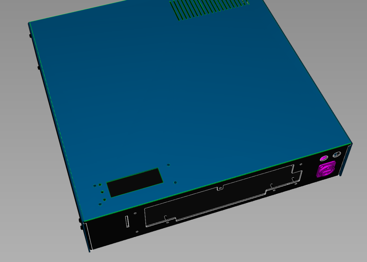

This is kind of what the top mount screen would look like. Some think its too busy... I'm not sure yet. I think the HDMI and buttons would get relocated to the other side of the case so there wasn't so much coming at you on the one side.
So it looks like it’s going to be quite a bit oversized, around 25% wider than the PCBs? I get that you’re including room for hdmi and other items, but as someone who’s not going to ever install them I’m not sure I want to deal with the bulk. Got approximate dimensions?

I am still working the design tweaks. The width is a bit too much still, I agree. Just need to get it just right. This is why I sleep before doing the hard work after a day of feverous design tweaks!

My CPS2 case has the screen on the front. Though, after the discussions here and some with @XtraSmiley over on Discord the top screen mount does have appeal and I am leaning on going that way. I'll be doing some tweaks on the design tonight and I'll post up. Already have done the following:
1. Counter sunk screws on the side.
2. Moved vents to the side of the case. In my head I thought about my CPS3 case and how the vents are on top, but that was for a heatsink under them, not the fan. (Plus its right next to me on my desk).
3. Moved the screen to the top.
4. Moved the HDMI to the opposite side of the case.
Up next, reevaluating the width of the case overall and I'm working on something with @Mitsurugi-w as well.
