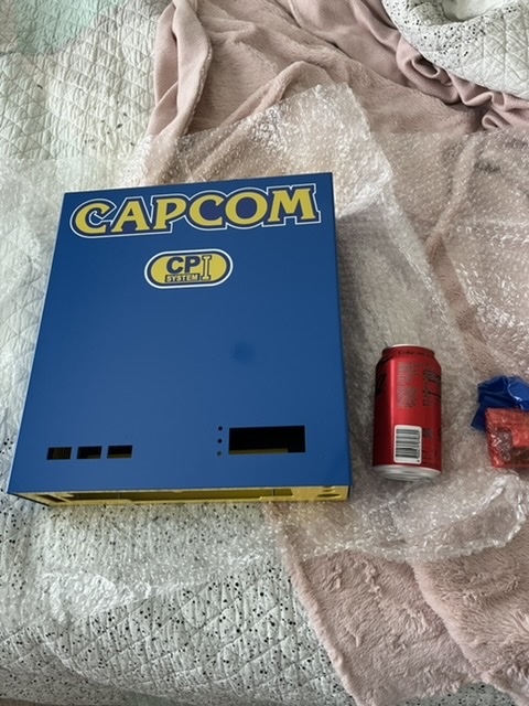

I received my one today, thanks again Jasen!
It’s much bigger than I imagined! Haha (coke can for size reference)

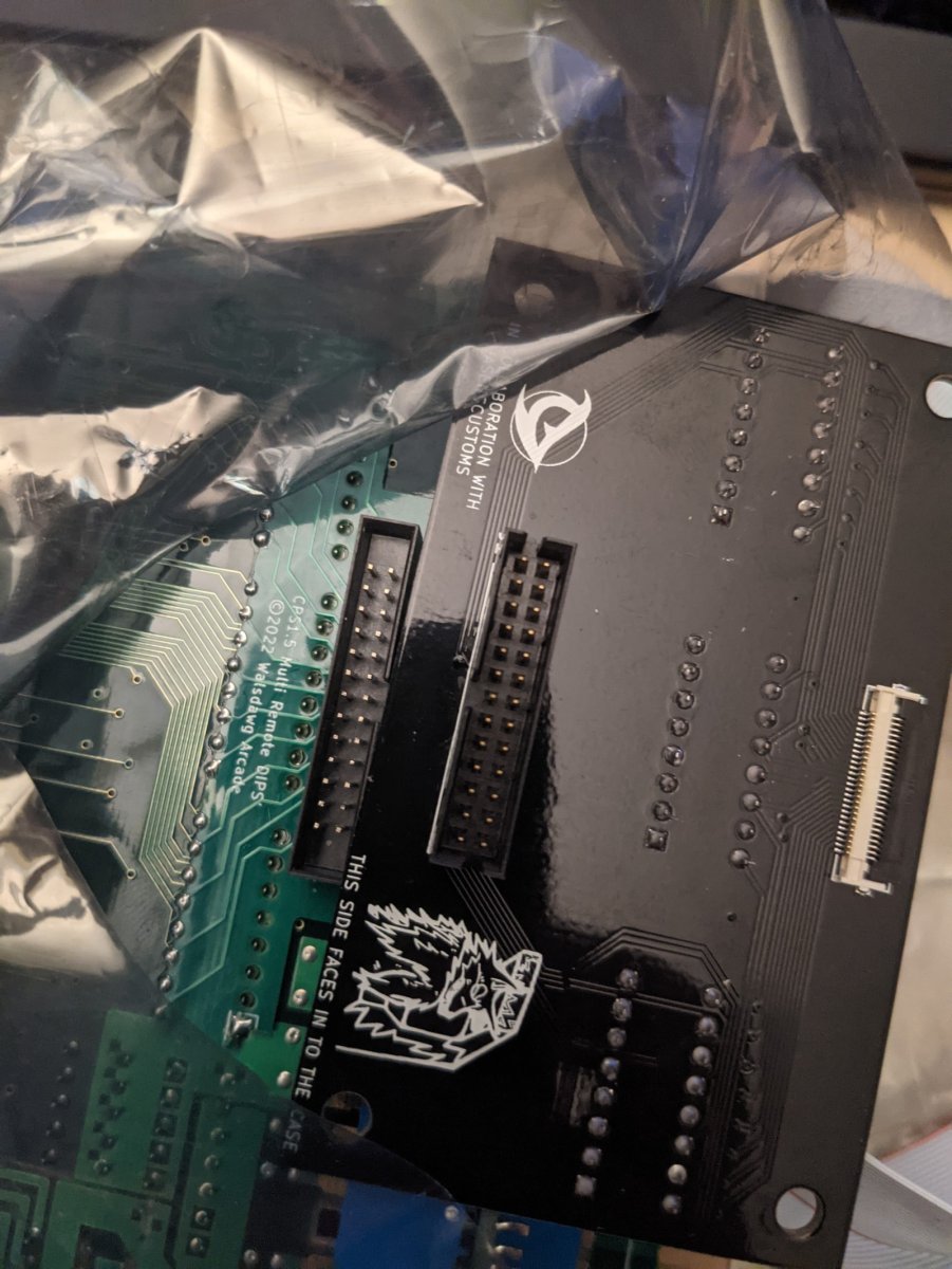

Got the case and love it, but am I missing something here?
The IDC cable that came with my DIP PCB does not fit the one that came with the case. Not sure if this is intentional and for a different product or what
Doesn't fit in what way?
Edit: Looks like the pitch is ok but the sockets I use are wider than the ones the factory installed. You can make it fit by snipping out the sides of the socket I bet.
Note how the sides of the header on the adapter PCB have extra clearance- the IDC cable fits exactly within that space. The case DIP PCB header lacks that clearance, and the IDC connector doesn't fit. Seems like it's made for a dupont style connector rather than IDC.
Yeah I think you can fix it by modifying the socket by cutting the sides off.
Yeah probably my fault since I used a footprint that was available for the pcb program I used. Guess that's what happens when a pro designer like Jassen trusts an amateur like me. :(
Weirdly I used smd sockets but for this adapter we switched to through hole. The through hole parts I ordered from a different seller fit my cables.
