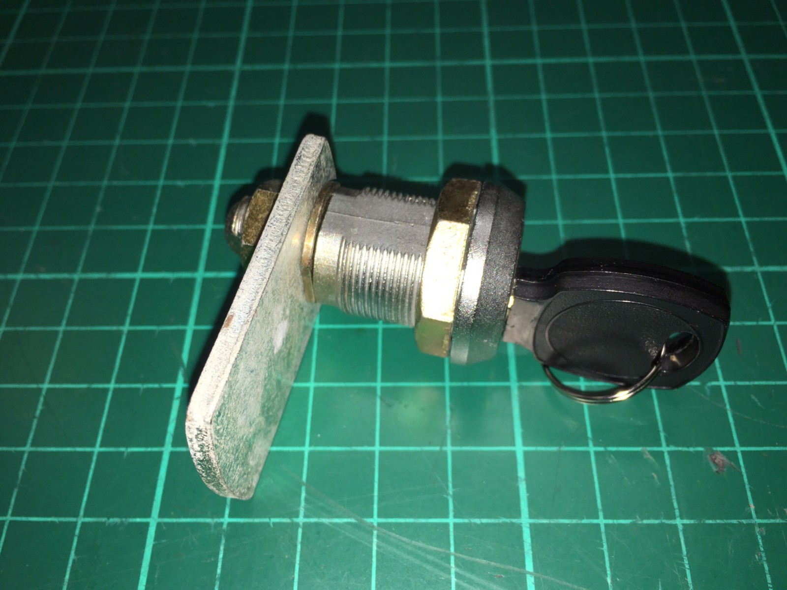

I also purchased most of all the locks I need.
I have 5x 5380 Sega locks on the way from Japan. It came with 1 key.
Those combined with the 2x CP tangs I already have, and the 2x bent style tangs that I think are for the main door and coin mech door?
So I think what I am missing is just 1 tang for the coin box door, which I think is the strait looking one seen here:
If anyone can confirm if that is indeed the one that I am missing, I will keep an eye out for it.

Looking good so far @Kavas. You might need 2 keys to get the control panel open... so account for that. I have extras of the straight tangs I can grab one for you next time I'm in SF. It has a sega part number engraved on them. I forget exactly what it is.
