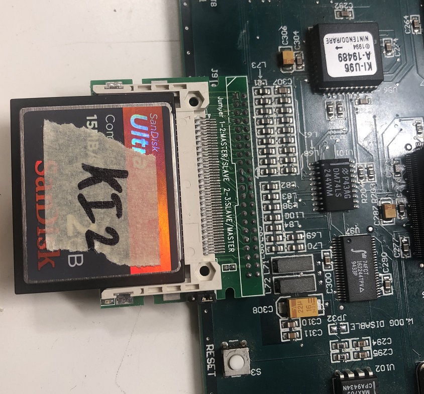

Are you sure they're dedicated KI PCBs and not KI2? From the pic you posted, it looks like your U96 has 20351 (KI2) instead of 19489 (KI).
This only works on dedicated KI PCBs, because the dedicated KI2 PCBs remapped several addresses (and running the wrong one does exactly what you're seeing, going into test mode and locking up). You should confirm that your test switch isn't thrown as well, since that would do the same thing ("DISK TEST SKIPPED"), except you'd be able to run the diagnostic tests.
Did you try burning the "Killer Instinct 2 (Conversion) U98 Any-IDE Boot ROM L1.4" ROM without my patch? That shouldn't work with the conversion PCBs either on that board though... yours should require the "Killer Instinct 2 (Dedicated) U98 Any-IDE Boot ROM L1.4".
BTW, I just re-tested, and it boots fine for me on my KI PCB.
Edit: I just looked more closely at the pic you posted - your "working" ROM says KI2 ANY-IDE DEDICATED BOOT ROM. So that's correct, this ROM won't work with your board, but you also don't need the conversion PCB (it'll work if you plug your drive directly into the PCB). Your board can only run KI2 though (there's no KI ROM to run on dedicated KI2 hardware).

Yeah I had those 2 miss labeled, the U96 are indeed different and work without the adapter. I have a few dedicated KI1 I will retry the patch shortly. Btw I have several non working board, to convert a KI2 to KI1, I think you only need to change the U96 and the roms right? Probably a good idea to do that so I can run both on all the pcbs I have. thanks
I haven't personally tried, but I believe U96 is the only difference (plus ROMs and HD of course).

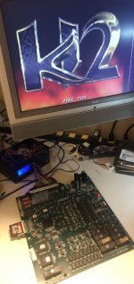

Nice, glad it worked out for you! Have you (or anyone) played all the way through KI2 using the hacked ROM yet? Just curious if anyone's confirmed that the hack is bug free... I've personally only played a few rounds.
