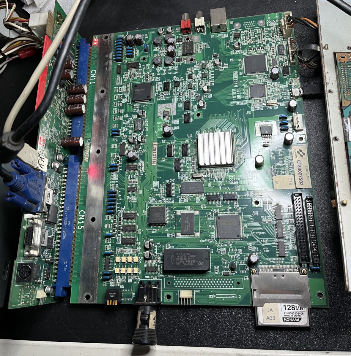

The Python board I used to make pictures had a problem with the sub board. I had it recapped to solve most of the issues. It also had some problems with corrosion on the main board which I also solved.
While it was still powering on it had almost no video output.

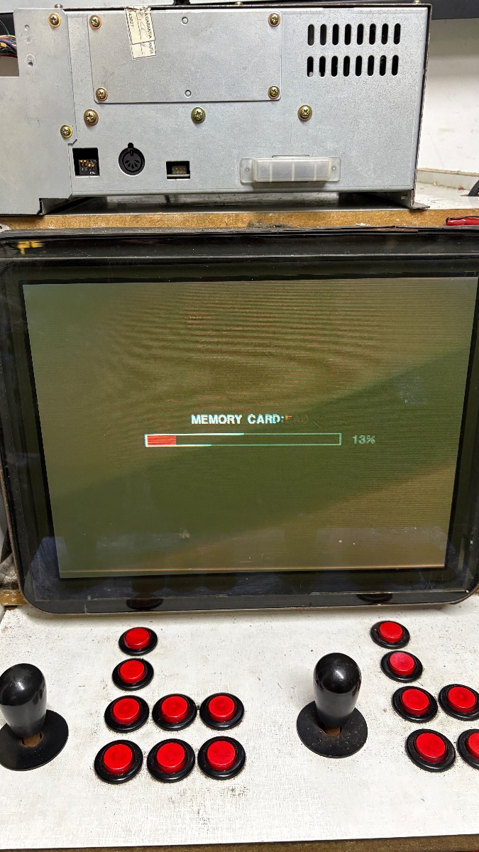

Got one PES but with memory card error, is it fixable ?

Well, there is a CF card w/ 128mb and a PS 2 Memory Card, maybe the PS2 memory card works like a dongle I really don't know. I've cleaned everything that I could but still the same....
The PS2 memory card is not a normal memory card. It's a COH-10020 boot "dongle" with the Konami Python boot loader. It's identical on all Python1 boards.
The CF card that contains the actual game data. The error message is regarding the CF card that might be corrupt or damaged.

Hi guys, recently got this game in an untested state, trying to make it work to add it to my collection but so far no success. Externally the case is heavily rusted, PS2 heatsink too, but PCBs are fine, had to disassemble it entirely to give it a good inspection, then clean and reassemble.
Upon power on, I was getting a blue screen complaining about "Dongle Card Does Not Exist or Is Not Right", but it was the ribbon cable.

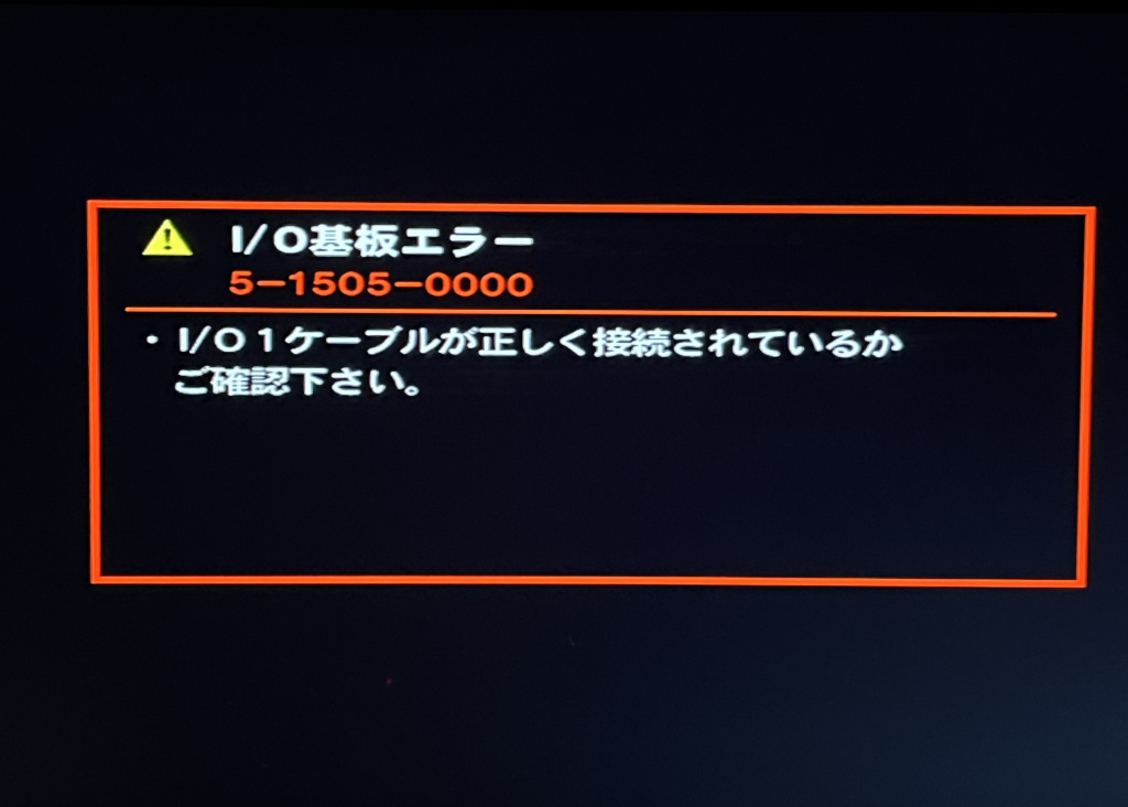

So it begins boot, gets to a loading screen, then I get this:
What is I/O 1 supposed to be, the JVS port? I tried with a sega 837-13551-92 (the one from naomi universal), and a 838-13683-93 (the sega one with JAMMA port) and nothing changed.
Also tried changing the dip sw, tried JS option and error is the same. I'm powering the board from the square power connectors, not the JAMMA edge since it came with a red tape. Then also tried removing the round security dongle and nothing changed, probably it is not checked at this stage.

That "dongle card" is the SONY black memory card, that is where the Python1 reads the boot program from. The blue screen is the PS2 BIOS telling you it was not able to load the boot... You solved that already so no problem there.
There is a option on the Python1 to use JVS or JAMMA,, you set the JVS IO mode using one of the four dipswitches somewhere at the board. Once set to JVS it will require that you connect a JVS IO board to the JVS connector (it looks like a usb port but isn't a usb port so be careful to not plug USB things there or they will be damaged)
